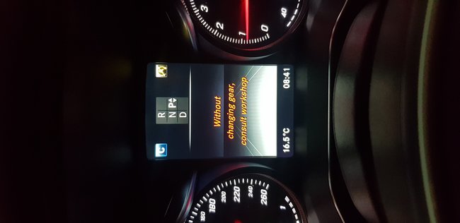

In a morning, when I started a car, I received an error on a dash: without changing gear consult workshop.
As the car is still under warranty, so I took it to the dealer (on evacuator as car were not able to move it was retuning in P mode when you try to switch gears) to investigate whats and issue.

This exact same thing happened to me this morning!!! Roadside assist says it’s most likely a transmission problem - cannot determine if its the computer software or the transmission itself.
