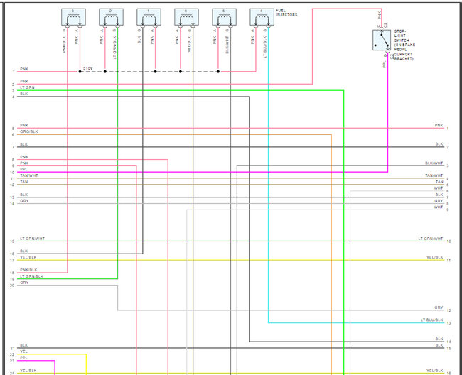

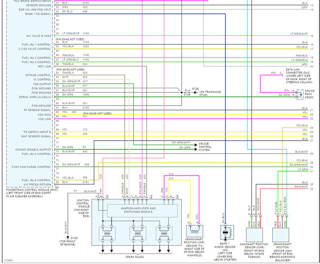

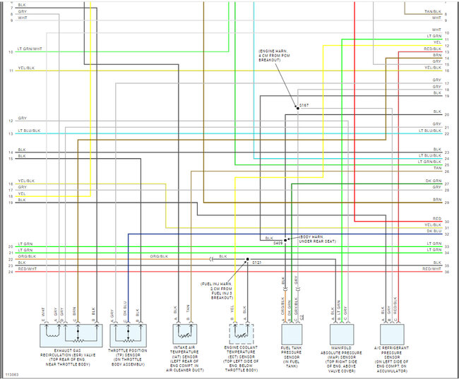

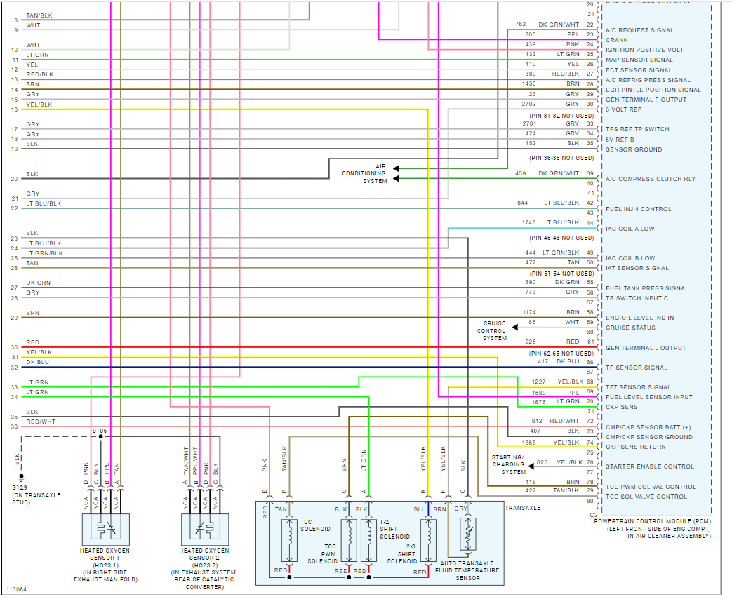

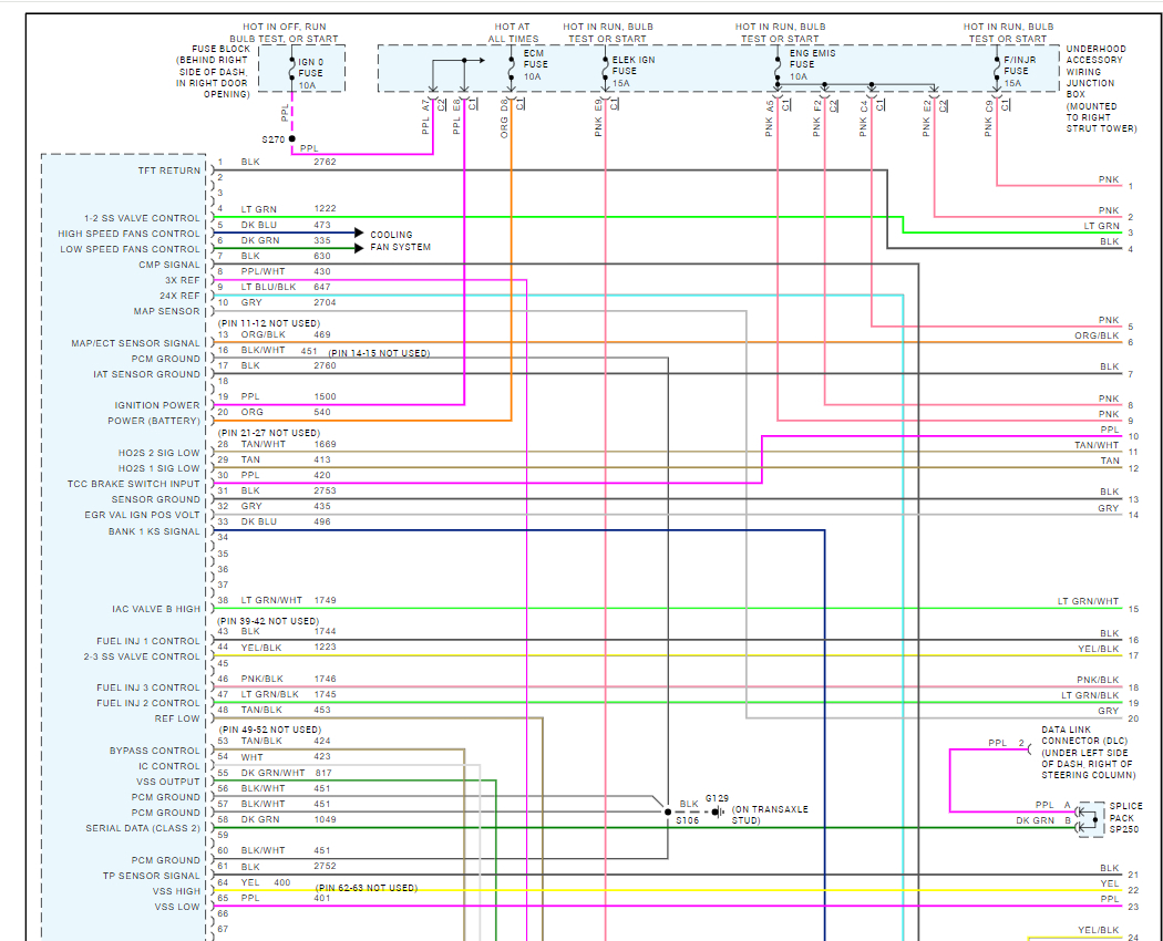

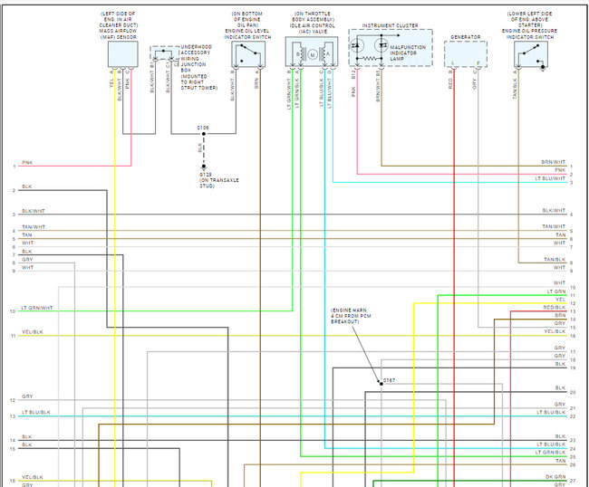

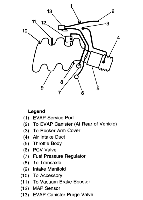

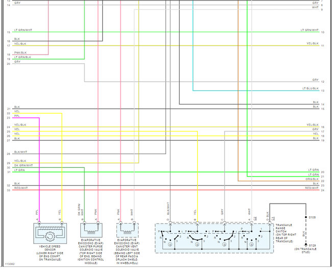

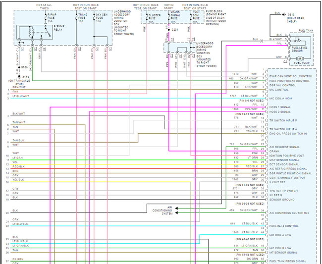

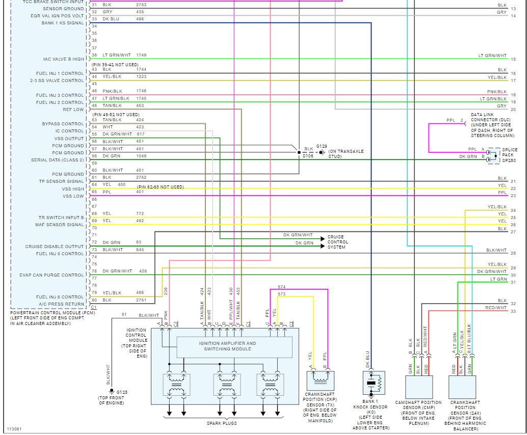

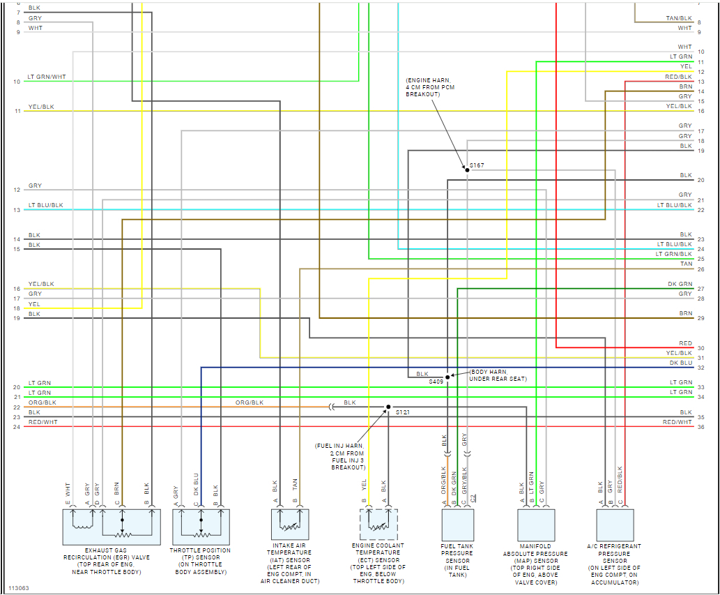

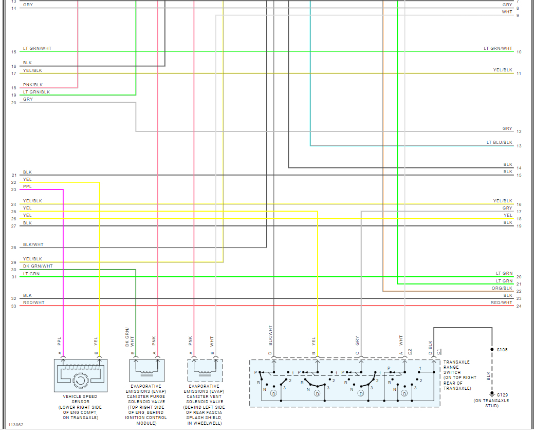

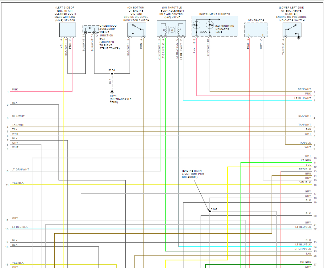

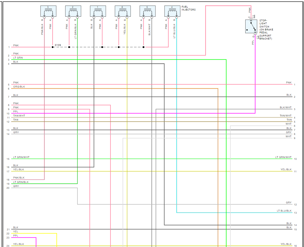

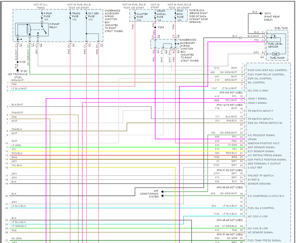

lol you are okay :) To me it sounds like the purge control valve is not working or you have a hole in the EVAP system somewhere.
The purge valve is top rear of the engine, behind the ignition control module, is that the valve they changed? The EVAP valves are controlled by the PCM so here is the engine and EVAP system wiring diagrams so you can see how the system works and which wires to test. Also, I have included this guide which can help you with the testing:
This guide can help as well:
https://www.2carpros.com/articles/evap-system-code-repair
