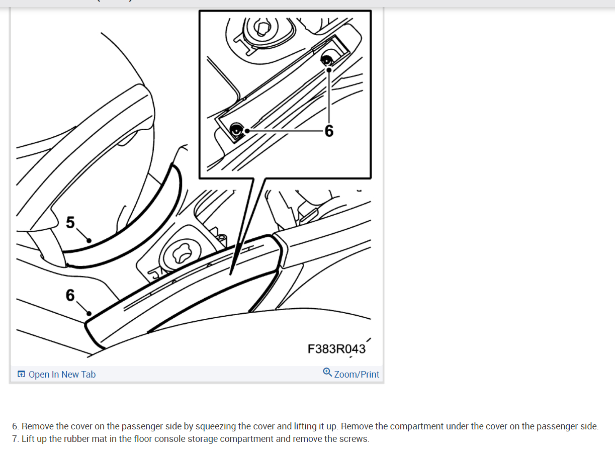

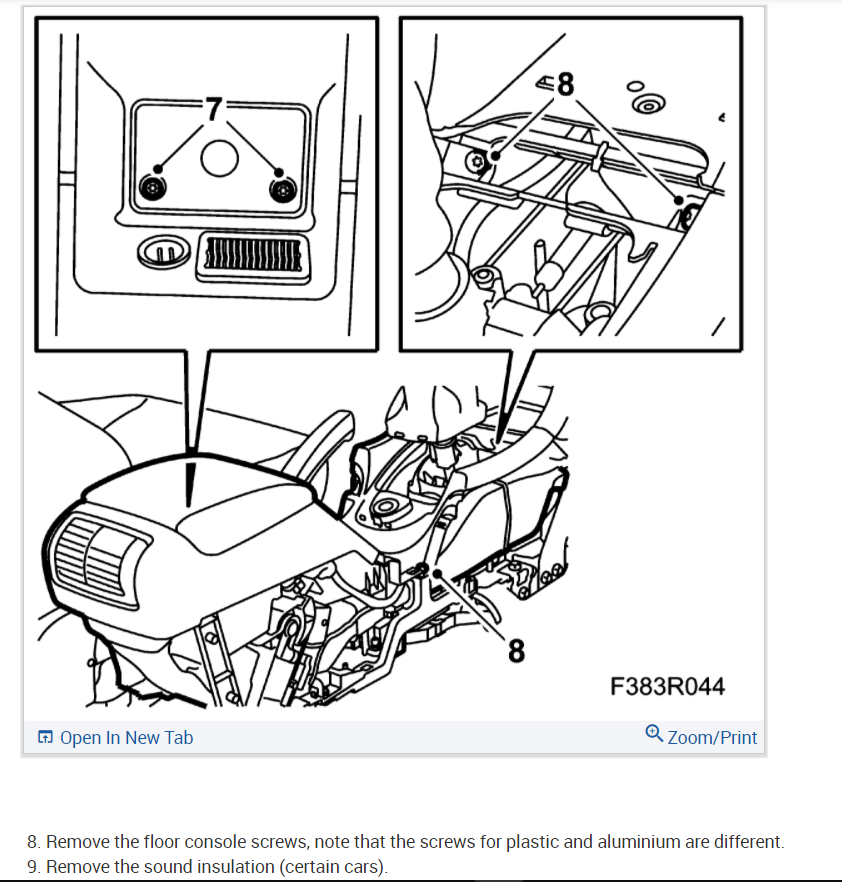

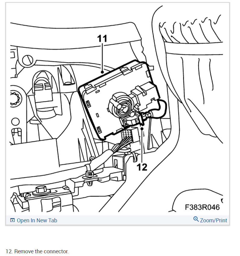

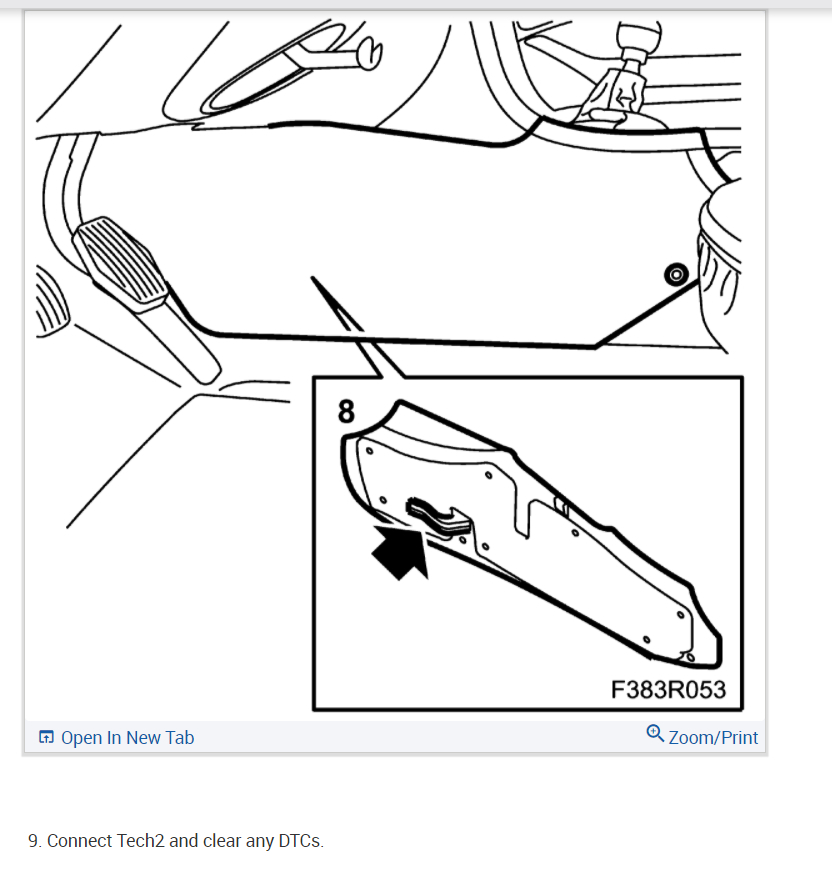

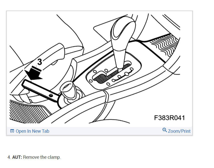

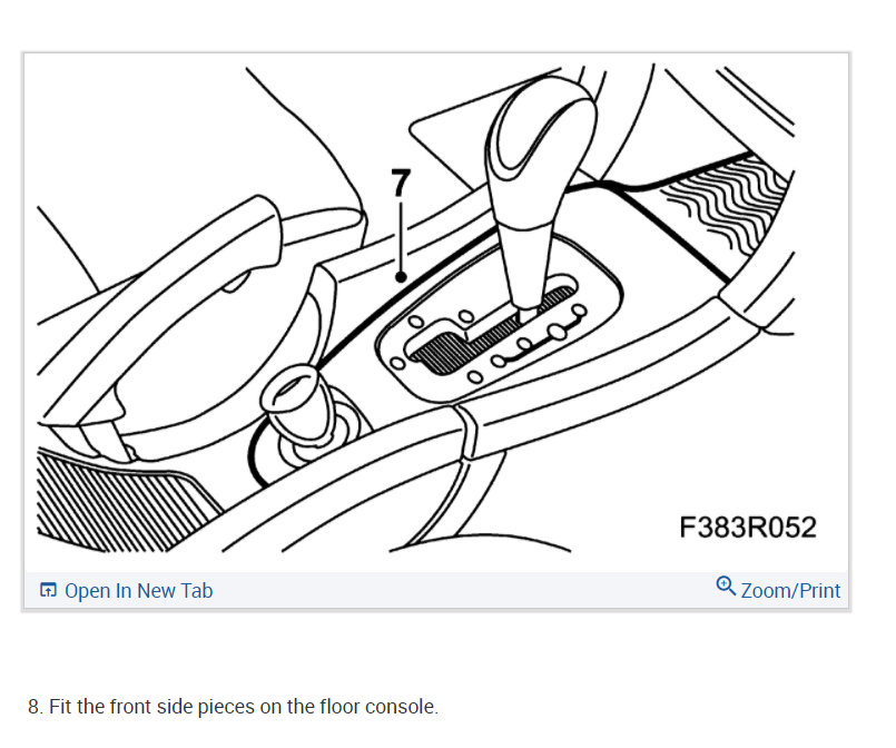

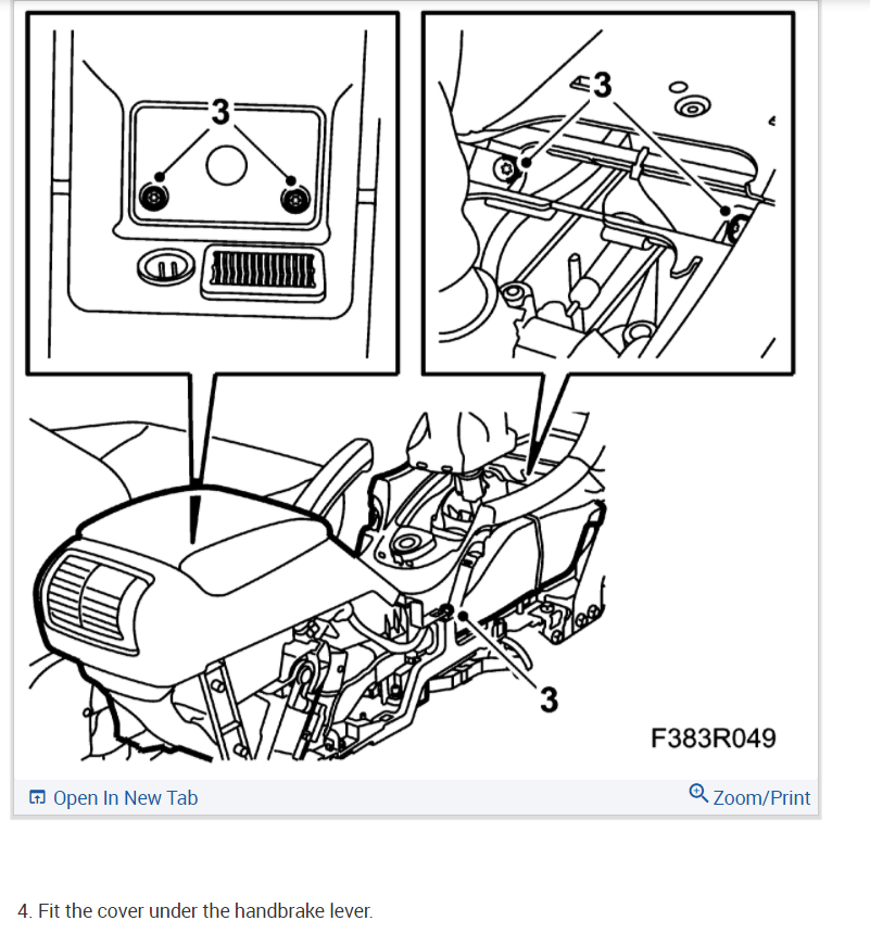

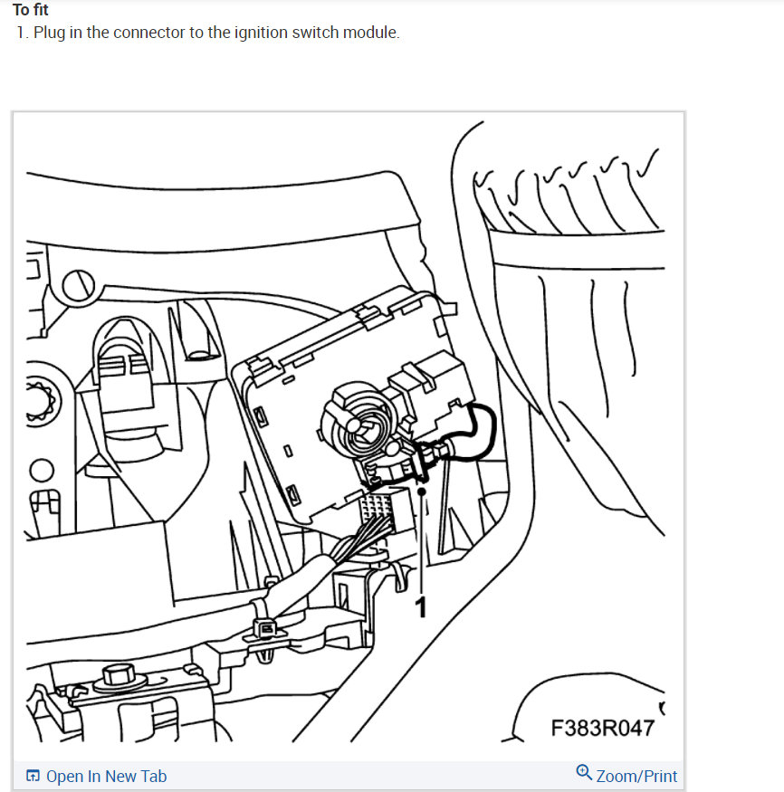

My ISM and steering module id getting error messages key wont turn. how do you bypass the starter relay to the battery to start it?
Mar 19, 2021 at 12:18 PM

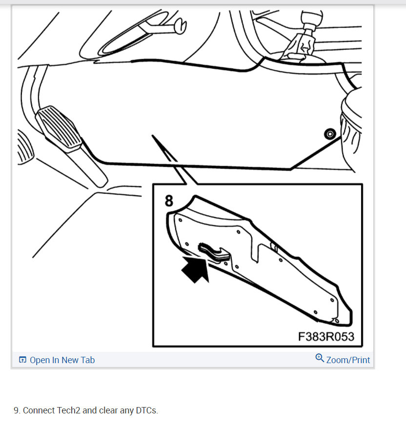

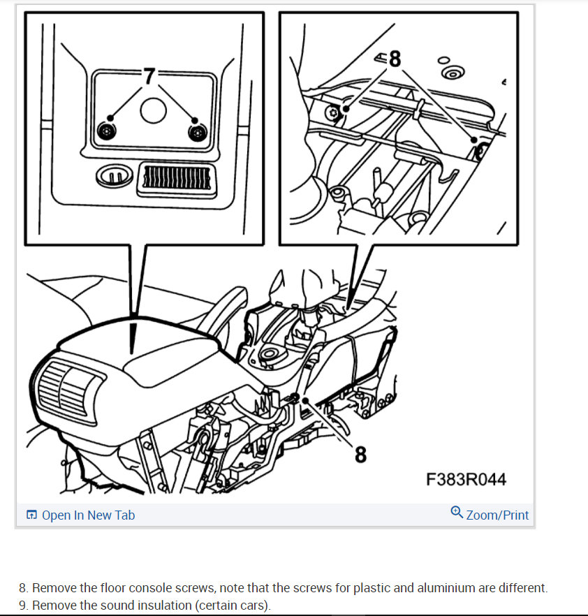

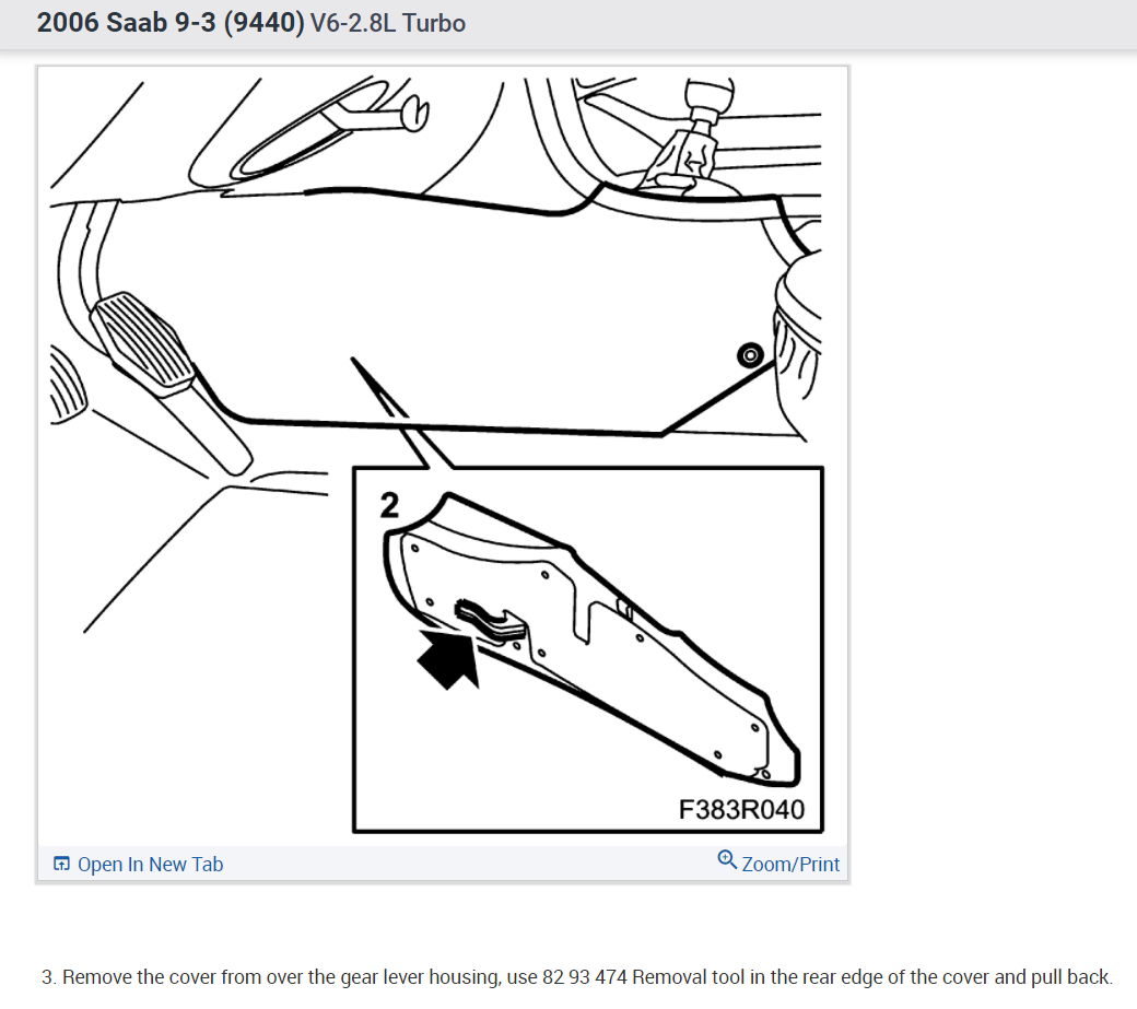

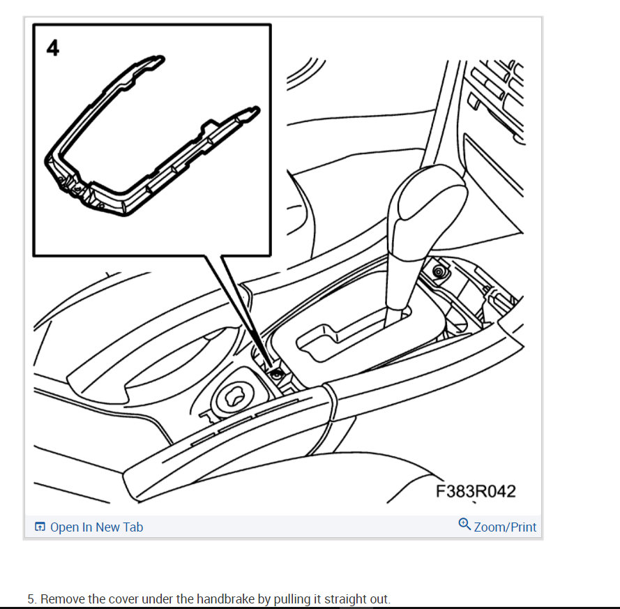

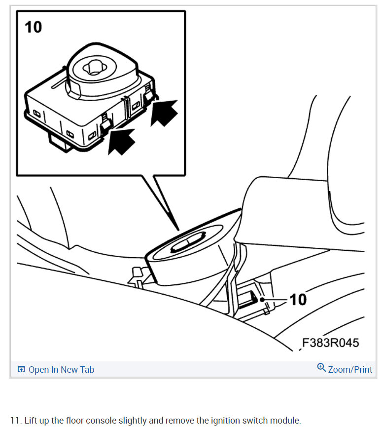

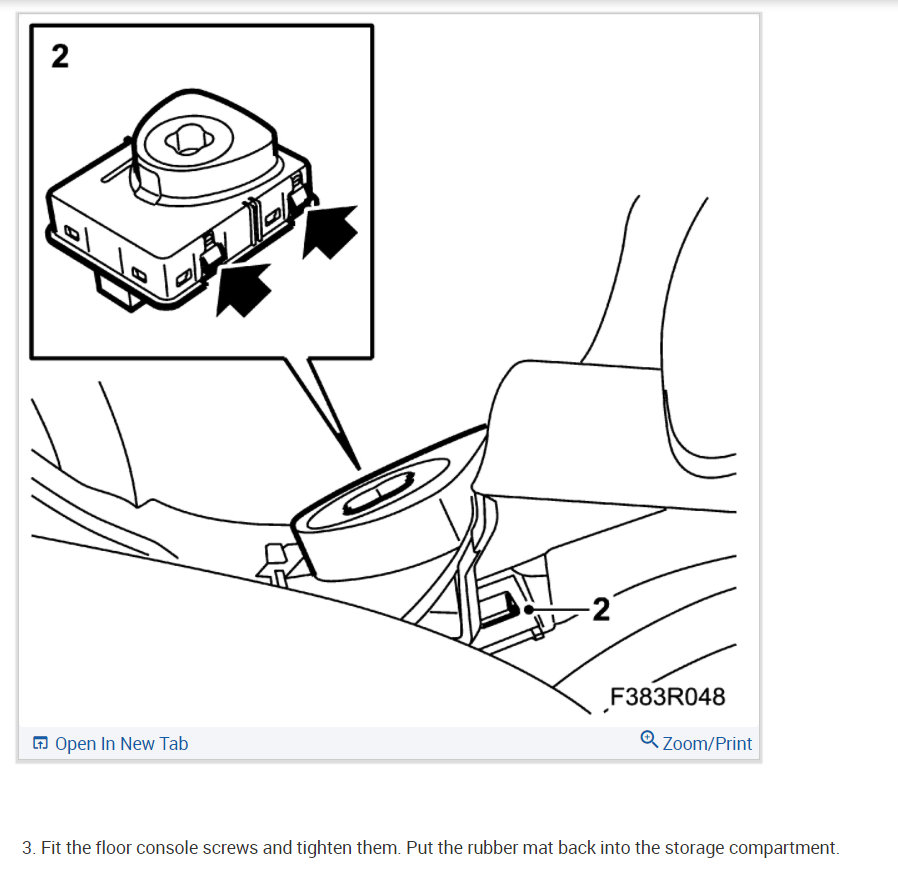

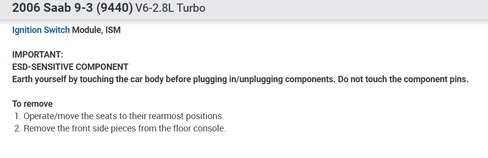

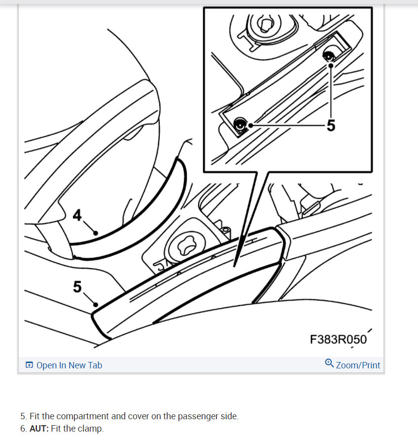

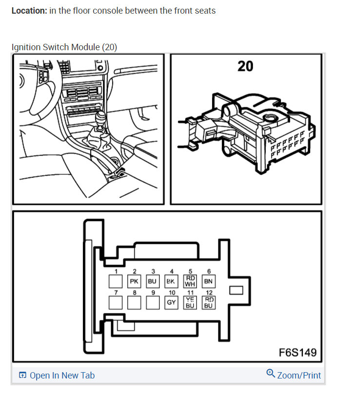

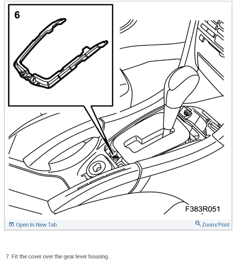

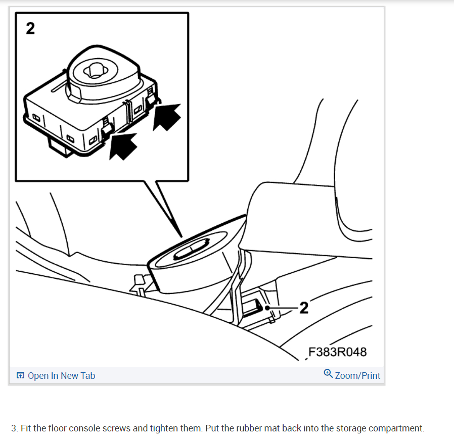

It would be difficult to bypass. lets just fix it. you will need to get the part from the dealer. here are the instruction to replace the ISM in the diagrams below. Check out the diagrams (below). Please let us know if you need anything else to get the problem fixed.
