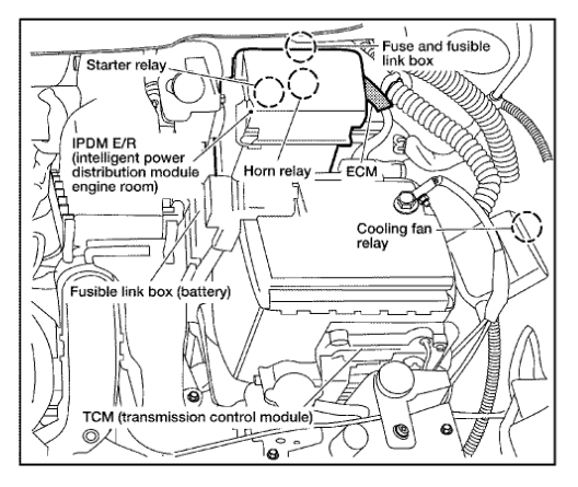

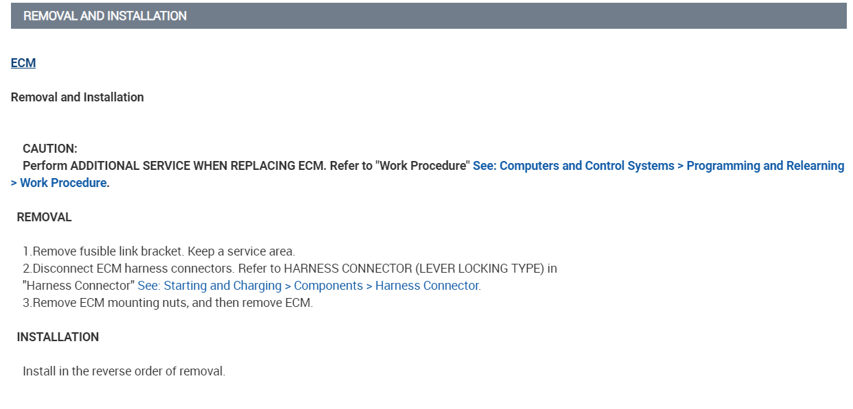

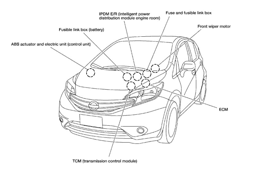

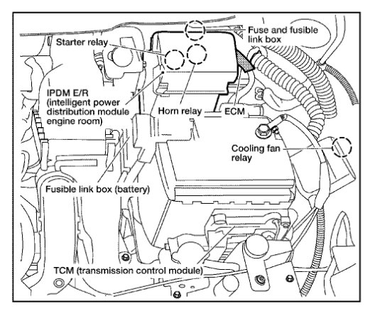

It sounds like you may have had a voltage surge which took out the PCM which happens, you can get a preprogrammed unit by searching Google or Ebay.
Here is how to change the PCM out in case you need it. Also, I have seen the IPDM cause this issue as well, but to confirm the issue with the IPDM you will need to use a CAN scanner, you can get a CAN scanner (Controller Area Network) which will work on most cars from Amazon.
Here is a video to show you how:
https://youtu.be/u-4syLc-ifQ
Check out the images (below). Let us know what happens and please upload pictures or videos of the problem so we can see what's going on.
