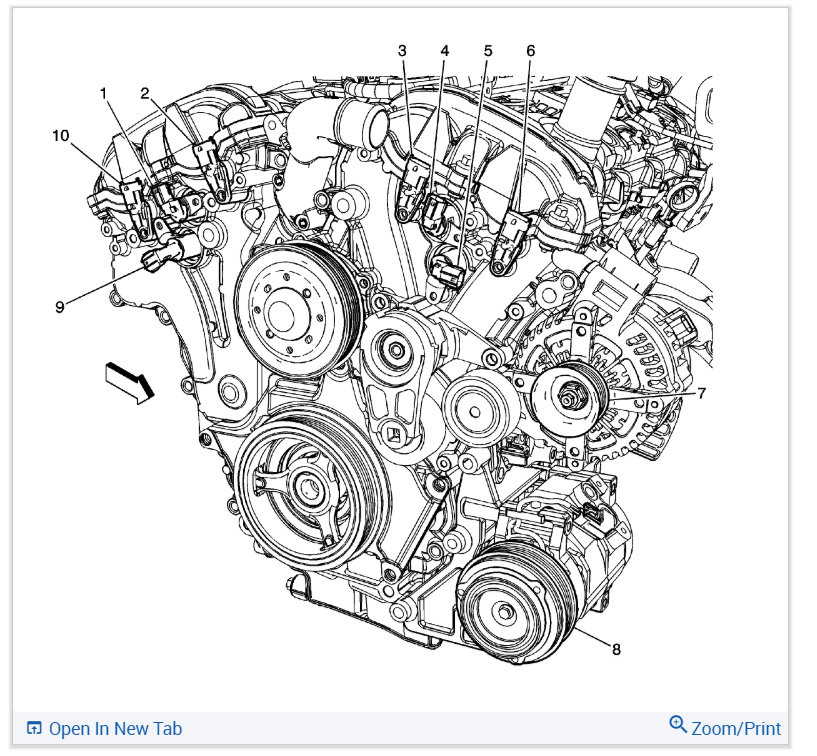

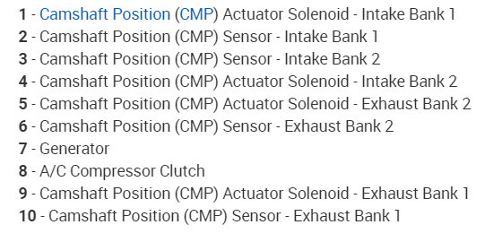

Yes I would start at the camshaft sensor here is a guide to walk you through the step and a diagram below to show you the location.
https://www.2carpros.com/articles/camshaft-angle-sensor-replacement
When trouble code P0014 is set, it means that camshaft position “B” in Bank 1 is more advanced than the ECM has told it to be.
Also is the engine full and clean this can affect the camshaft actuators which will cause these problems. Check out the diagrams (Below). Please let us know what happens.
