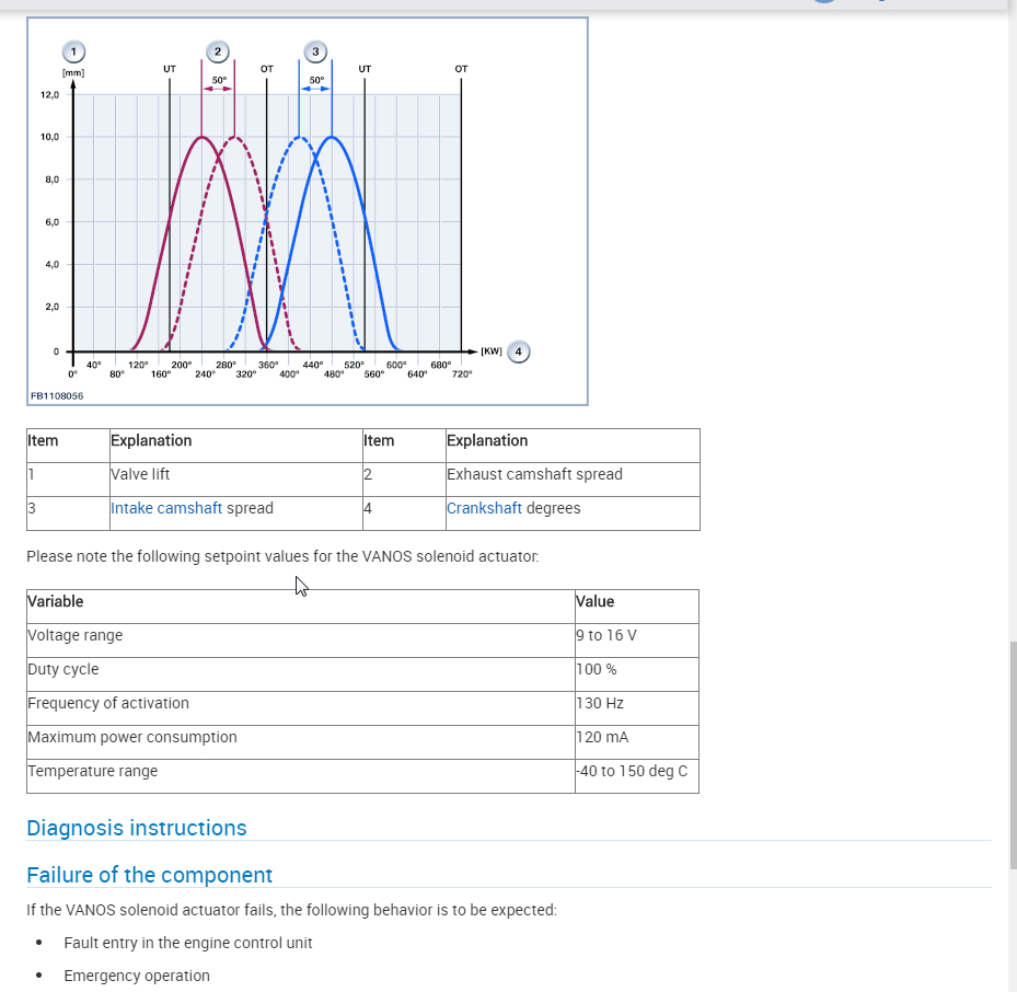

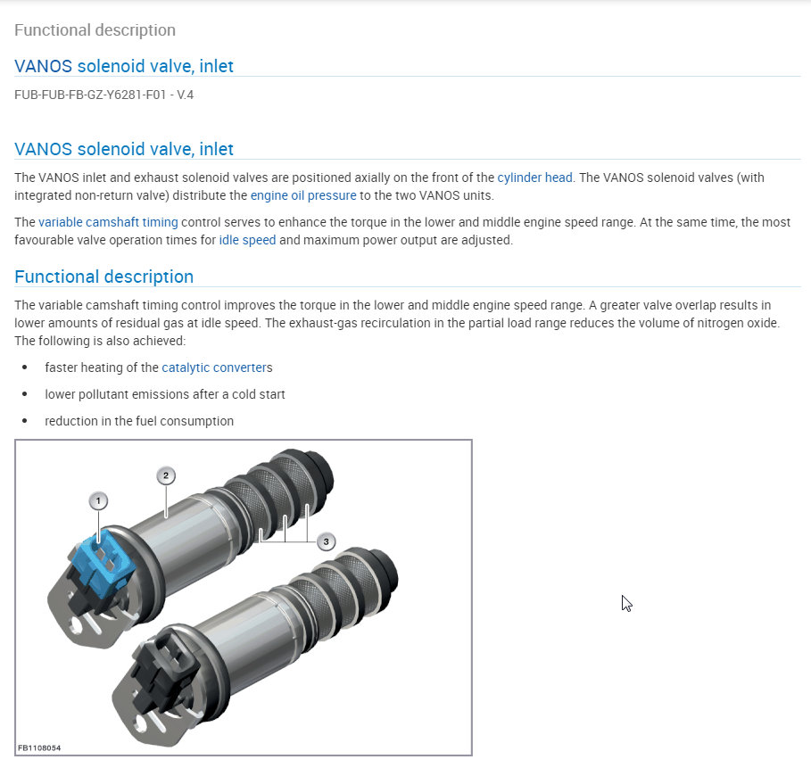

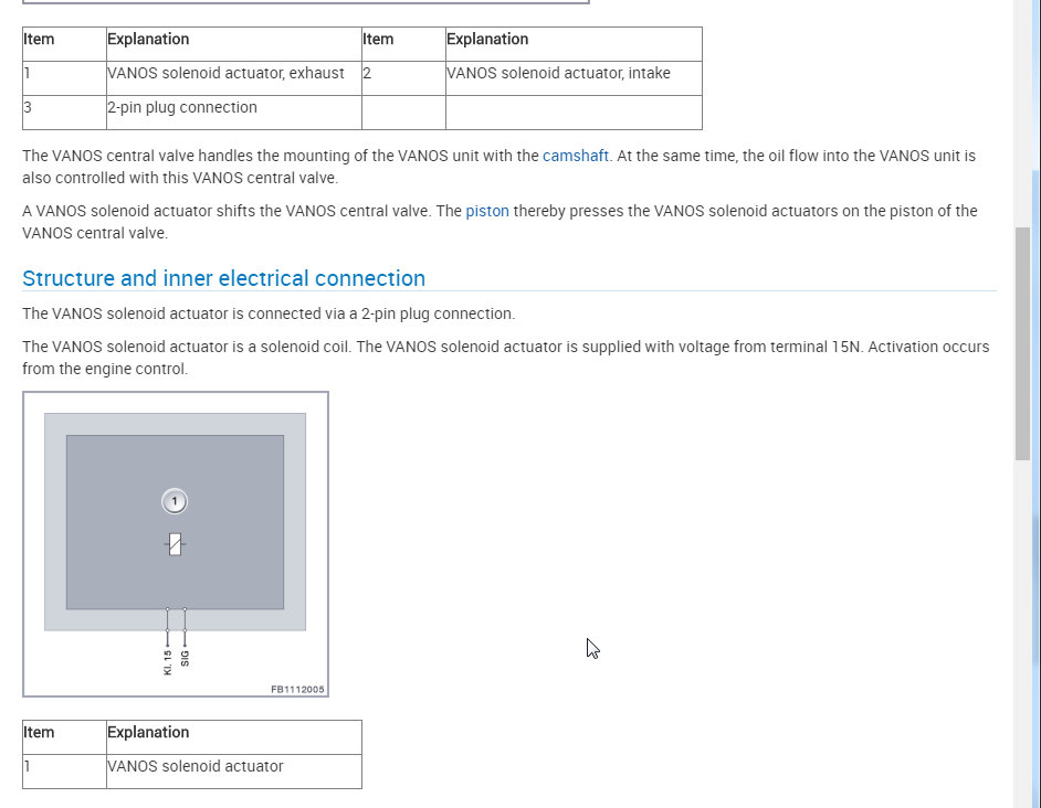

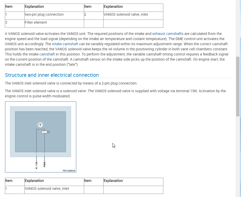

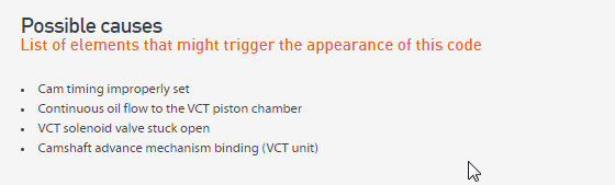

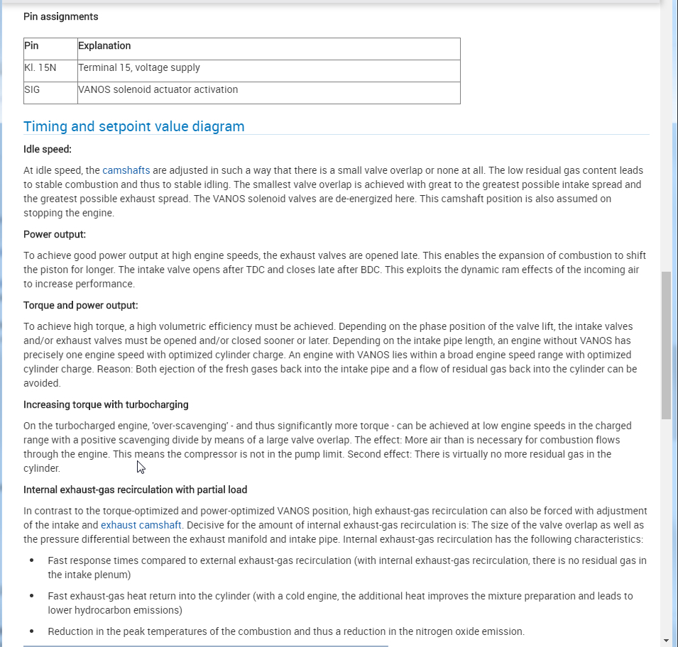

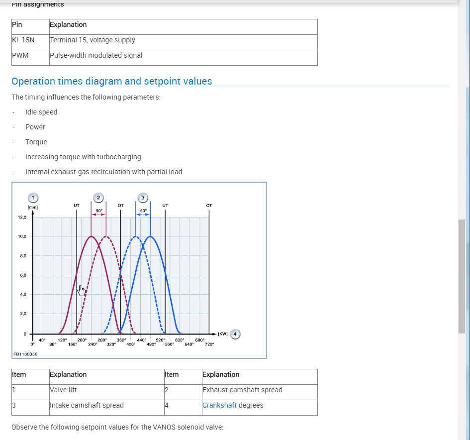

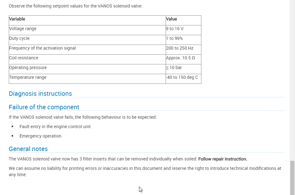

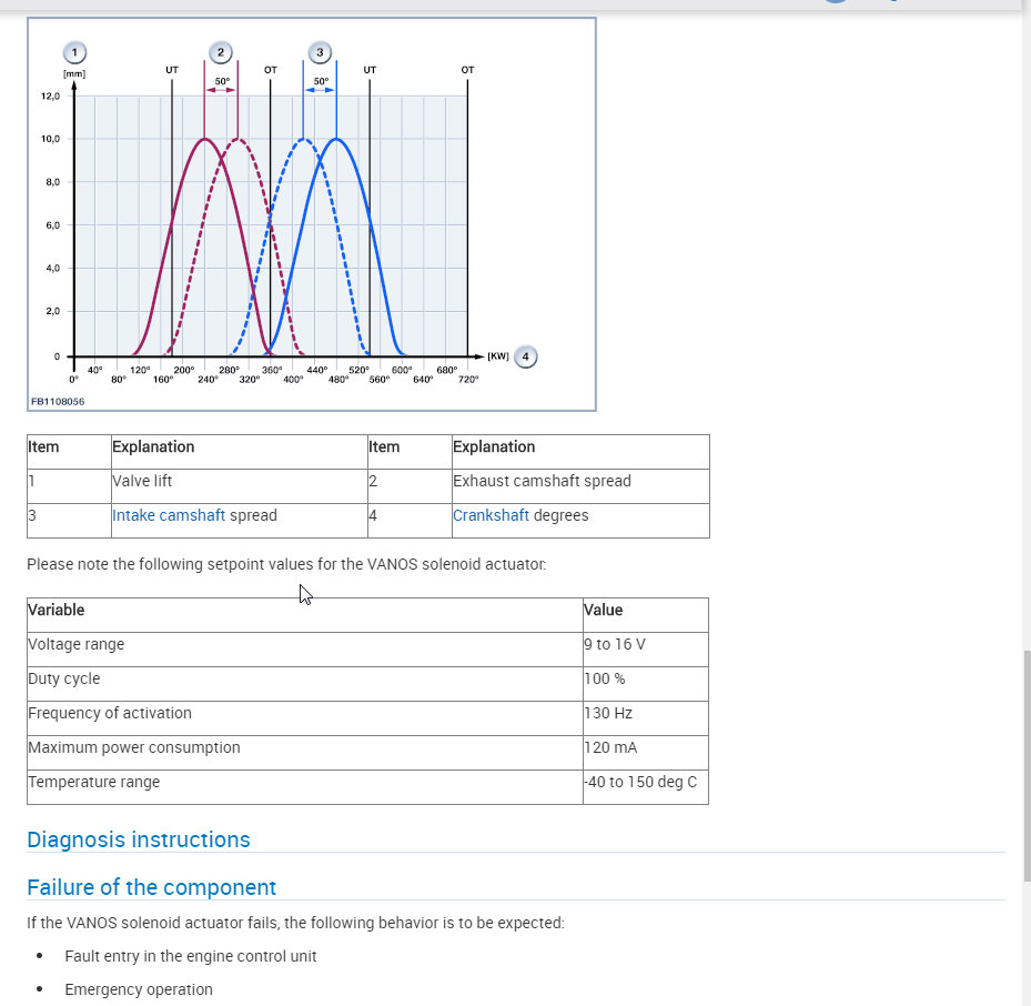

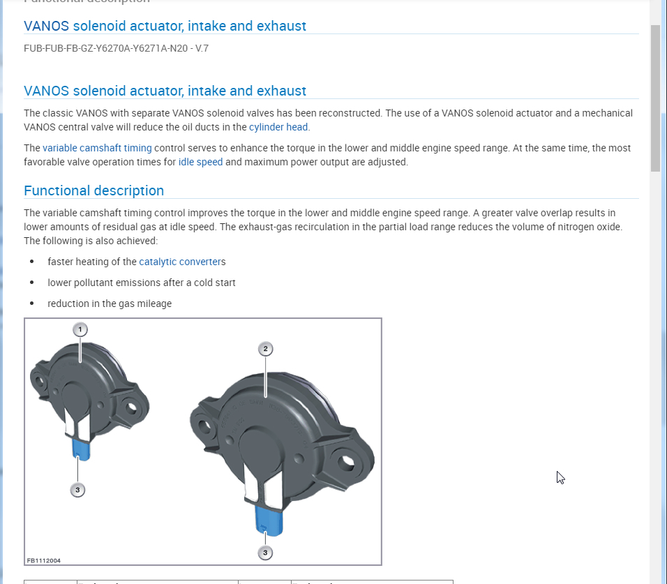

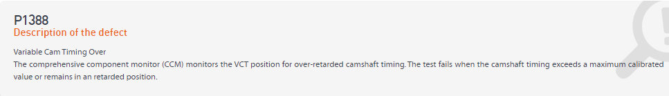

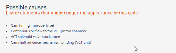

I was driving and the car came up with drive-train fault all of a sudden the engine shut off. it would turn over but not fire. I had it towed home and a friend has a code reader it came up with just one code P1388. Looked it up and it said camshaft retarded. I was told it's the camshaft sensor is this correct? Hope so as i have ordered a new one.
