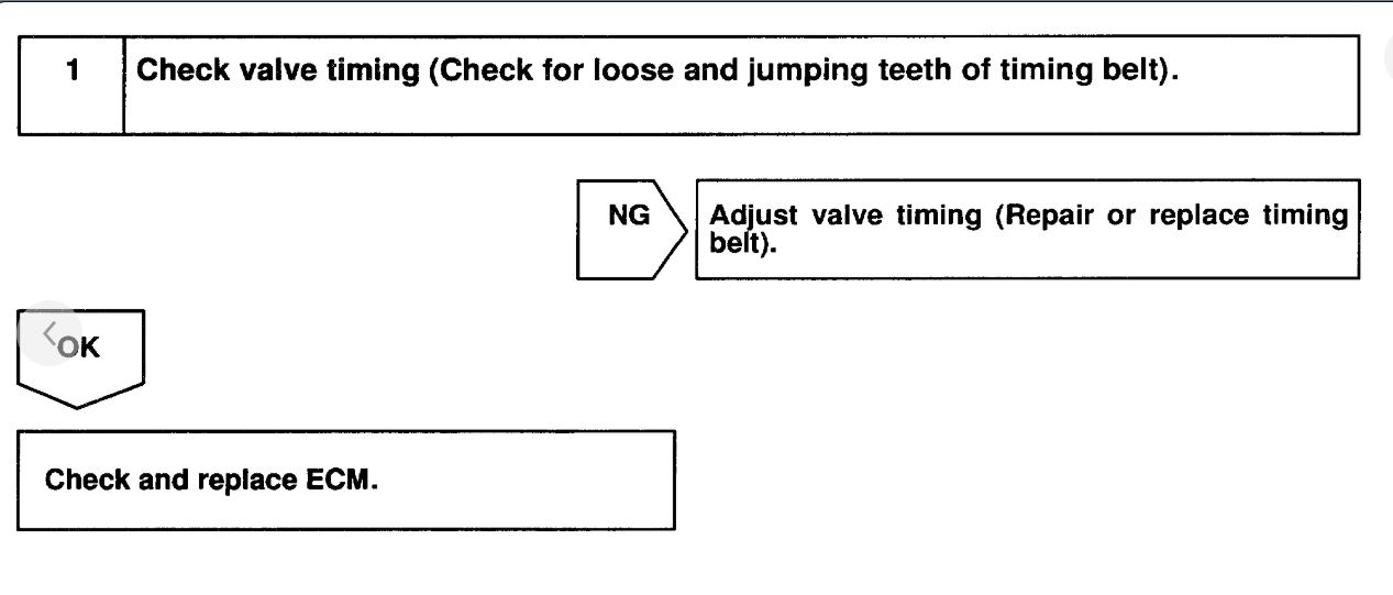

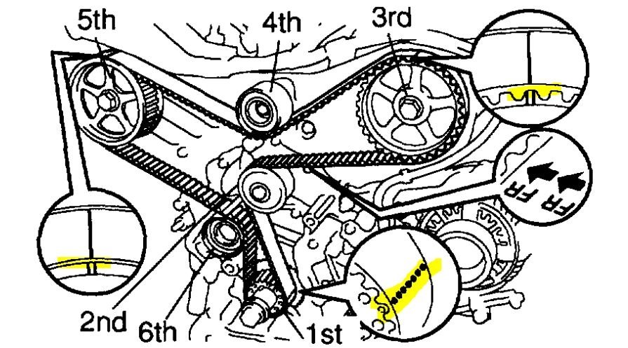

Is it the same code that returned? If it is, we know the code indicates a variation in VVT timing between the crankshaft and camshaft VVT sensor bank 1. I honestly suspect it is a mechanical issue such as a stretched timing belt. It is either a timing issue (stretched belt or off a tooth) or the ECM is bad.

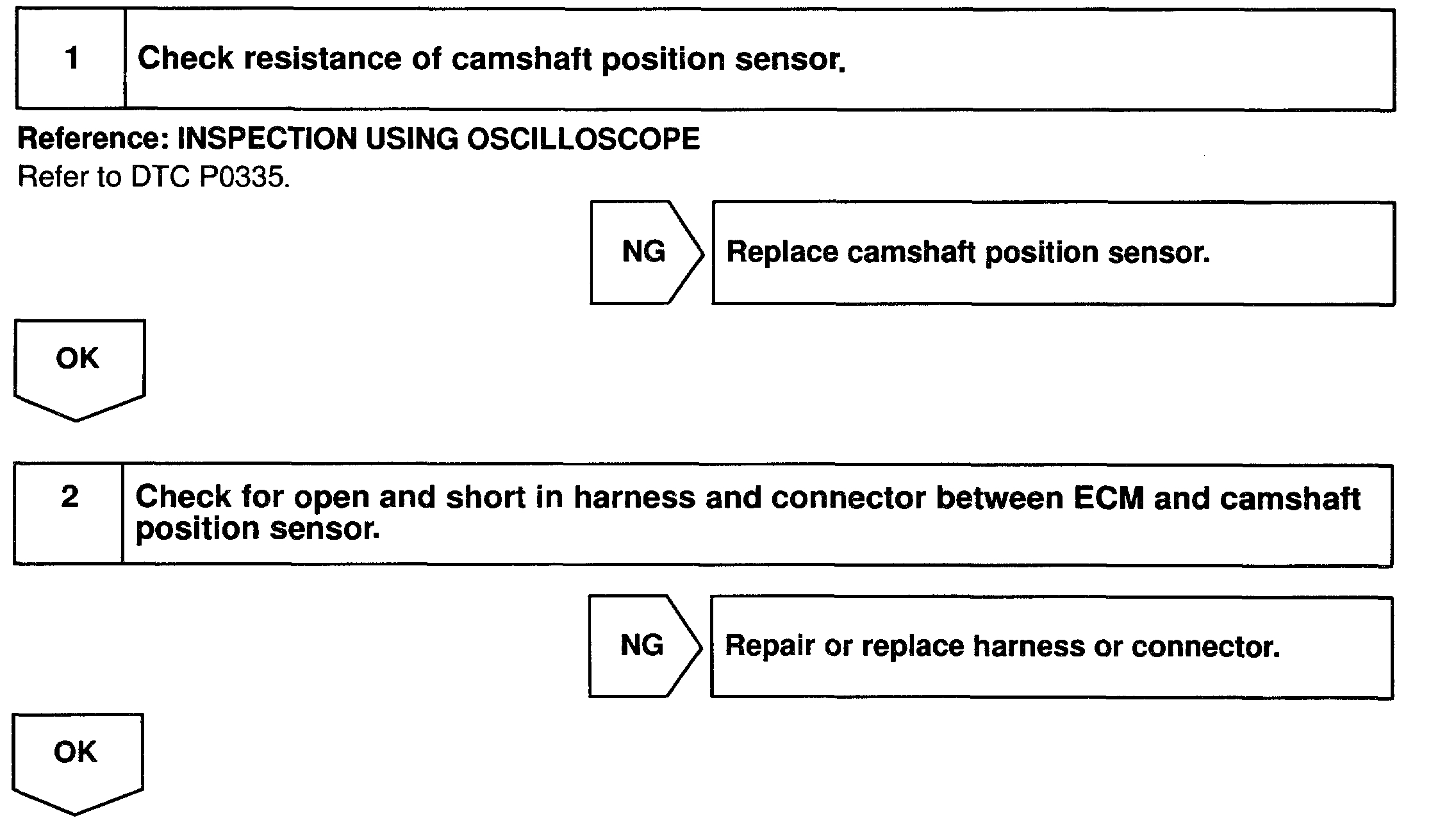

If you look at pic 1, it shows the flow chart for troubleshooting the problem.
In my mind, there is more than this. It could be an oil pressure issue not allowing the VVT actuator to function properly, a dirty or partially plugged timing oil control valve (one for each bank) or even dirty motor oil.
Before I suggest replacing the ECM or taking everything apart to check timing, I have one last suggestion. I would like you to check the timing oil control valves.

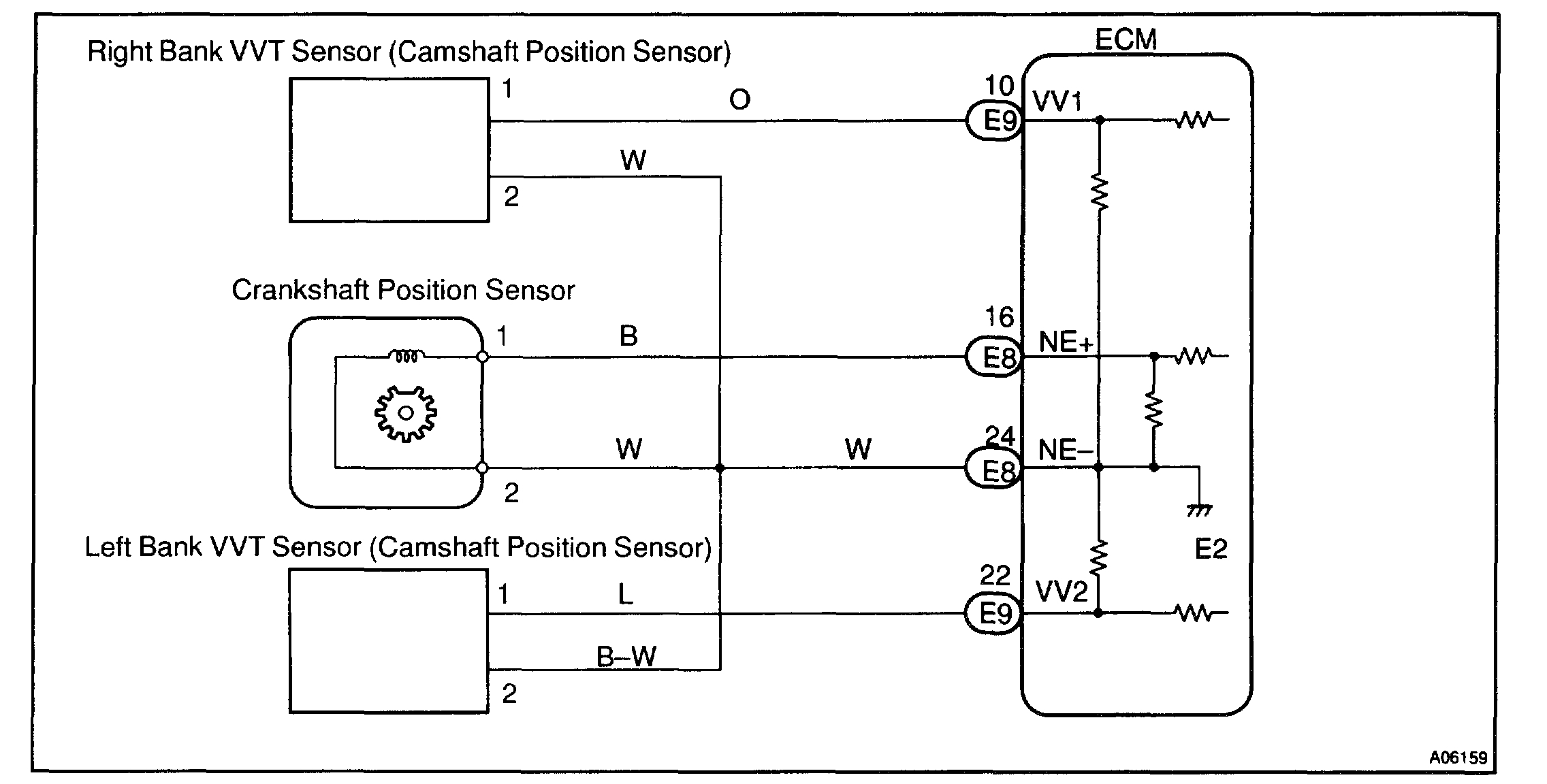

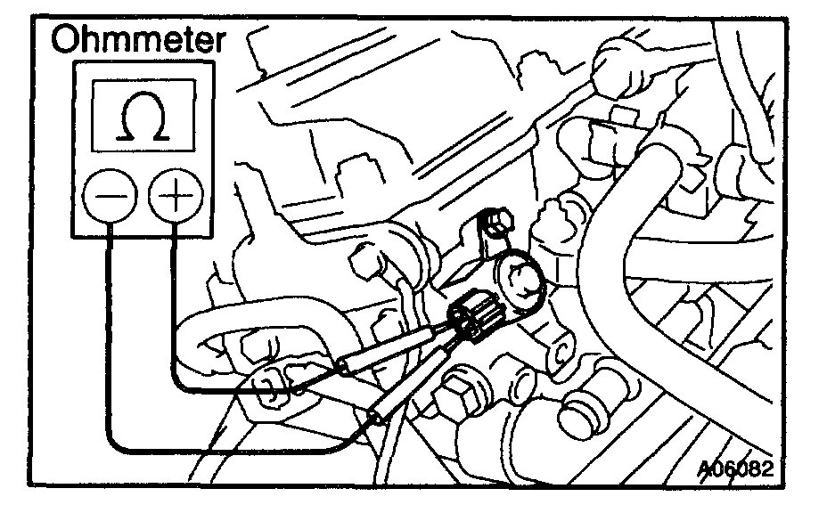

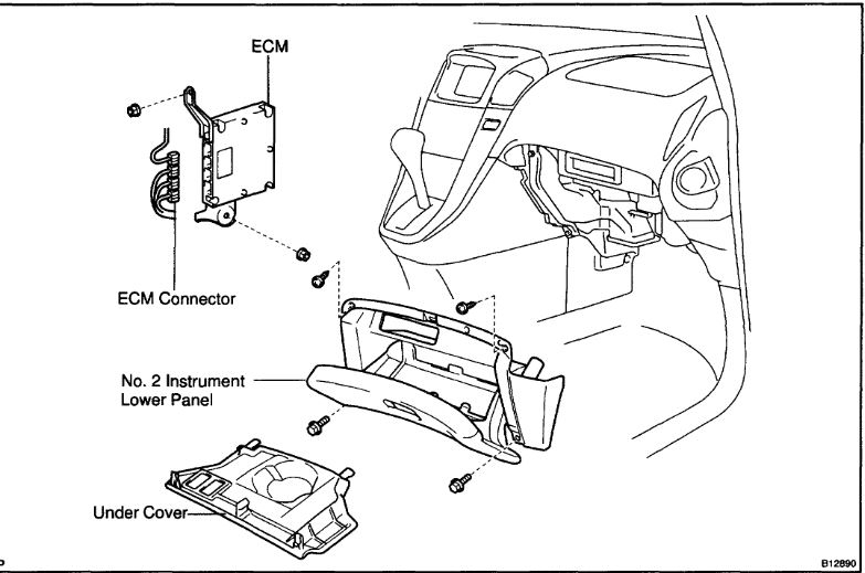

Here are the directions for testing them. Picture 2 correlates with these directions. All you are doing is checking resistance in the sensor itself.
__________________________________________
2001 Lexus Truck RX 300 AWD V6-3.0L (1MZ-FE)
On-Vehicle Inspection
Vehicle Powertrain Management Computers and Control Systems Variable Valve Timing Actuator Testing and Inspection Component Tests and General Diagnostics Camshaft Oil Control Valve On-Vehicle Inspection
ON-VEHICLE INSPECTION
pic 2
INSPECT OIL CONTROL VALVE RESISTANCE
a. Remove the V-bank cover.
b. Remove the intake air connector.
c. Disconnect the oil control valve connector.
d. Using an Ohmmeter, measure the resistance between the terminals.
Resistance: 6.9 - 7.9 ohms at 20 °C (68 °F)
If the resistance is not as specified, replace the valve.
e. Reconnect the oil control valve connector.
f. Reinstall the intake air connector.
g. Reinstall the V-bank cover.
________________________________________________
If you find the specs within the manufacturer's specs, we will then need to check the timing.
Let me know what you find. Also, sorry for all the different tests. However, I don't want to make a suggestion, be wrong, and do nothing but waste your money.
