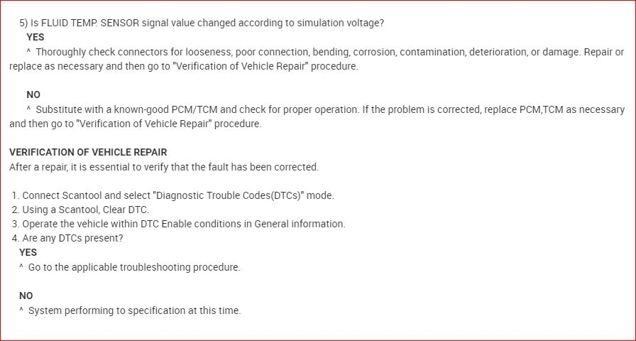

Hi Steven,

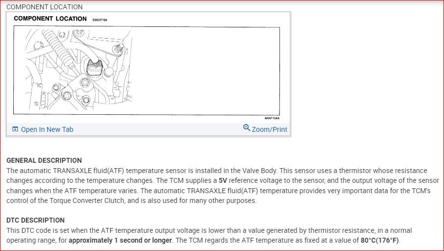

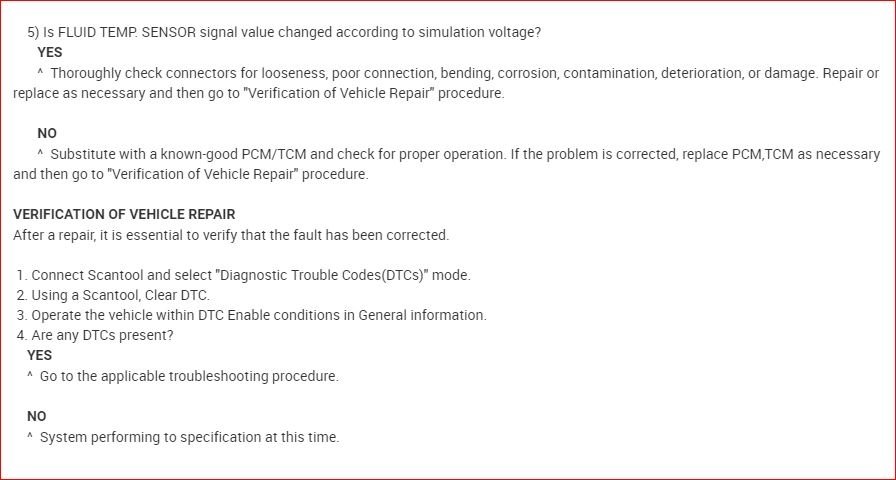

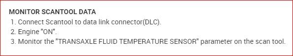

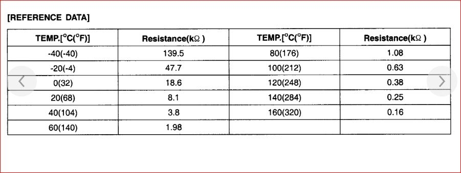

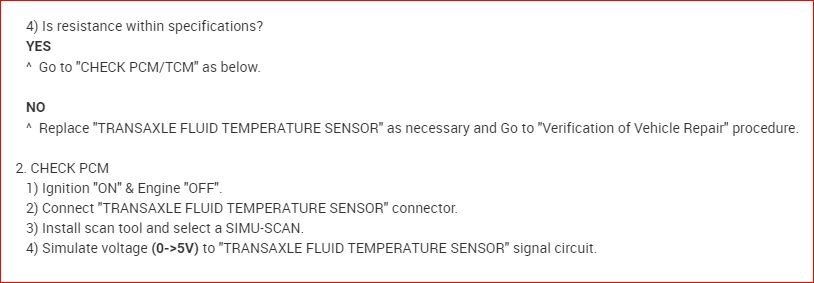

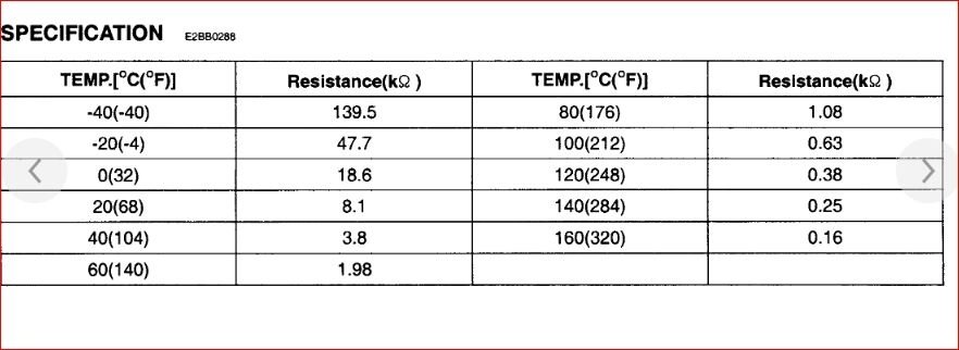

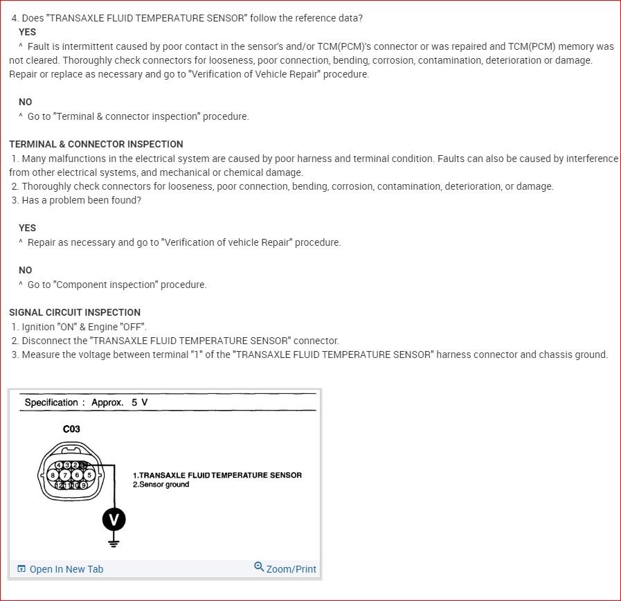

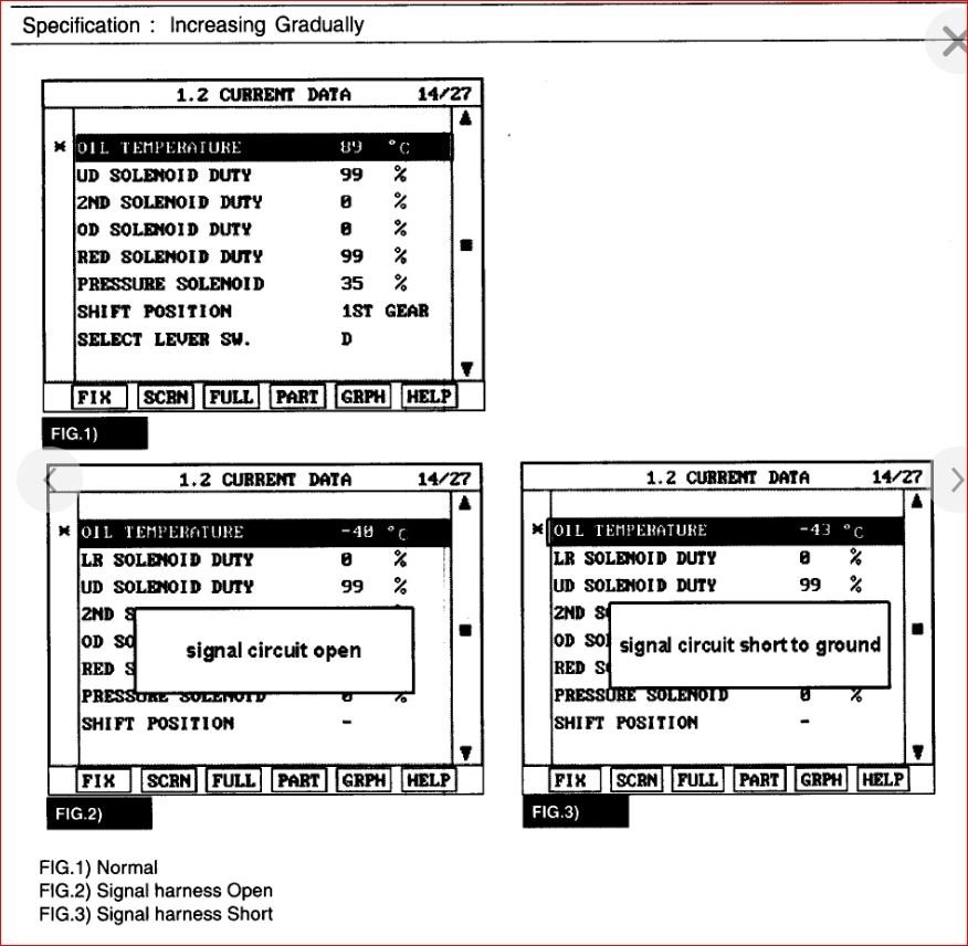

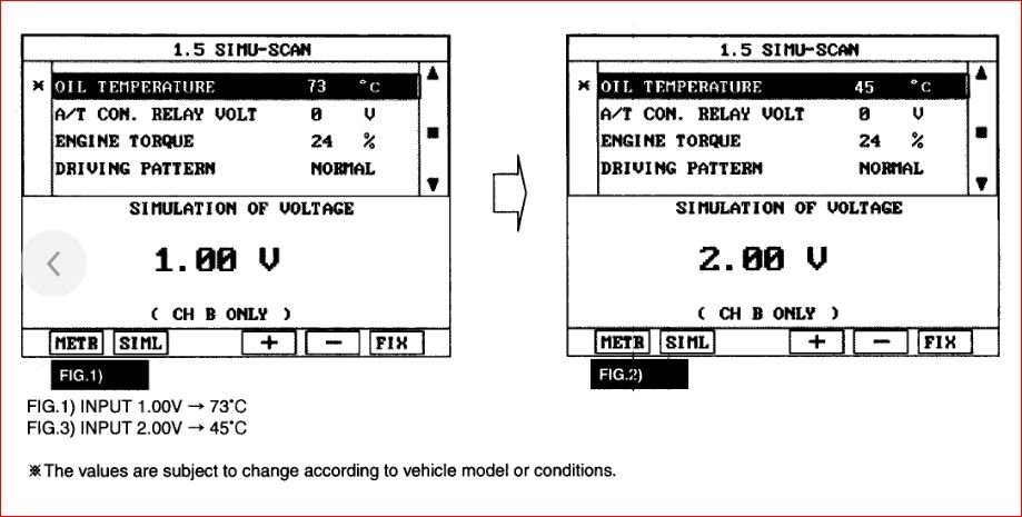

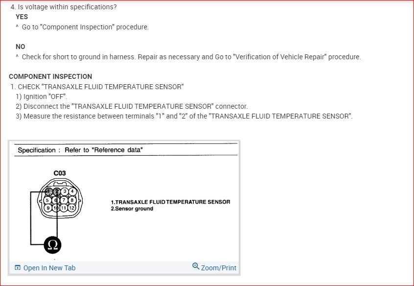

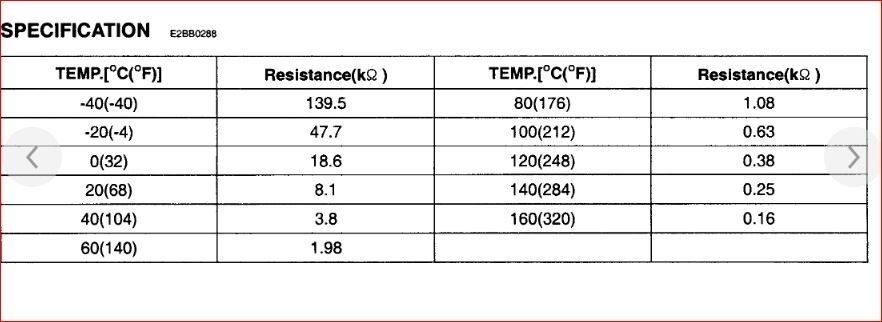

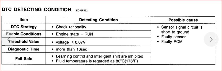

The poor condition of the fluid does not appear to cause your P0711 DTC. This is a circuit code for the temp sensor. I suspect you have a failed sensor but I included the test to properly diagnose it.
As for the MAF sensor DTC, that is not related at all. I suspect you already corrected your issue once by cleaning the sensor. Unfortunately, cleaning it only buys you some time. You may have to end up replacing it at some point. Cleaning it may help again but there is no telling how long it will last.
