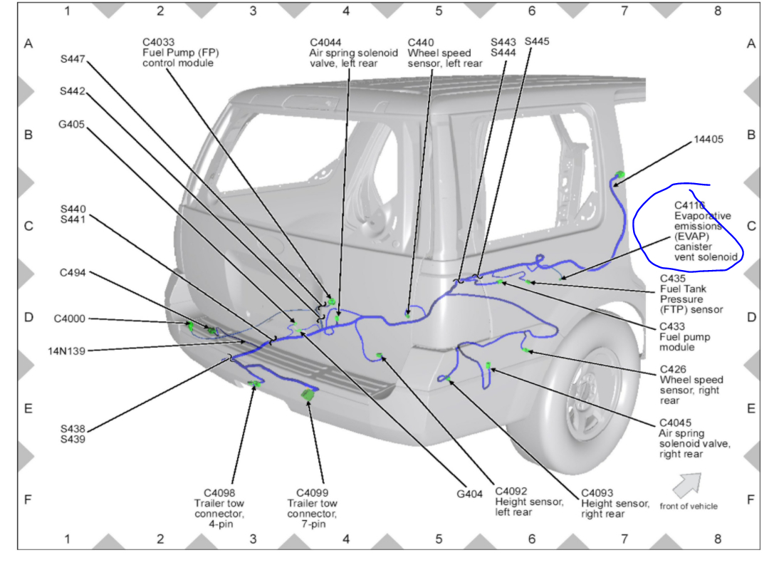

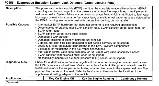

Good morning,
I found found several times the vent solenoid sticks open and does not close for the self test. I attached the possibilities for the code and the procedure for replacing the solenoid below.
https://www.2carpros.com/articles/how-emission-control-systems-work
https://www.2carpros.com/articles/evap-system-code-repair
Evaporative Emission Canister Vent Solenoid
