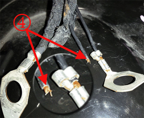

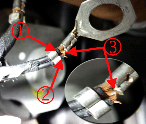

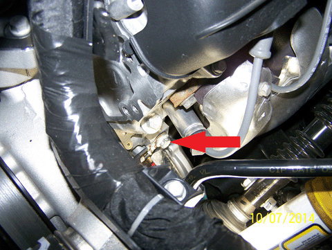

Your catalytic converter may have fallen apart causing an obstruction. There is a bulletin to check the coil crimps. Here is the bulletin with images.
Collision
 37
2009 GMC Truck Acadia FWD
V6-3.6L
Premature Catalytic Converter Failures
Vehicle Powertrain Management Technical Service Bulletins Premature Catalytic Converter Failures
PREMATURE CATALYTIC CONVERTER FAILURES
#PIP5232C: Premature Catalytic Converter Failures - (Mar 4, 2016)
Subject: Premature Catalytic Converter FailuresModels: 2016 and Prior GM Cars and Gasoline-Powered MST Light Duty and HD Trucks
This PI was superseded to update Recommendation/Instructions. Please discard PIP5232B.
The following diagnosis might be helpful if the vehicle exhibits the symptom(s) described in this PI.
Condition/ConcernTechnicians may encounter a concern where the catalytic converter has come apart or has set a P0420 and/or P0430.
If you believe the catalytic converter has failed with no apparent reason, it is recommended to inspect for a poor crimp for the coil grounds terminal on the engine block for the bank with the concern.
Open In New TabZoom/Print
Technicians should inspect the ground for possible corrosion or damage at ground terminal ring, fasteners and grounding surfaces.
If no corrosion or damage is found, tighten the ground bolt to the proper torque.
Inspect the coil grounds and repair if before replacing the catalytic converter.
