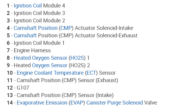

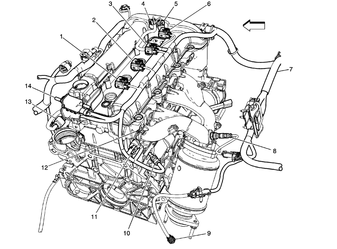

I got this error code, P0010 - Camshaft Position Actuator A - Bank 1 Circuit Malfunction. What does this mean, where on my car is the problem located, and how can I go about fixing this on my own. I read where I might need to replace a solenoid, but dont know where it is.
