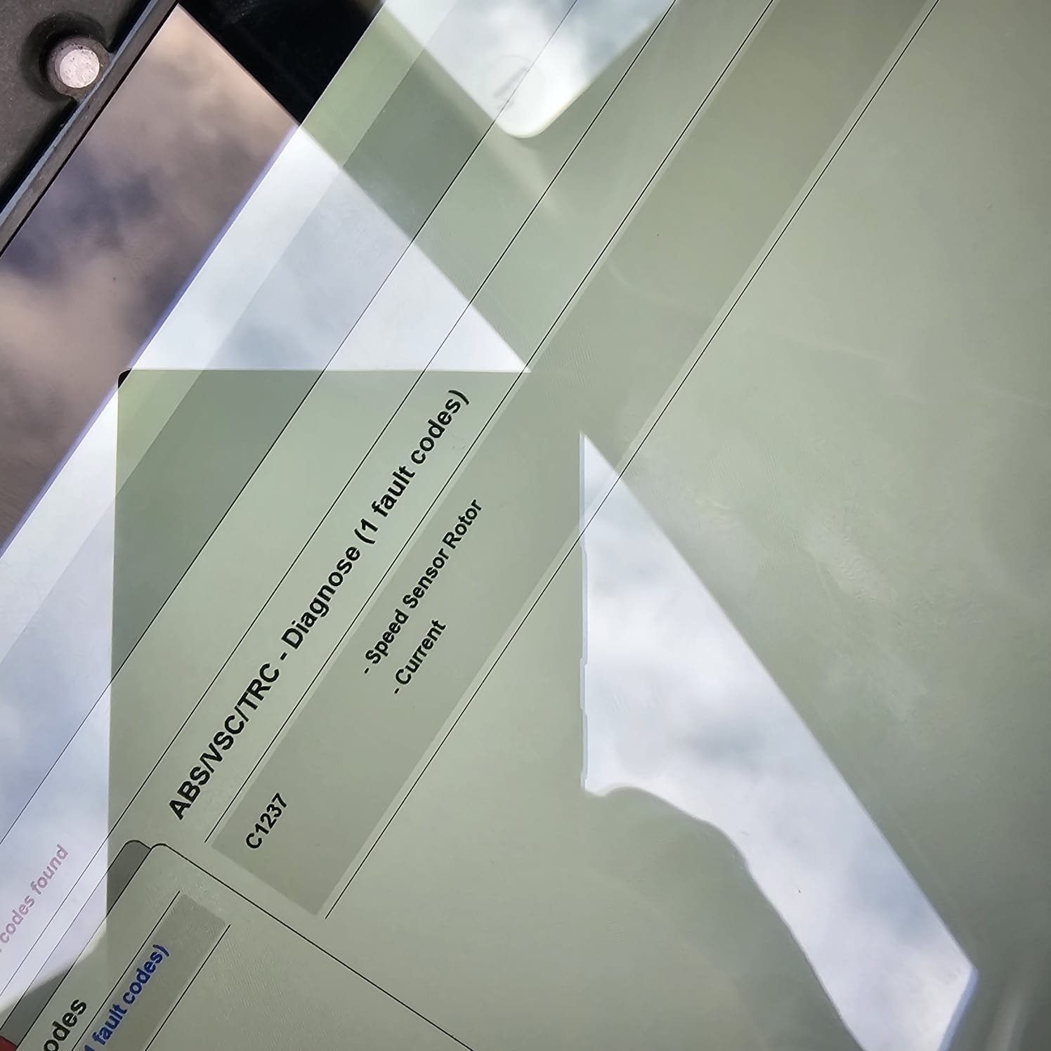

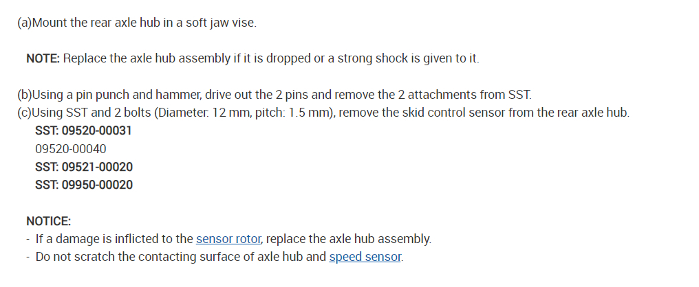

While driving, the car suddenly stopped and did not go into gear. I tried to switch it to manual mode and change gears from the steering wheel, but it was not possible (N was flashing). Then I turned off the engine and after a few minutes I turned it on again. The car started to take the gears normally and I continued the journey. The next day, after I had traveled approximately 60 miles, the car stopped again and after doing the same procedure, it started to shift gears again. I checked it with the computer and in the ECU for error code and found C1237, Speed Sensor Rotor. I really appreciate your advice on how I can fix this.
Where is the Speed Sensor Rotor for the vehicle listed above?
Can it be fixed by cleaning it because the alarm is not active all the time?
