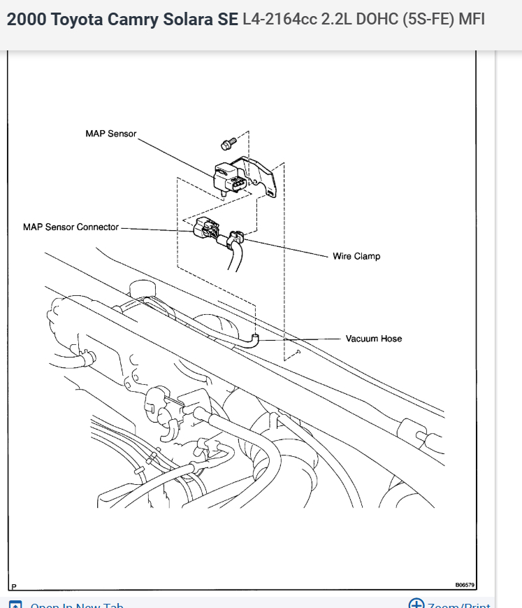

I would check the engine coolant temperature on a scanner to see if it is close to the outside temperature, (engine cold), Then I would make sure the gasket/hose on the MAP sensor is good, I have seen a weak map sensor cause this issue as well FYI. Here is the location of the MAP sensor so you can check it out. Clear the codes once any repairs are complete. Check out the images (below). Please let us know what happens.
