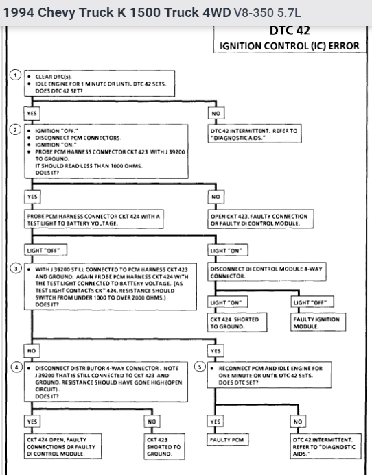

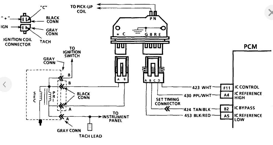

I drive the truck listed above k1500. My truck shut off on the road and threw a code 42. The engine will crank but i get no spark. I have replaced the ECM, the battery (which was dead), and every ignition component except for the distributor. A friend of mine thinks it is throwing a false code and i need to replace the distributor, but i want to get opinions from anyone i can before throwing more money at it.

Hello, I'm Danny.

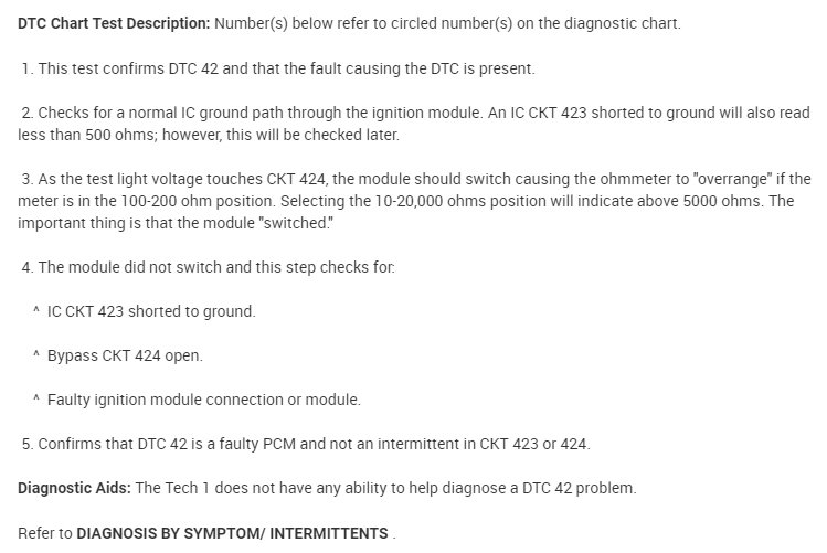

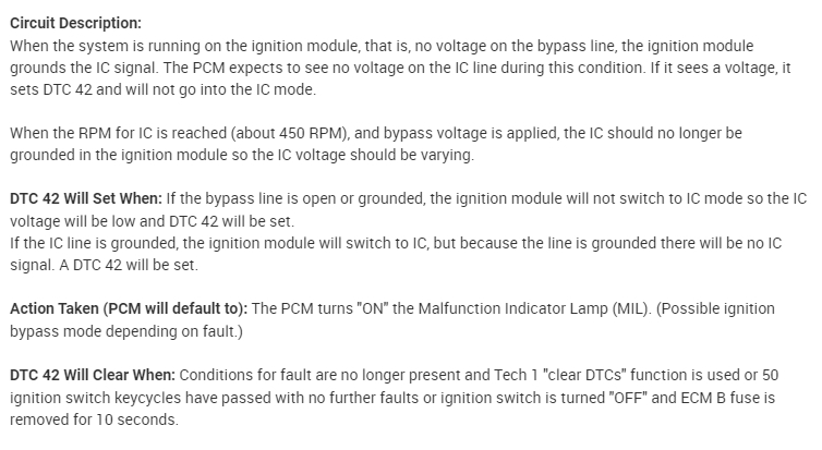

I've attached a step-by-step picture diagnostics for Code 42 below.This will help you to troubleshoot before buying more parts or something else.Hope this helps and thanks for using 2CarPros.

My apologies for taking so long to reply, but it looks like these instructions require for the engine to start. I have no spark at all thus the engine wont run at all in bypass mode or not. If I'm missing something in these instructions please let me know thanks!!

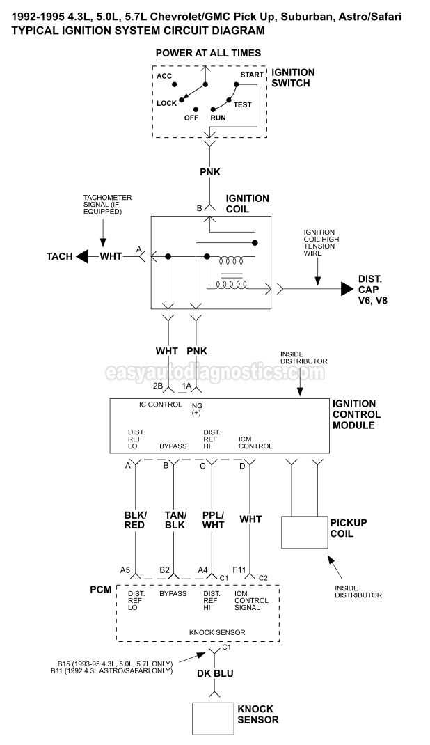

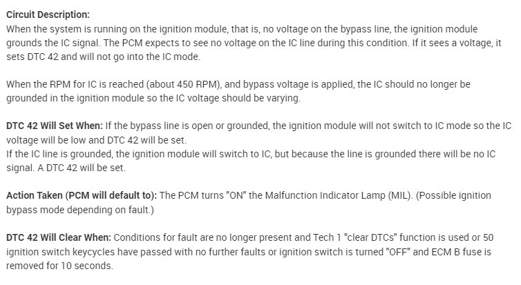

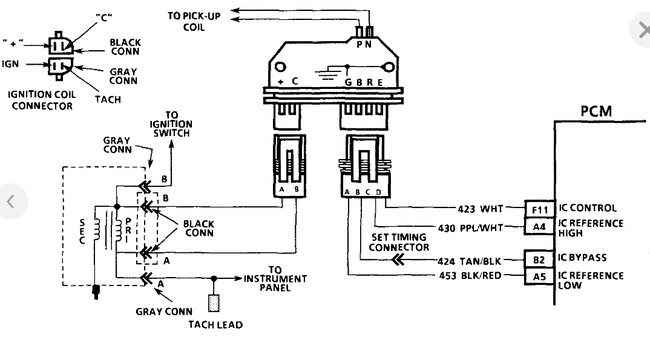

Hello, code 42 is referring to the EST bypass circuit, it is the tan/black wire in this diagram. This wire controls the timing advance from the ecm. The ecm is seeing an open circuit or short to ground on this wire. So you're going to have to check this wire from the ignition module to the ecm before changing anymore parts. If this wire is touching the frame somewhere or is broken it is going to mess with the ignition timing and cause a no start.

I'm currently living 45 minutes away from where muly truck is (because of Christmas vacation) but i'm trying to go to a nearby salvage yard tomorrow to pull and entire engine wiring harness, which contains the wires from ECM to ICM. Is replacing the entire harness myself a good idea?

Well, it would probably take more time to replace an entire harness, than fix the one wire that's shorted out. The EST is the wire by the distributor that has the little plug you would take out to set the base timing. What you would want to check is anywhere the harness has a contact point with the engine or chassis. These are the spots that wear threw because of vibration from the engine. I would go after a single wire versus changing the whole harness. Try unplugging the est timing plug and see if the truck starts, let me know if it does. It's the tan/black wire.

I tried unplugging the tan and black wire like you said and still couldn't get it started. What's next? Is my next step still replacing this wire? If so how hard will that be i'm not a wiring expert and actually hate doing anything with wiring normally, but i want to fix this without hiring someone else if possible. Also i talked to a person at a local AutoZone and he said any wire running to the ECM should be grounded but when i checked every wire i checked was hot. I do not know if this means anything but could it possibly be that my ECM connectors are shot?

Okay, so going back to your original post, you said you've replaced everything except the distributor. It sounds like the pick up coil in the distributor is bad. Do you have an automotive test light? I can explain how to test the pick up coil with a test light. There's a purple/white wire coming from the ignition module, with your test light hooked to battery negative, and back probe this wire, your test light should pulse while cranking. I'm assuming you have replaced the ignition module as well?

The pick up coil is located inside the distributor, so getting a remanufactured distributor from the parts store is the safest bet. A junkyard distributor will not last long. Also take off the distributor cap and make sure the distributor spins while cranking. Since you've replaced every part except the distributor, that's most likely the issue, you can test the ignition coil to see if there's a signal. Test light connected to battery positive, and the negative side of the ignition coil should pulse while cranking. Same as the purple/white wire at the ignition module, this wire should pulse while cranking as well. Test light connected to battery negative. These tests will give you direction in diagnosing this. Also check the engine to body ground wires and make sure there's no corrosion or bad connections .

The pick up coil in the distributor is the main input for spark and fuel injection. If you connect your test light to battery negative and back probe the purple/white wire at the ignition module, you should get a pulse on the test light while cranking. This is the reference high signal wire, if there's no pulse then most likely the pick up coil is not functioning. You should also get a pulse on the negative wire of the ignition coil.

Okay, so upon inspection i found the pickup coil was bad. It was a stock coil so it was riveted instead of screwed but no problem i just replaced the whole distributor. Now i have spark but i'm not getting fuel. My guess is i just haven't ran the truck in so long the fuel pump went bad but i'm looking for any tips and or suggestions. Thanks!

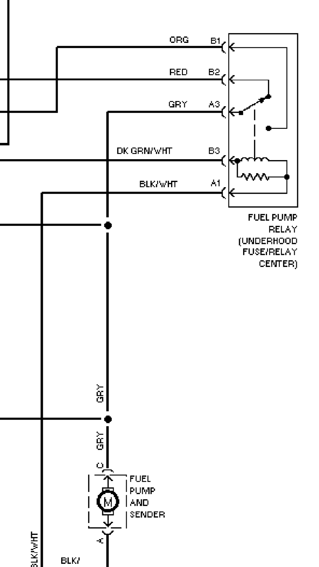

Okay, we're going to skip forward here since you've replaced the fuel pump relay already. There should be 2 hot wires (12 volt) while cranking, where the relay sits. So take it out and check the pins for 2 for 12 v cranking. Now there could be corrosion in fuse panel where the relay is too, so you'll have to check it. If there isn't 2 hot pins at the relay, then go to the back of the ECM and check pin F6, it will be dark green/white. You will have to find it according to color. This wire should be 12v while cranking as well. Here's 2 wiring diagrams to help. Make sure to pay attention to wire condition also, you most likely have a broken or corroded wire. Check around where you have been working on the truck so far, that you didn't move any wires or hide the problem. Since you had the fuel pump running before. Check all the ground wires near the pump on the back of the frame too. The 2 thicker wires at the fuel pump are power and ground, the power is the thick grey wire.

My fuel pump relay isn't in the fuse box its on the firewall directly in front of the ECM in the engine bay. I don't think the location should matter as long as i am finding the right wires. right?

No it shouldn't. Only wire color matters.

Okay, i now have power to my fuel pump and can hear it priming when i put the key in the on position, but i'm still not getting fuel into the engine. I assume it's either my injectors or a clog in the fuel line, but again i don't want to go spend more money and not have it work.
