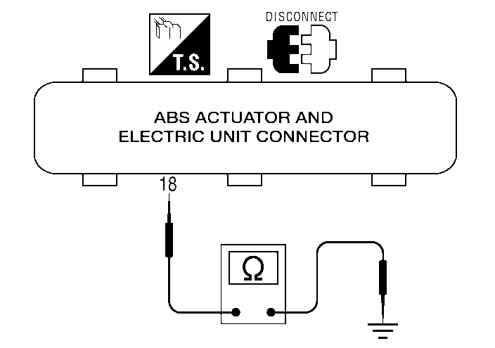

1. Disconnect ABS actuator and electric unit connector.
pic 2
2. Check voltage between ABS actuator and electric unit connector E55 terminal 18 (Y) and ground.
Does battery voltage exist?
YES >> Replace ABS actuator and electric unit.
NO >> Check the following.
^ If NG, repair harness or connectors.

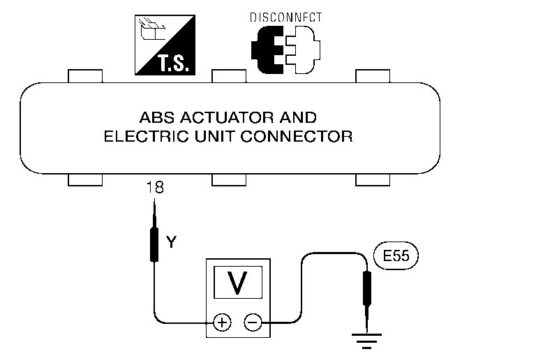

7. CHECK SOLENOID VALVE RELAY POWER SUPPLY CIRCUIT FOR SHORT
pic 3
1. Disconnect battery cable and ABS actuator and electric unit connector.
2. Check continuity between ABS actuator and electric unit connector E55 terminal 18 (Y) and ground.
Continuity should not exist.
Does continuity exist?
YES >> Check the following.
^ Harness connector E55
^ Harness for short between ABS actuator and electric unit and fusible link.
NO >> Replace ABS actuator and electric unit.

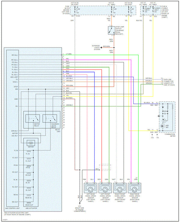

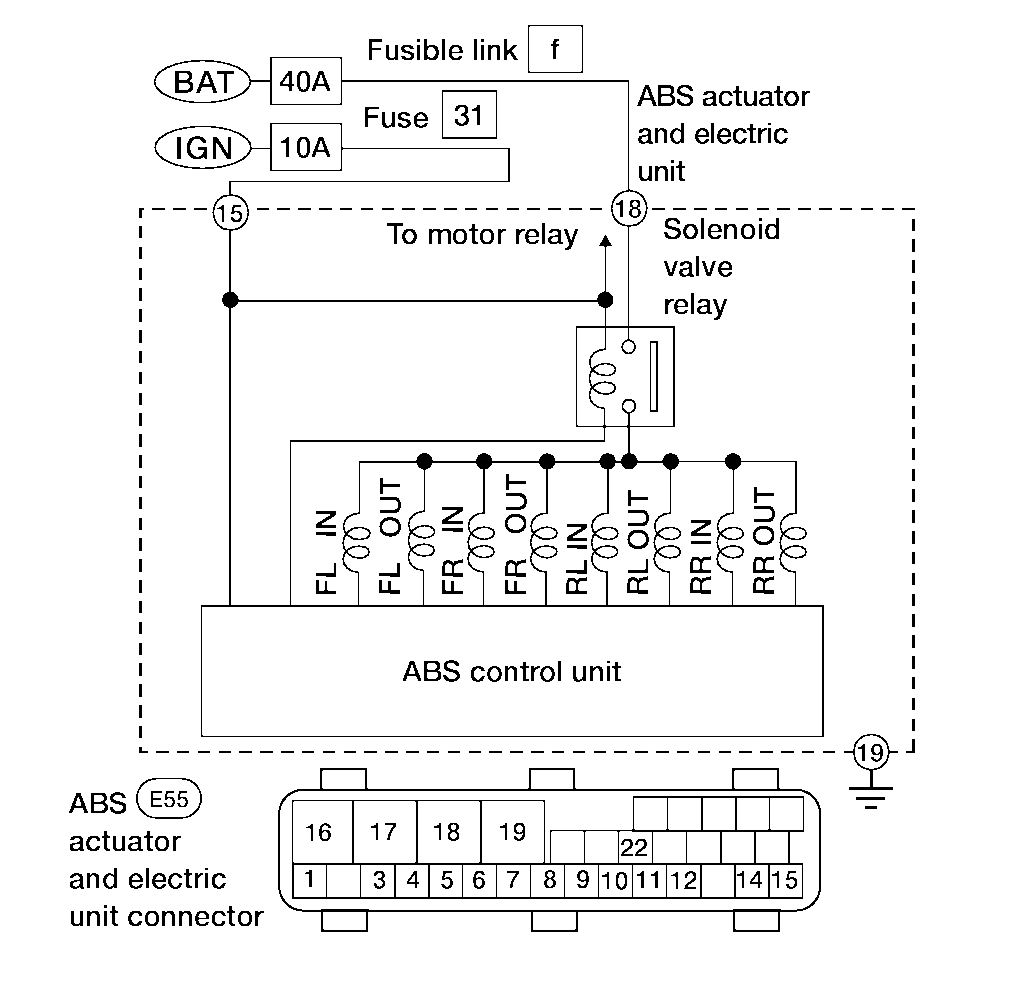

If you look at pic 4, it shows the entire wiring schematic related to the traction control and ABS.
Let me know if this helps.
