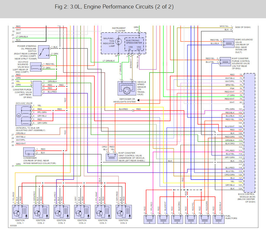

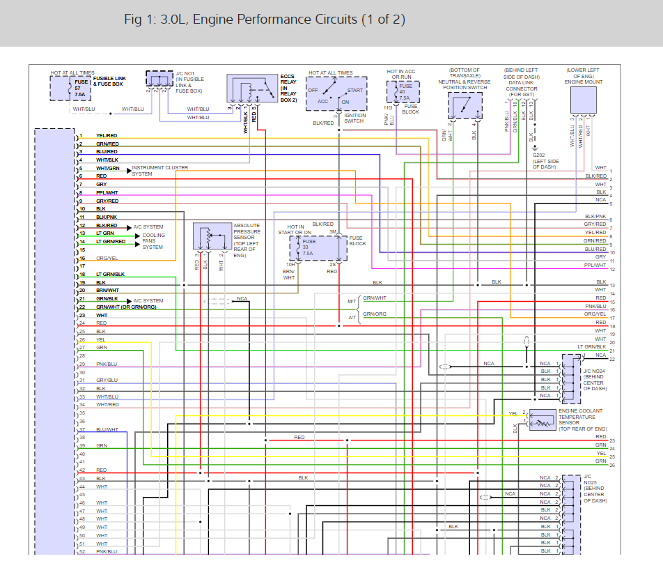

Coil on plug system. Replaced all coils with new one but the wire harness is not replaced. I think that the ECM controls the ignition and there is no ignition module.
So do you think the problem is with the coil wire harness?
Feb 10, 2019 at 4:04 AM

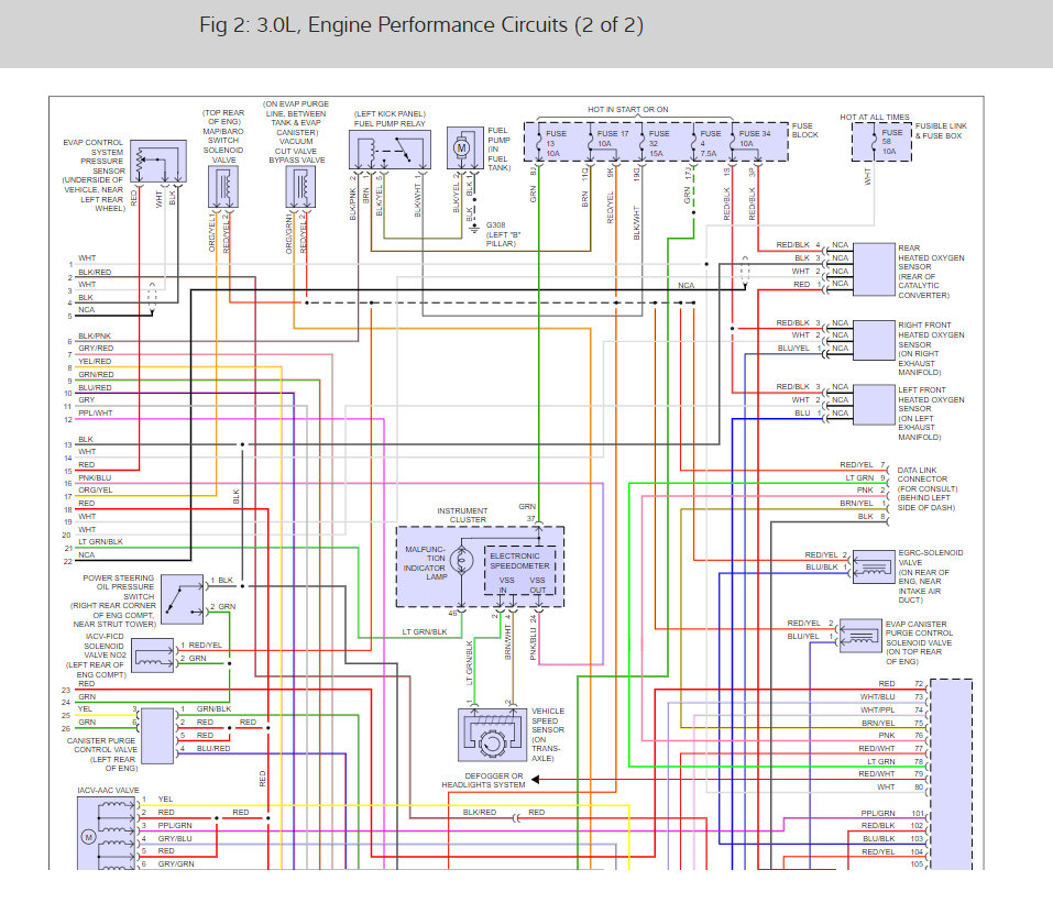

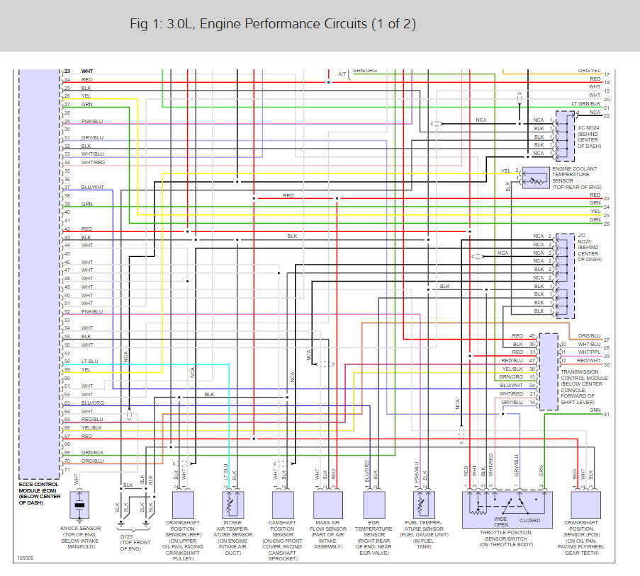

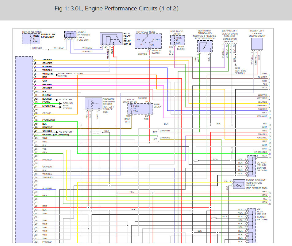

Yep, it sounds like you have high resistance in one or more wires. here is a guide to help you test with the engine wiring diagrams below:
Check out the diagrams (below). Please let us know what you find.
