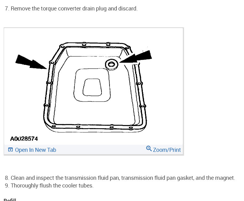

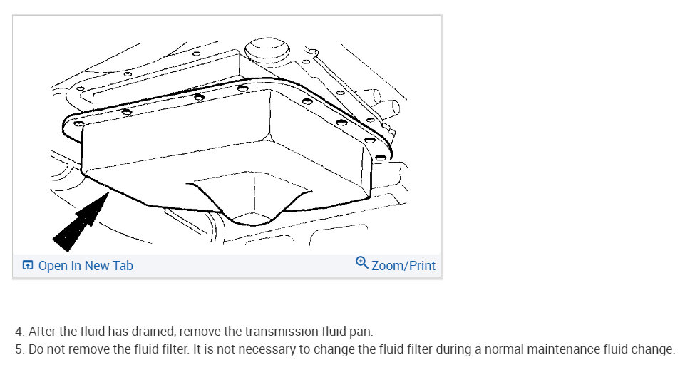

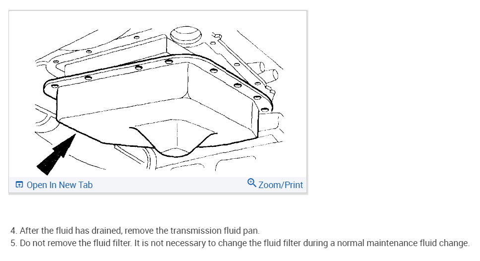

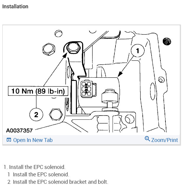

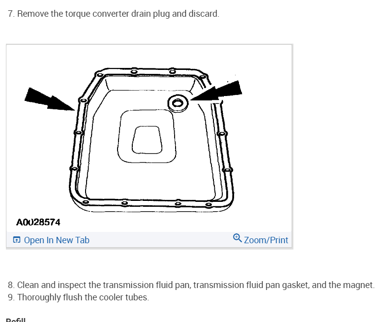

I have seen the Lucas transmission treatment do wonders, but let's run the codes to see what comes up.

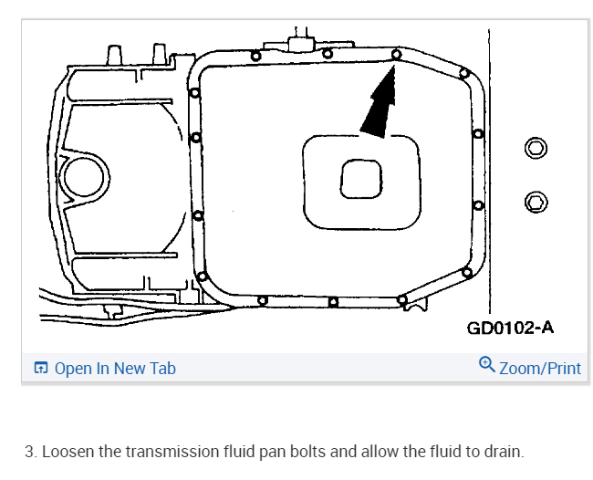

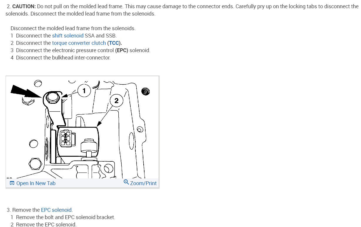

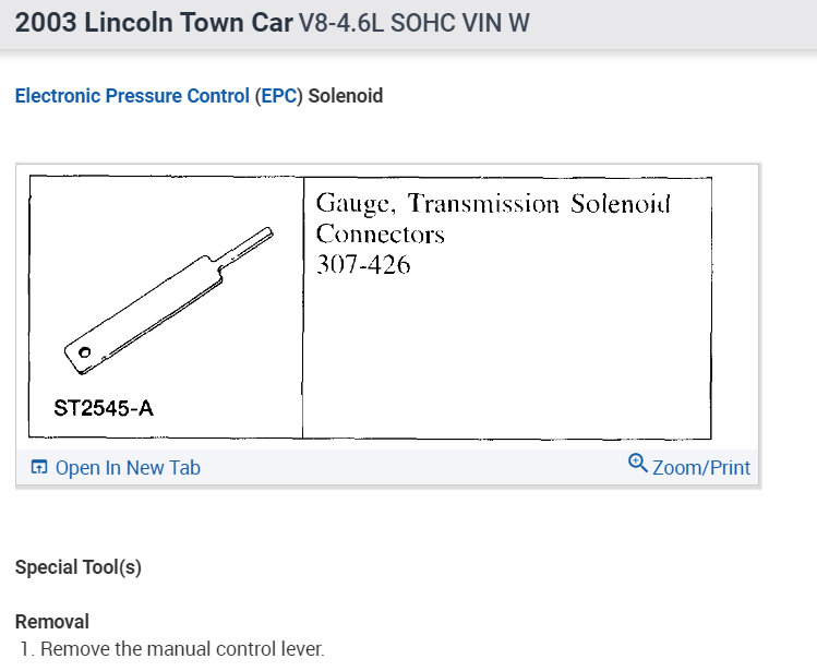

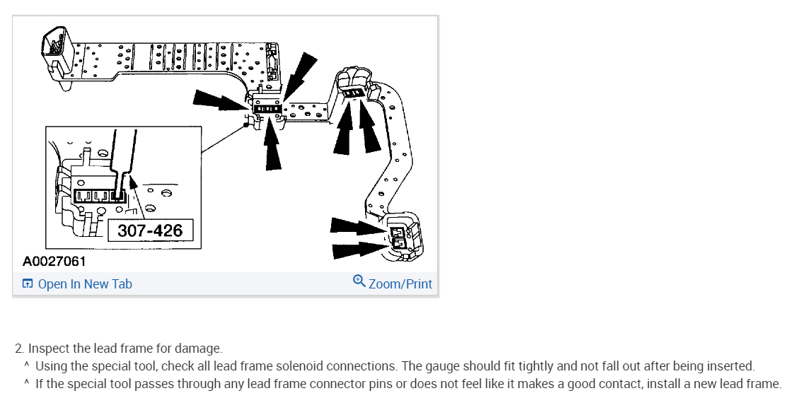

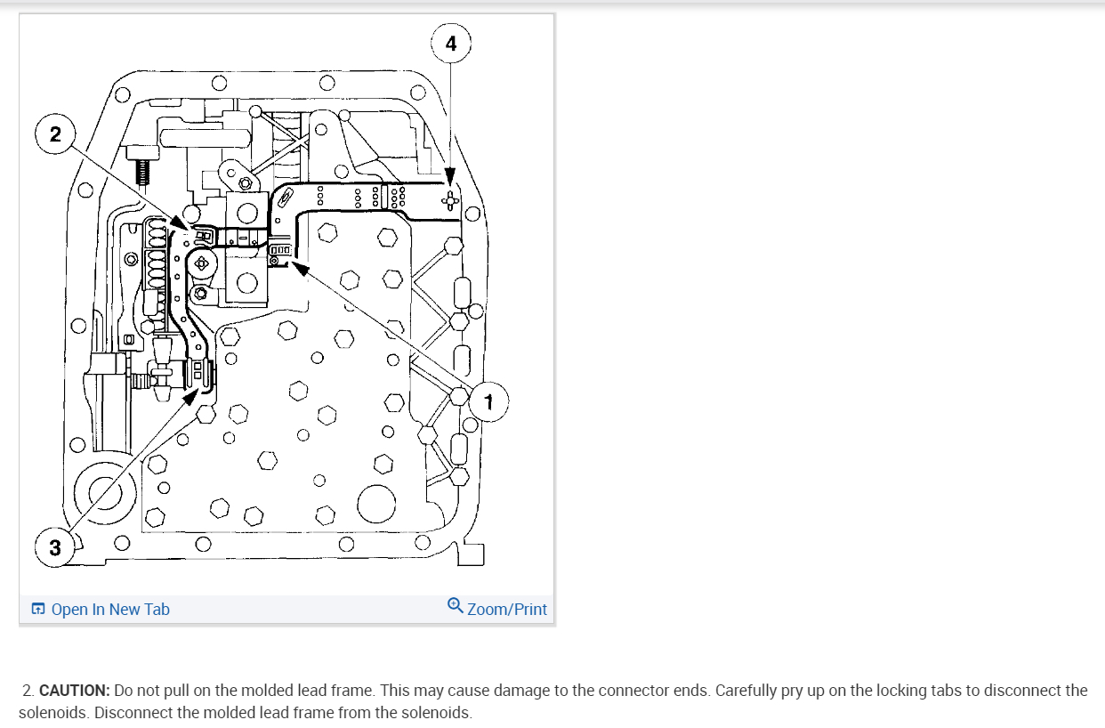

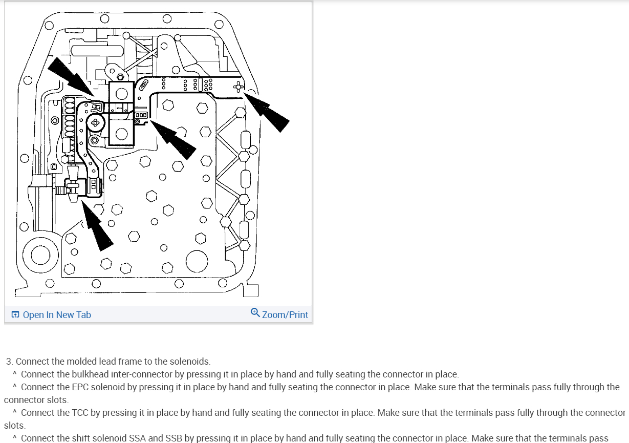

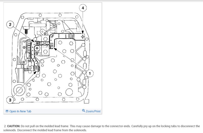

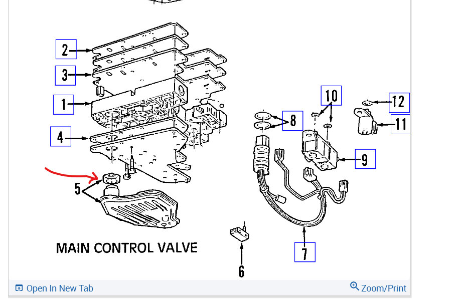

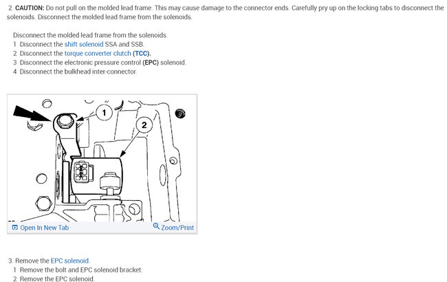

I have seen the pressure regulating solenoid cause problems like this, this is the location so you can check it out. I have also seen the fluid filter inside the transmission come loose which can cause this as well.
Check out the images (below). Please let us know how it goes.
