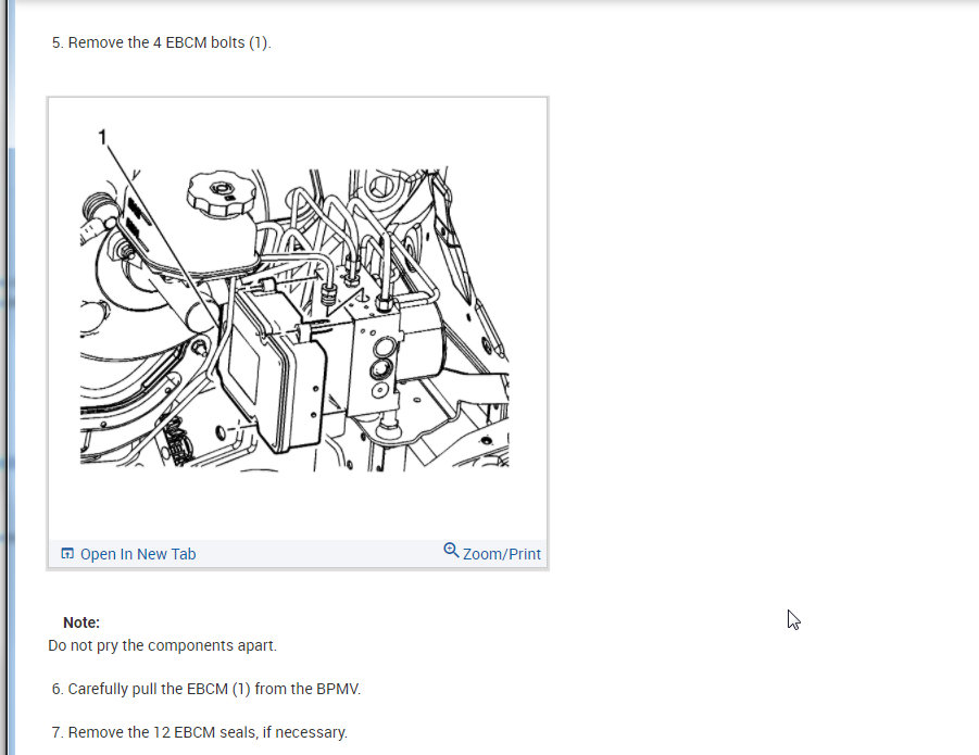

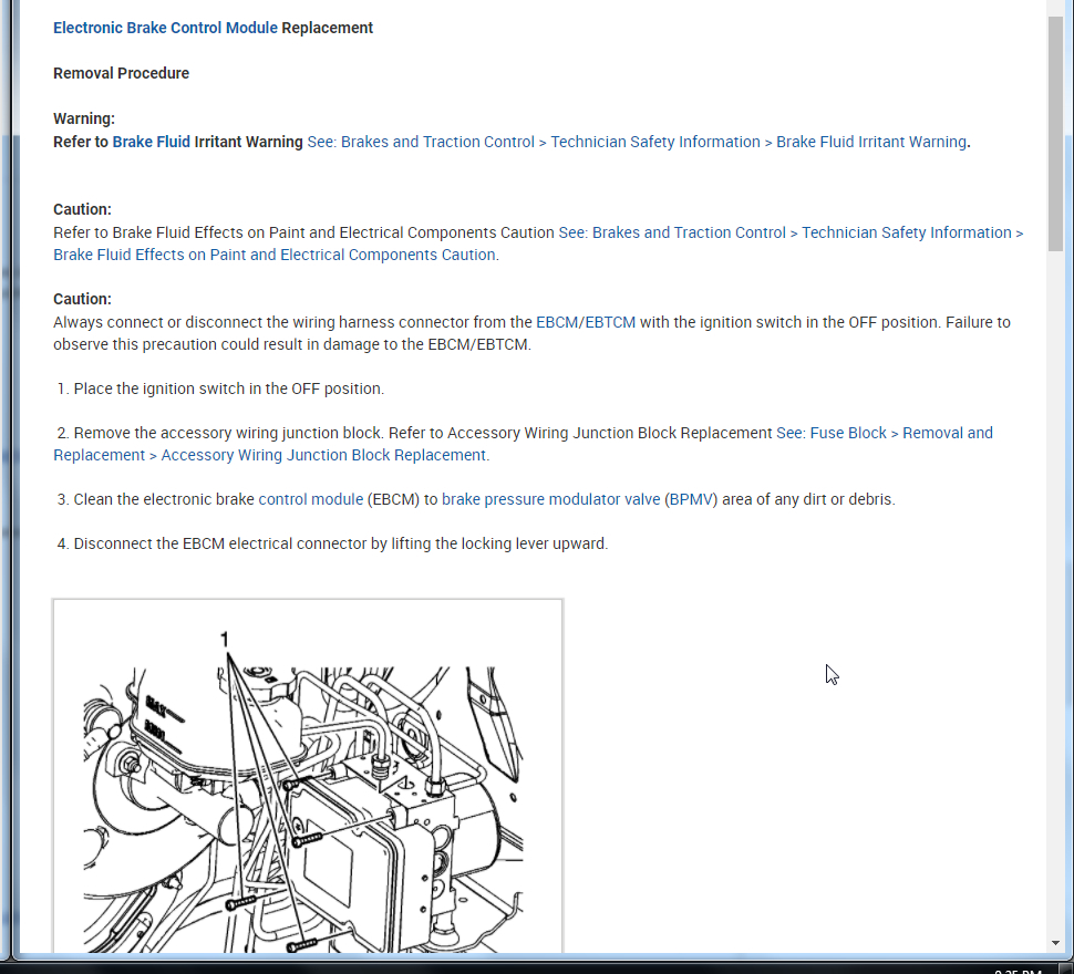

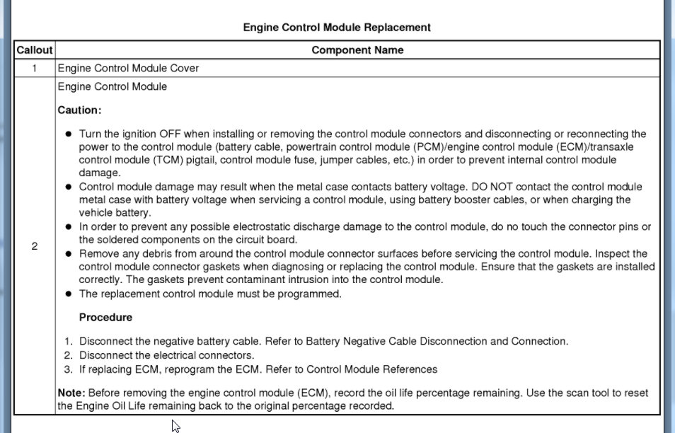

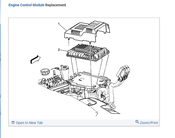

Below is the detail on the ECM and ABS that should help. Let me know what codes are there and we can go from there. Thanks
