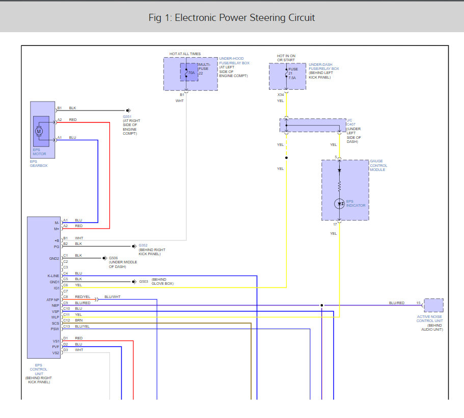

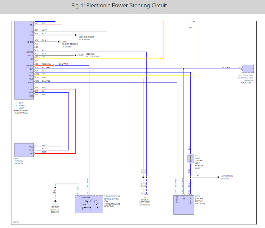

The steering wheel is hard to turn when the vehicle is stationary. The fuses are okay in the engine bay and passenger compartment. However, we do not want to guess. The inscription is Japanese. Can you assist with information and diagrams relative to system operation and location of components. Thanks!
