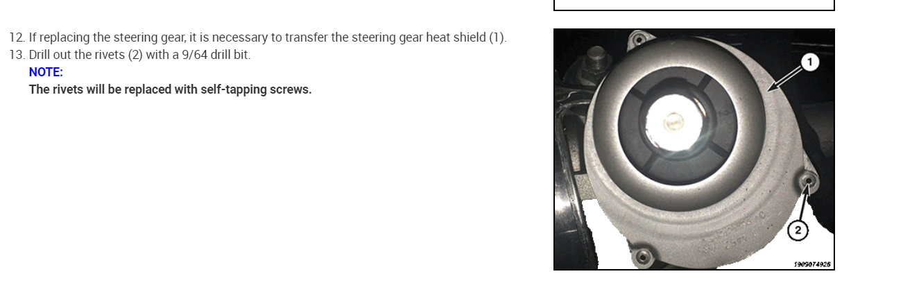

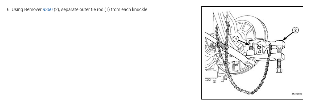

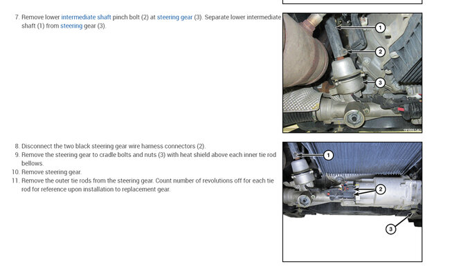

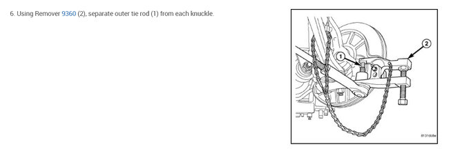

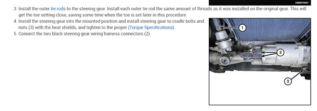

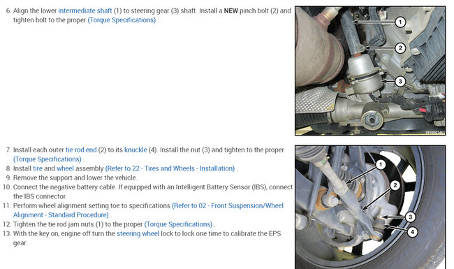

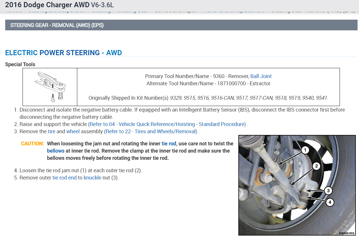

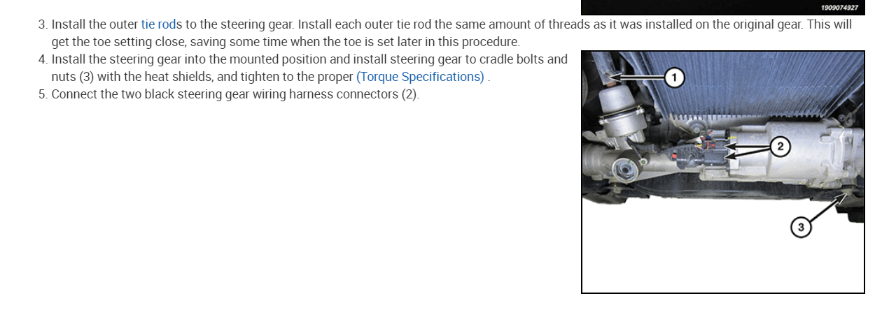

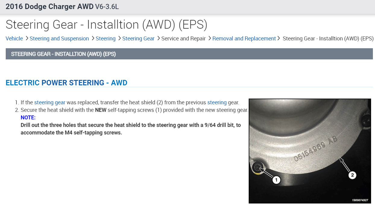

Here is how to change out the steering rack and motor in case you need it. Check out the images (below). Please let us know what happens.
