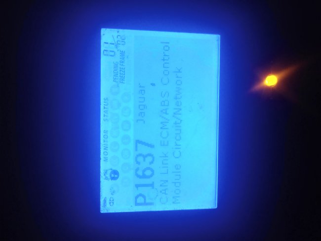

How do i check voltage? As far as codes if checked with obd2 i get p1637, if i go through the car diagnostic nothing has changed.

Okay, check the brake light switch on the brake pedal. That is what controls the interlock for shifting. Once again, you need a voltmeter to test for voltage on both sides when the pedal is depressed.
As far as the code, it is for the wheel speed sensor. they need to be checked or monitored to see if they are sending signals.
you need an advanced scan tool to monitor these sensors.

I still have code p1637 comes back after i erase them.

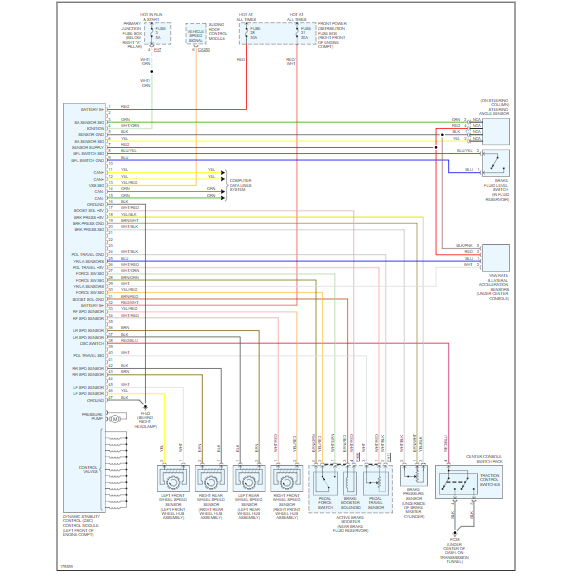

I am trying to find a wiring diagram for the ABS system so you can verify powers and grounds to the unit but I am not having much luck finding one.
I will keep looking for you.
Clearing does nothing until the issue is determined and repaired.
Feb 23, 2019 at 4:34 AM
I found this diagram. Take a look at it.
You would need to download and then you can enlarge it.
