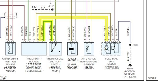

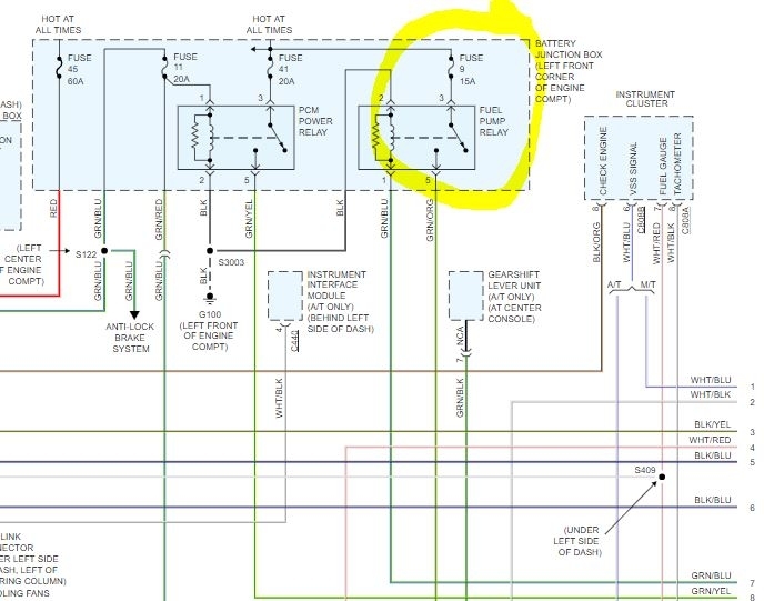

I attached a wiring diagram. You need to verify the fuse circled has power on both sides. The wires at the module need to be confirmed as well. They should be hot in the start mode.

Thanks for the prompt reply. I have a multimeter and I have checked the inertia switch.
Mar 23, 2019 at 5:47 PM
Okay, what were the results? Do you have voltage on both sides?
Mar 23, 2019 at 6:01 PM
  • 9 POSTS
With a multimeter what is the best way to measure the voltage across the fuse?
For the module do I measure the voltage between pin 2& pin 9 as well as pin 2 and pin 10. Can I remove the connector and measure voltage on the connector pins ?

Use a volt meter and check for the voltage at the switch.
Mar 23, 2019 at 6:16 PM
  • 9 POSTS
With a multi-meter what is the best way to measure the voltage across the fuse?
For the module do I measure the voltage between pin 2 and pin 9 as well as pin 2 and pin 10. Can I remove the connector and measure voltage on the connector pins with a multi-meter ?
Mar 23, 2019 at 6:24 PM
Put the black lead on a good body ground and the red on the terminal. Check the voltage at each pin.
