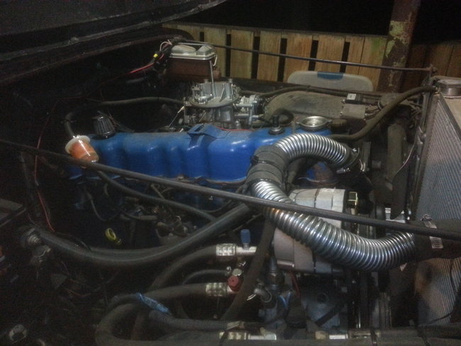

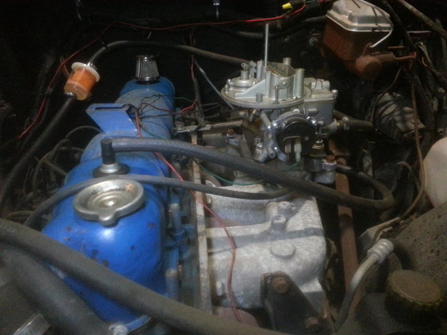

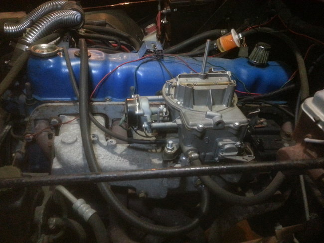

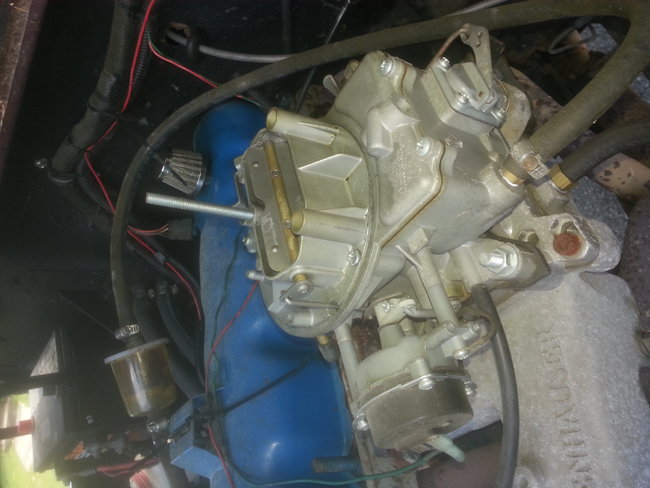

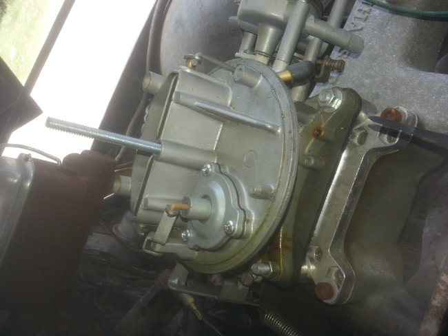

All ports not being used on the carb and manifold need a cap!
You DONE GOOD going back with the original ($20/ correct) Fuel Pump and the Mechanical fan. They work well/ last a long time. I keep a spare coil/ ignition module/ fuel pump/ in my Jeep at all times. Twice I've had to aid other roadside Jeeps with the later two. (They didn't expect I had parts and tools on board!)
At present, we will ASSUME (know what that means?) Your fuel pump is good, we can always circle back
