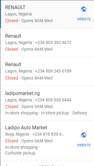

We are not associated with Renault or any other car company, so unfortunately, we don't have the immobilizer information.
Take a look at the image below, it shows a few phones numbers for Renault stores. That might be helpful.
