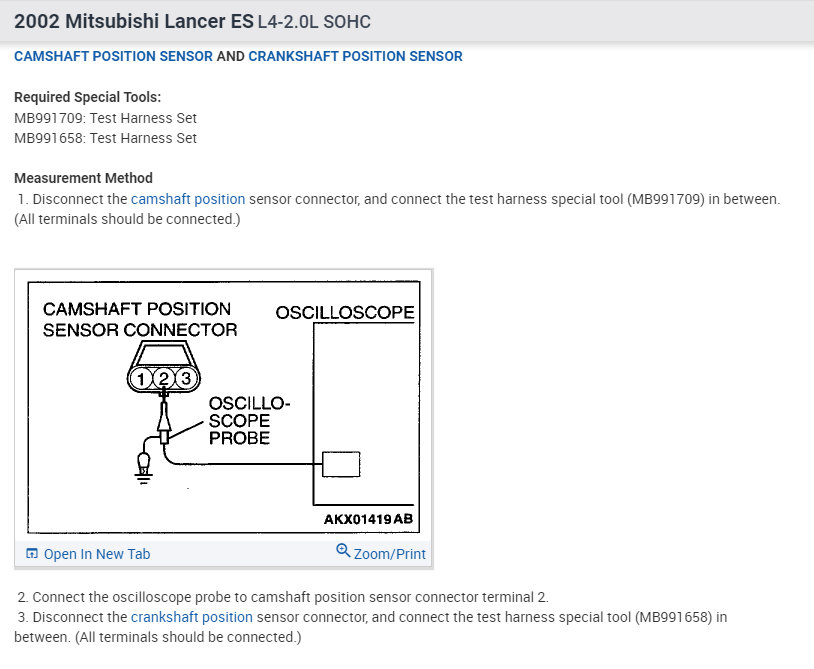

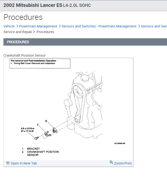

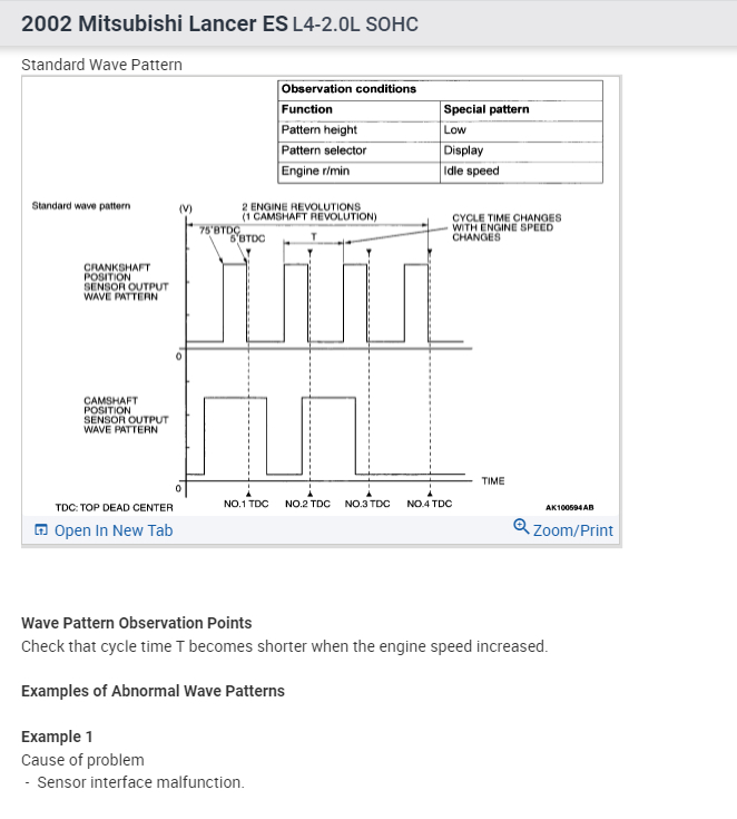

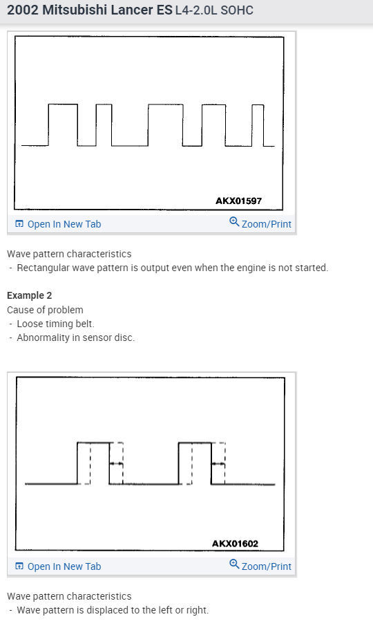

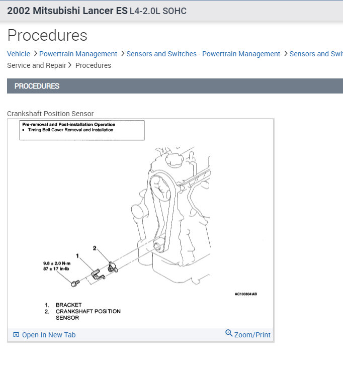

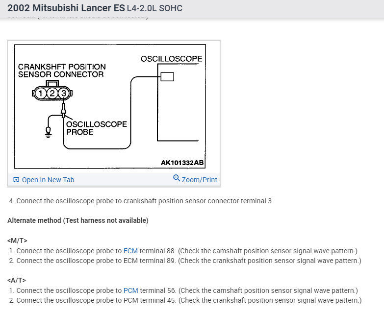

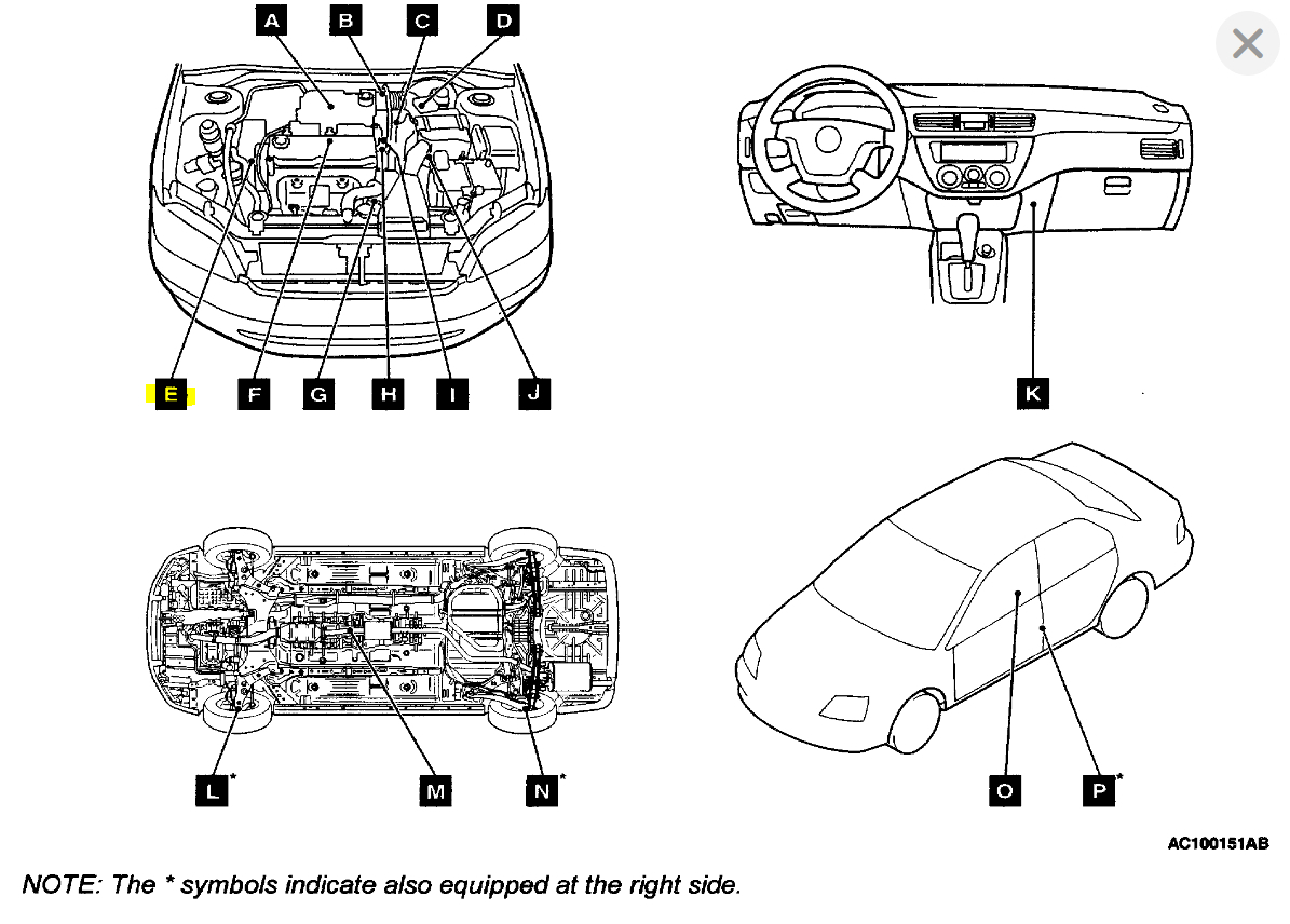

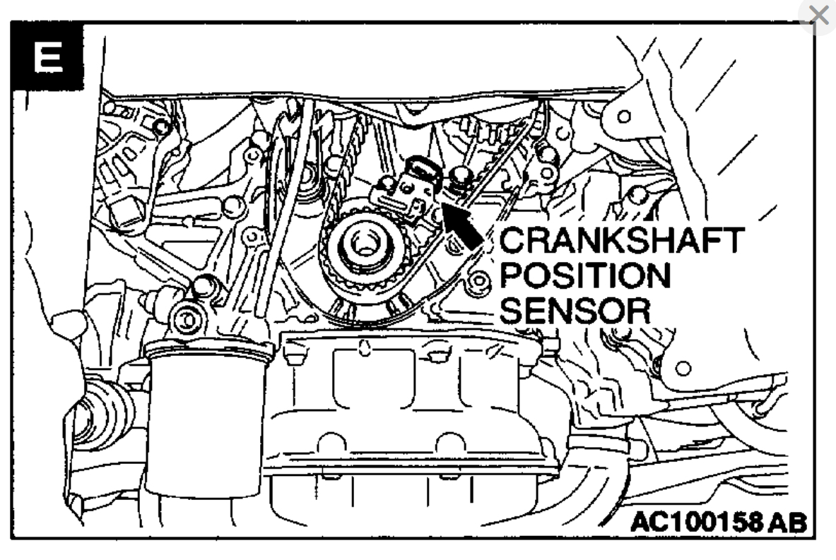

One of the reasons an engine can stall while driving is having a faulty crank position sensor. If the crank sensor is unable to send correct data to the ECM, it will trigger an engine to shut down.
Please let me know a few more details of what you have been experiencing.
