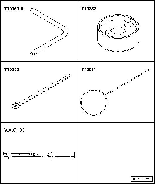

pic 1
Special tools, testers and auxiliary items required
Drift (T10060 A)
Counter-holder tool (T10355)
Assembly Tool 10352 (T10352)
Securing pin (T40011)
Torque Wrench (V.A.G 1331)

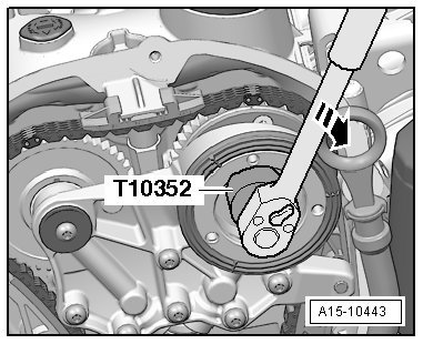

The control valve has a left thread.

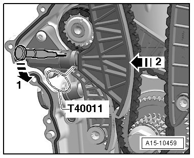

- Remove the control valve using Assembly Tool 10352 (T10352) in the - direction of arrow -.
pic 2

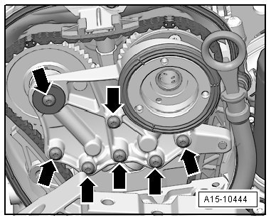

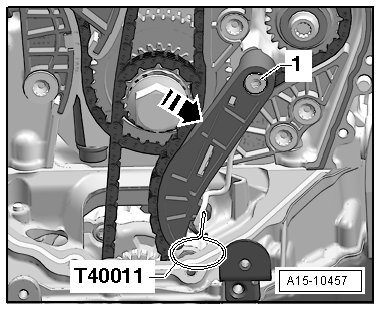

- Remove the bolts - arrows - and remove the bearing bracket.
pic 3

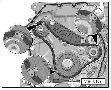

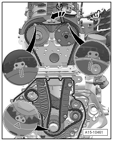

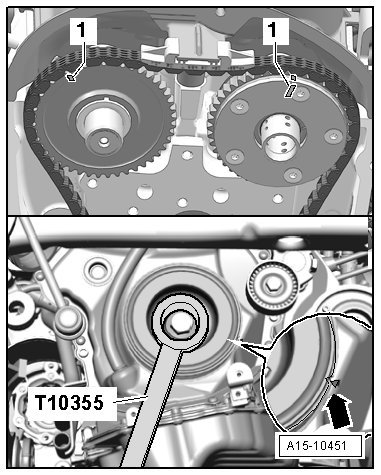

- Rotate the vibration damper using the Counter Hold Tool (T10355) into the "OT" position - arrow -.
pic 4
The notch on the vibration damper must line up with the arrow marking on the timing chain lower cover.
The markings - 1 - on the camshafts must point upward.
- Remove the lower timing chain cover => [ Chain Drive ] See: Engine > Removal and Replacement > Chain Drive.

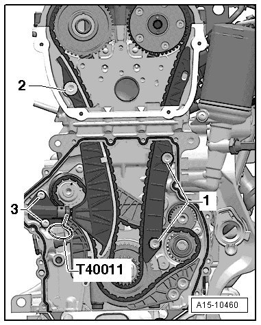

- Press the oil pump chain tensioner in the - direction of the arrow - and secure it with a locking pin (T40011).
pic 5
- Remove the oil pump chain tensioner - 1 -.
- Remove the oil pump chain tensioner.

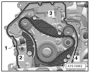

- Remove the tensioning rail - 2 -.
- Remove the guide rail - 3 -.
- Remove the guide rail - 4 -.
- Remove the timing chain.

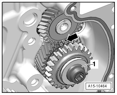

- Turn the intermediate shaft sprocket/balance shaft to the marking - arrow -.
pic 13
Due to the ratio, the marking align only every 7th turn.
