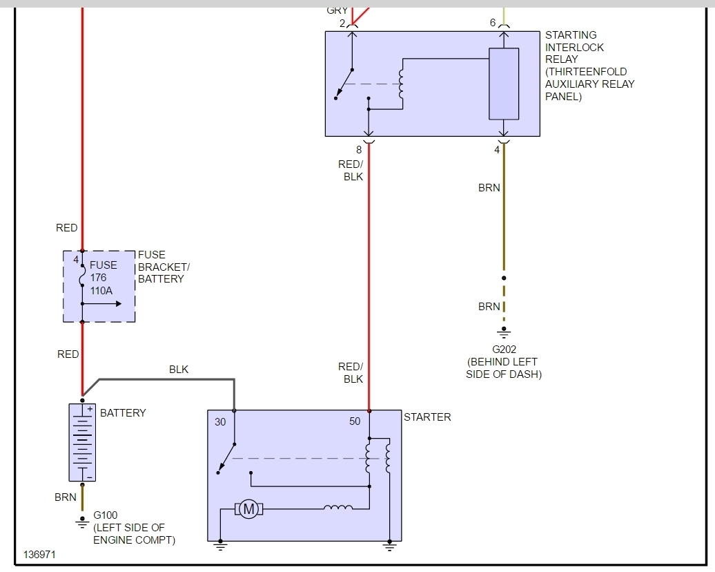

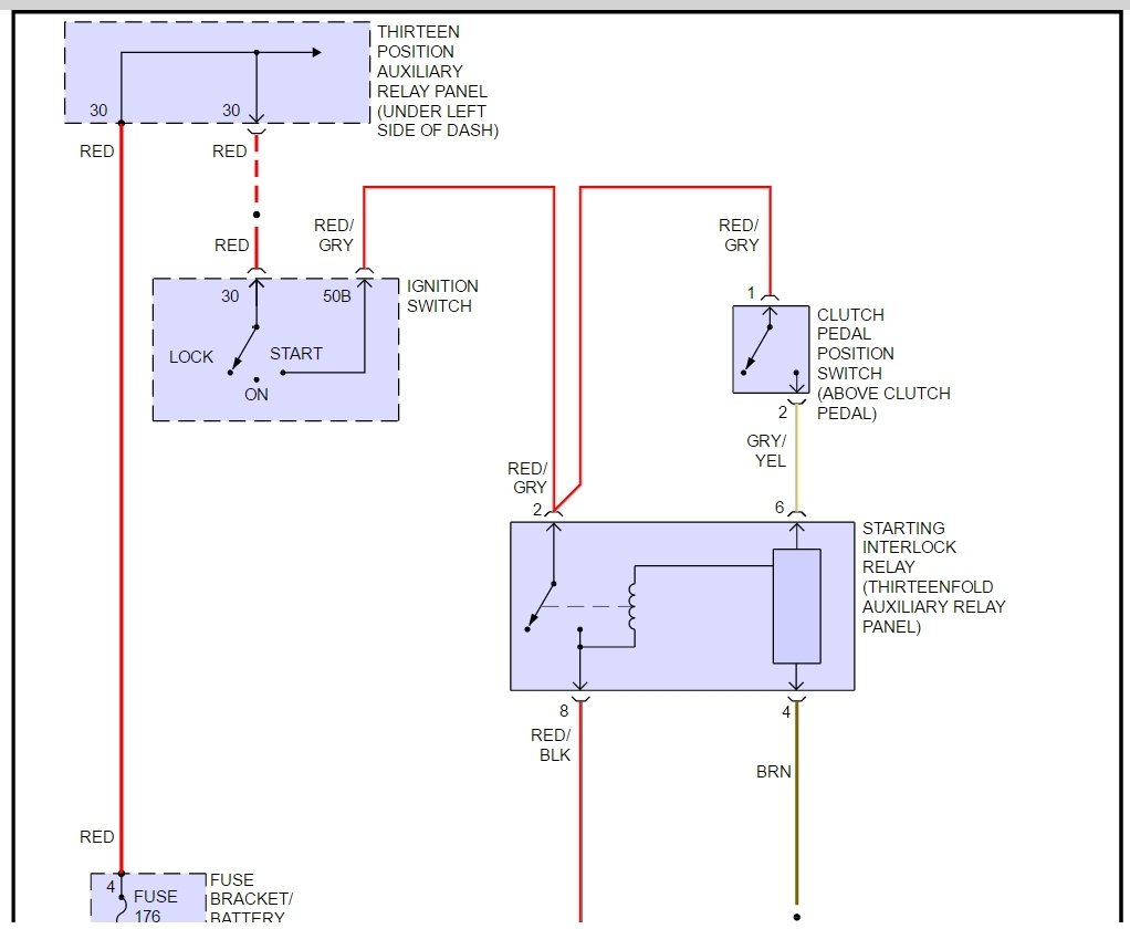

Hey WOODHEAD75,
It looks like there is an inhibitor relay that is going out, here is a wiring diagram for it so you can troubleshoot the circuit.
Best, Ken

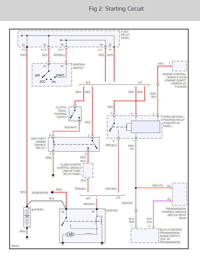

I have not noticed any problems other than 2 weeks ago. I would have to press the clutch in and out about 3 times before it would start. When I turn the key the lights turn on but there is no sound or clicking. Battery is fully charged. I put in a new clutch relay switch, nothing. Took out the starter out, tested it, it’s fine. Then put the starter back in, it started for me 2 times. Now not starting again.
Jump wired the starter terminals and the car turns over but nothing with the key.
Any ideas of what I could try next?
Aug 6, 2019 at 10:17 AM (Merged)

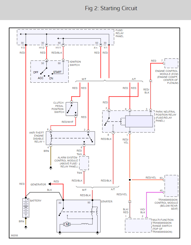

There is an engine disable relay that needs to be checked. here is a guide to help you and the starter wiring diagrams so you can see how the system works. Also this guide can help as well.
Check out the diagrams (below). Please run this test and get back to us.
