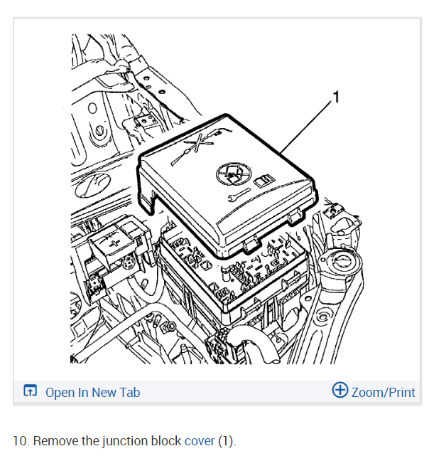

Turns out I have a bad engine wiring harness. I have a replacement, but I am hoping you can send me diagrams of the total location of the harness wrapped around the engine, as well as instructions on how to remove and then replace it.
Hopefully this can be done without removing the engine.

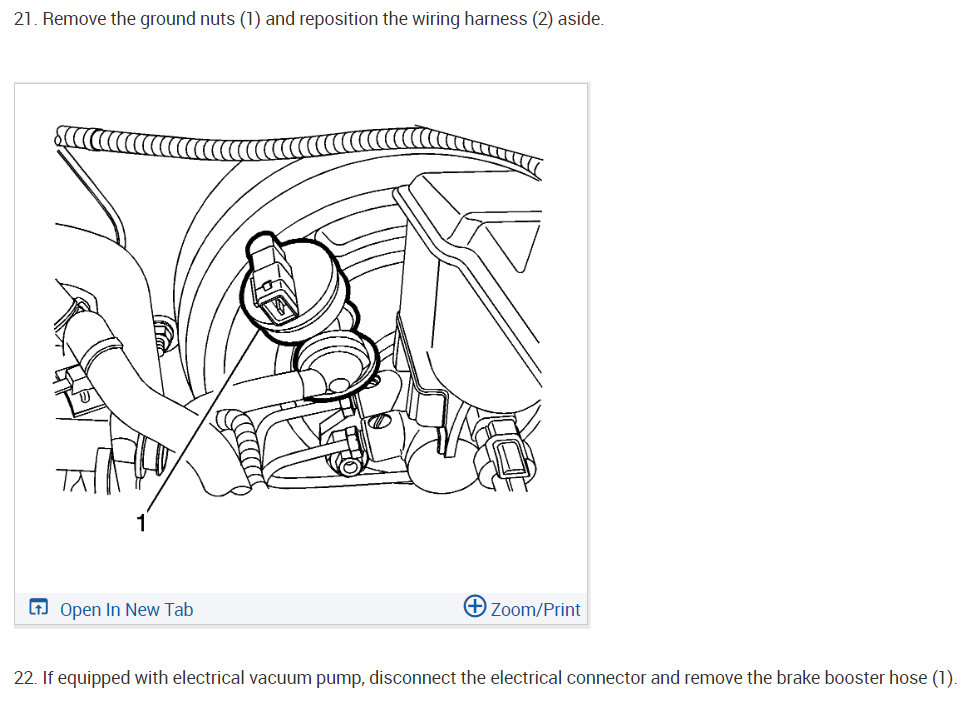

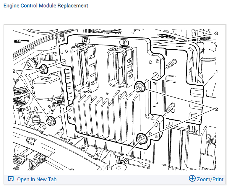

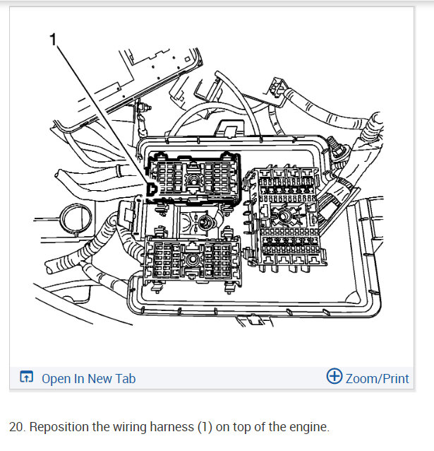

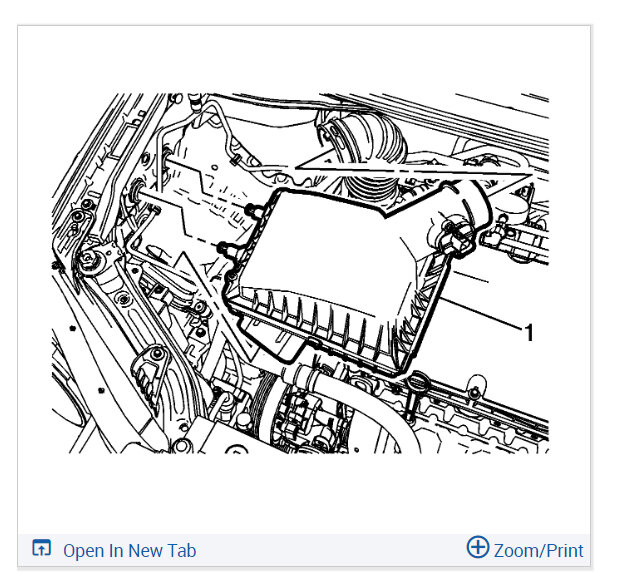

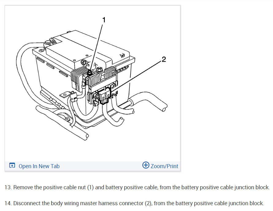

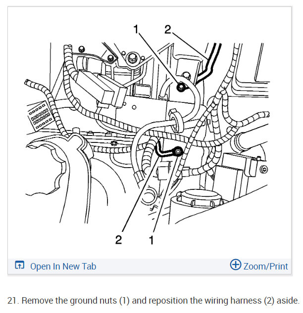

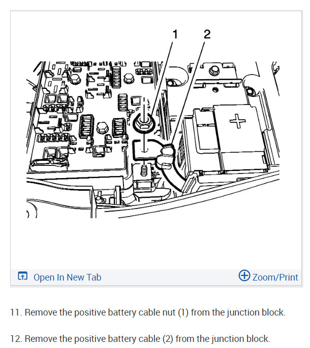

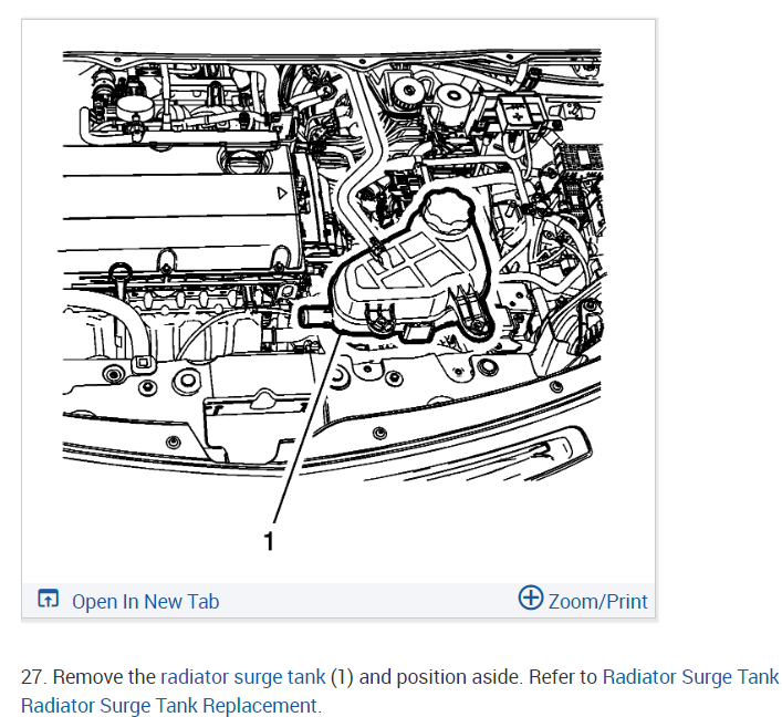

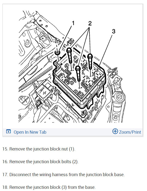

This should be able to be done without removing the engine though you might need to remove some accessories such as an alternator etc. You will need to start by disconnecting the battery and removing the air filter housing. Then remove the main junction box (fuse panel) this will allow you to remove the main electrical connectors. Here are instructions in the images below to help you with the job, if you get stuck, please upload images of the problem so I can help walk you through the repair. Check out the images (below). Let us know how it goes.

This is all the instructions we have. It should take you about 3 or 4 hours to do the job depending on experience and the works area conditions. I can help through this site if you upload short videos of the problem, I can walk you through what to do no problem. If you get started, we can help you step by step.
