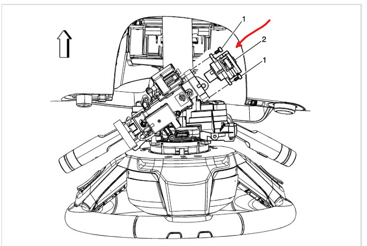

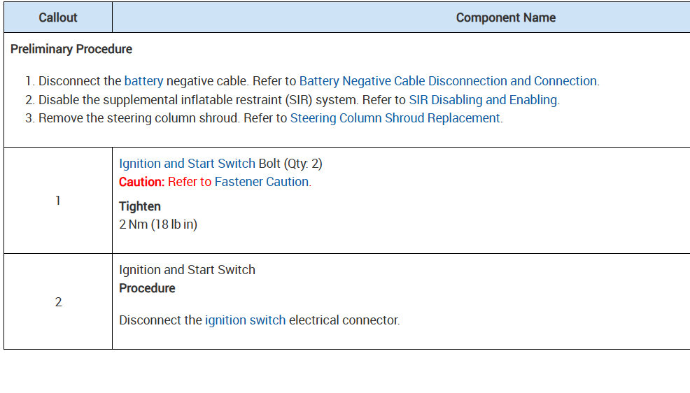

If it is the alternator you can disconnect the main charge wire and isolate it so it doesn't touch anything and then start the car to see if the problem goes away. Here is how to change out the ignition switch which is usually the problem. I will email you the images as well.
