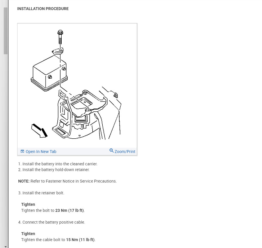

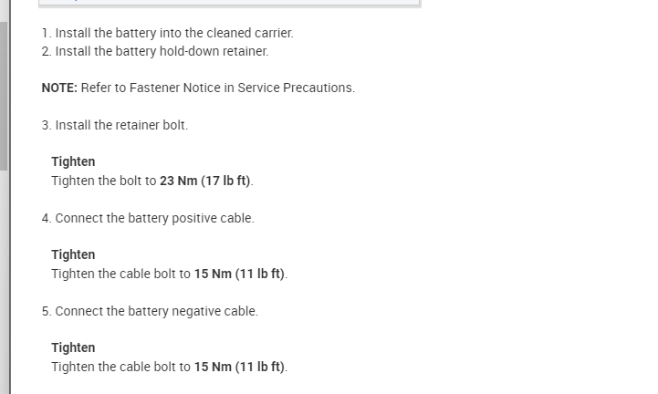

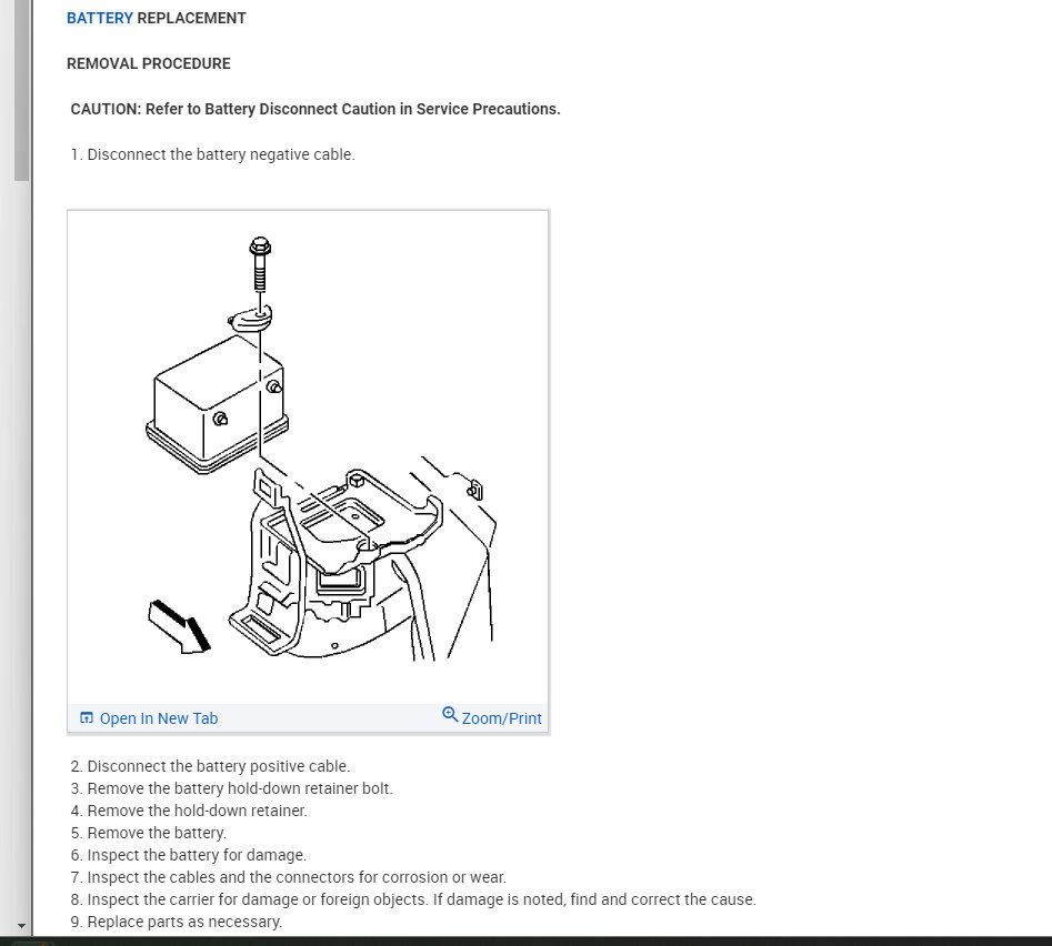

I suspect there will be an issue with the battery, and we will need to replace it so here is the info from the manual that will help with this.
https://www.2carpros.com/articles/how-to-replace-a-car-battery
Please see below for the info from the manual. Let us know what you find, and we can go from there.
