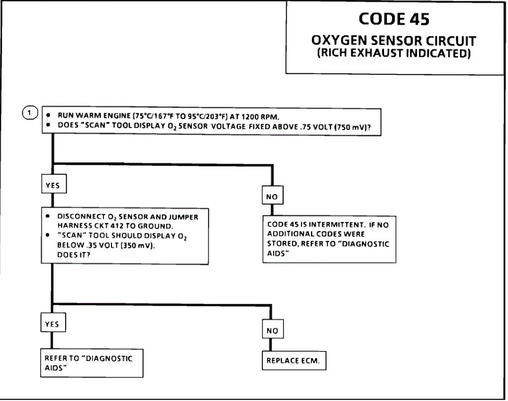

The code you have is related to a rich fuel mixture. I realize that the fuel pump is working, but have you checked fuel pressure to make sure it isn't too high?
I have attached a quick diagnostic flow chart related to the code. Take a look through it and let me know if it helps. Also, let me know if you have checked the catalytic converter to make sure it isn't plugged. A rich mixture could have damaged it.

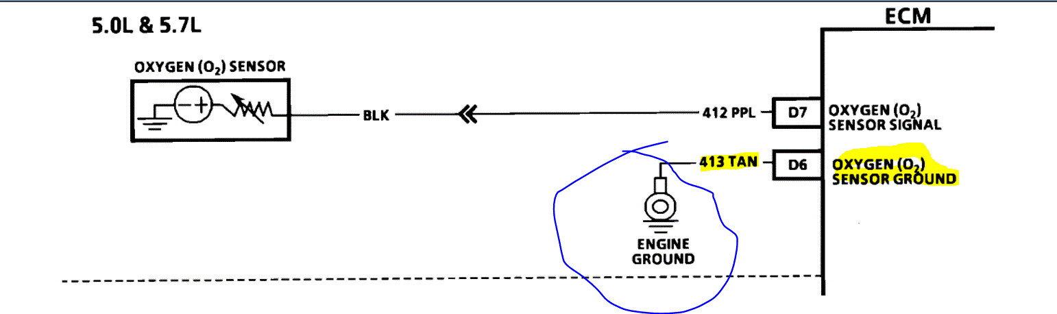

If you look at pic 2, it shows the PCM ground for the O2 sensor. Make sure the ground is in good condition.
