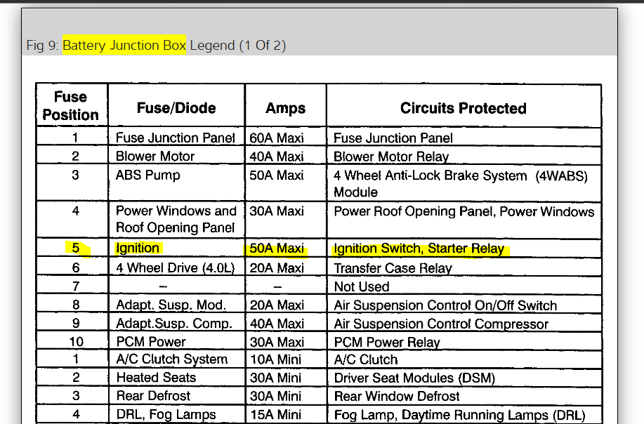

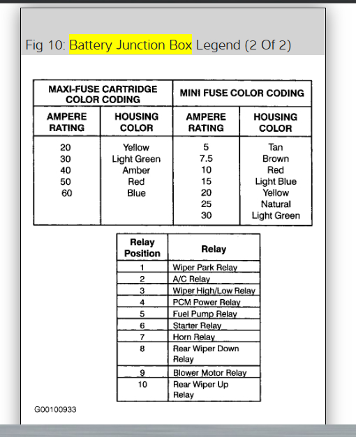

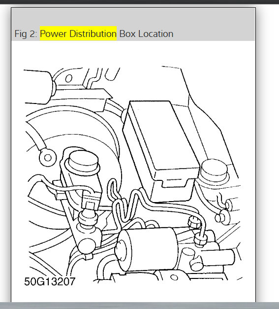

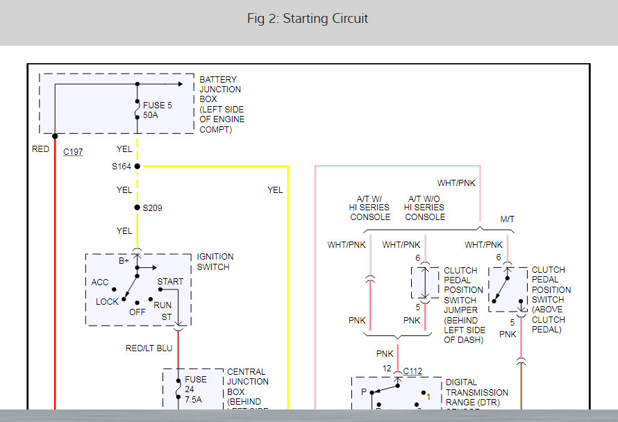

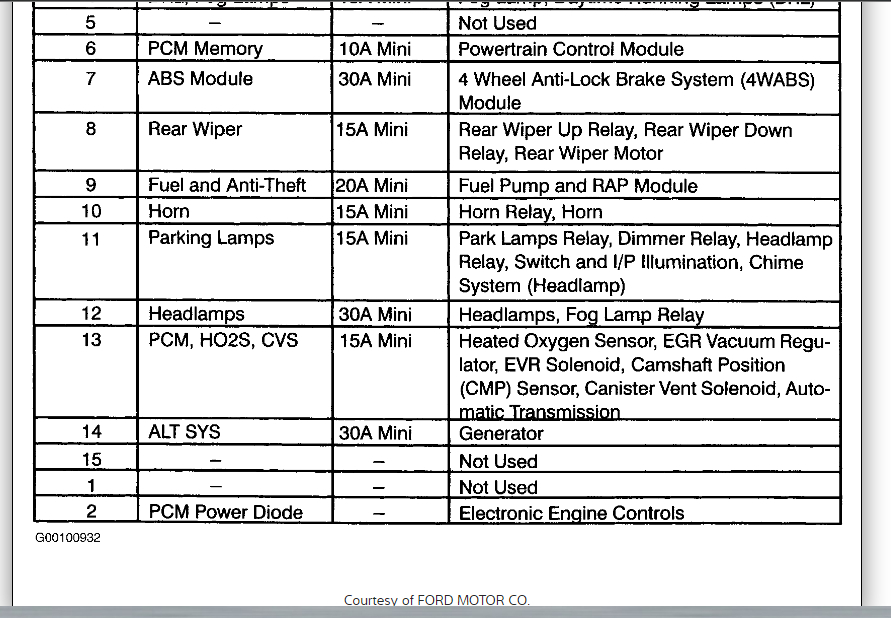

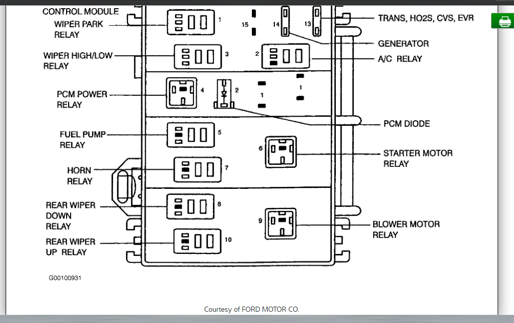

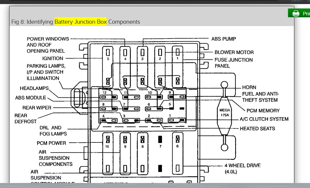

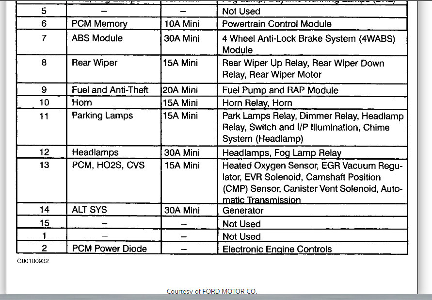

This could be a problem with Maxi Fuse #5(50A) in the Battery Junction Box of your vehicle which is located near the battery. In the diagrams below I have included a wiring diagram of your vehicle's starting circuit as well as a diagram of the location and the Battery Junction Box with callout. I have also included this link below for you on how to properly check and replace a fuse if you are unfamiliar with how to do it:
Please go through these guides, if necessary, and get back to us with what you are able to find out.

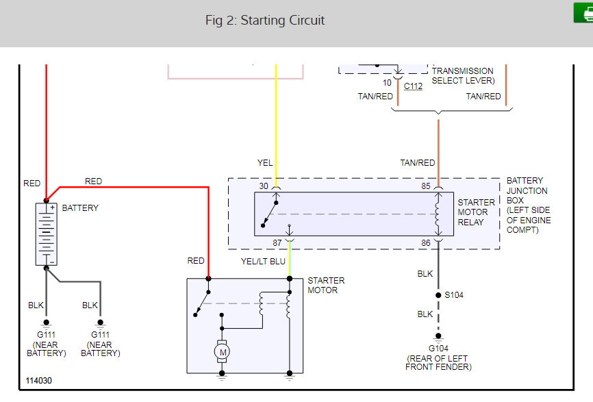

K so i checked all the fuses under the hood and in the cab all are good starter relay tested good all around kt does have a tiny bit of resistance only like .5 i pulled the starter off and bench tested and every thimg engaged fine i have power going through the solenoid next to the battery i broke down and bought a obd 2 today plugged it in and all i got after the scan was ( cant connect to the power train of the vehicle) the fuse is good for the PCU and i have power to everything when the key is in the on poss. I can hear the fuel pump kick on the relays click got dash lights headlights im spinning my head around this i cant figure out what is going on if the ignition switch was bad would i still get power to everything. Also i did try jumping the starter with the battery i got spark of course but nothing else and i read that if i jumped it like that regardless it should start ?

Hello again,
Okay, so when you jumped the positive post on your starter solenoid, did the starter crank the engine?

No i just got spark off the terminals and nothing else...

Hello again,
Okay, then that's your problem. The starter is no good, or more specifically, the bendix gear in the starter has failed. If you did it correctly, there should be no reason, other then a broken or bent flywheel/flex plate that the bendix shouldn't have engaged. Please double check that you put power to the positive post of the starter solenoid and if the starter doesn't engage and crank the engine, then it will need to be replaced.

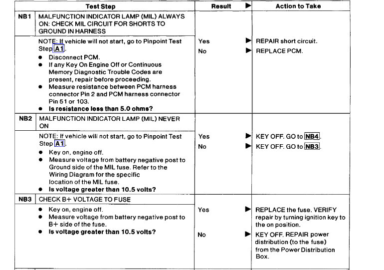

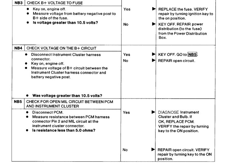

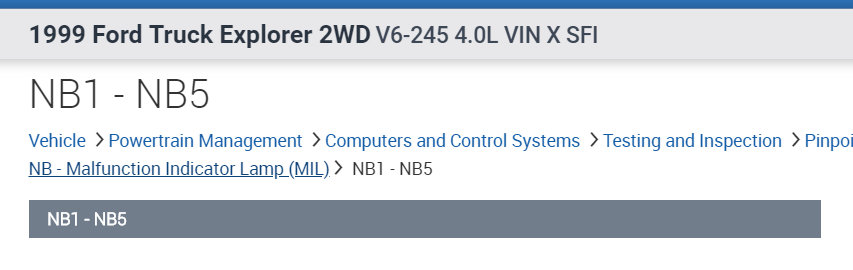

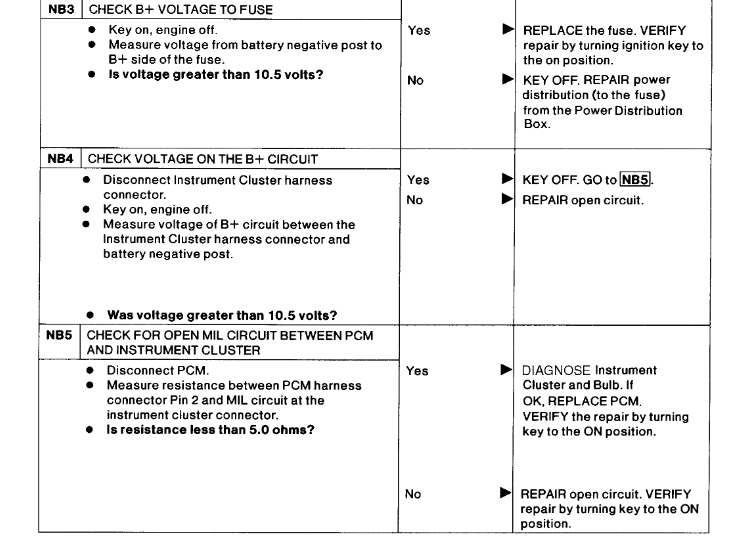

Ok thank you for your advice. If you dont mind me asking one more question i just bought a obd2 today from harbor fright plugged it in ran a scan and came back with not connecting to power train and said no codes are stored in the freeze frame.. i checked the pcm fuses and they are good any ideas why it wont connect or read codes after the scan?
Jul 28, 2019 at 11:43 PM
SCGRANTURISMO
  • 4,897 POSTS
Hello again,
In the diagrams down below I have included the factory diagnostic troubleshooting pinpoint test NB for your vehicle's Malfunction Indicator Lamp(MIL) or "check engine" lamp. Please go through the guide and get back to us with what you are able to find out.

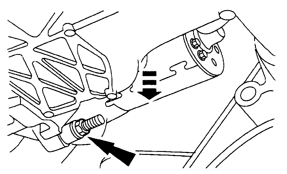

At this point it's not starting. What is happening? Does the starter grind when you try? Does it do nothing? Does it spin but not turn the engine?
Since you have been having issues, I'm starting to question the flywheel itself. It may be damaged or even cracked.
Here is a link that shows in general how to replace the starter. Take a look and see if there is anything that you may have missed.

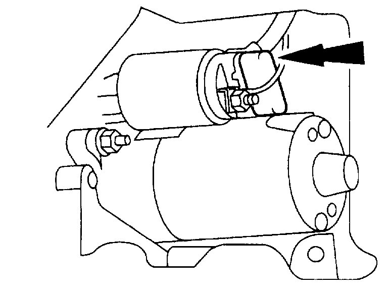

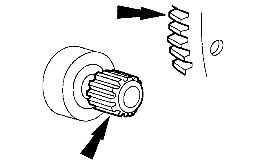

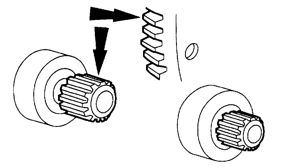

Next, here are directions that show how to check the starter and flywheel. Pictures 1 and 2 correlate with these directions,
STARTER DRIVE/FLYWHEEL RING GEAR INSPECTION
1. Remove the starter motor.
pic 1
2. Check the wear patterns on the starter drive gear and the flywheel ring gear. If the wear pattern is normal, install the starter motor.
pic 2
3. If the starter drive gear and the flywheel ring gear are not fully meshing and both of the gears are scored or damaged, replace the starter motor. If necessary, replace the flywheel.

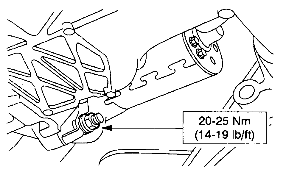

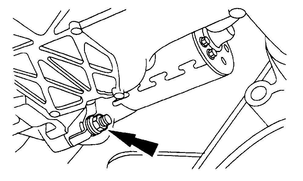

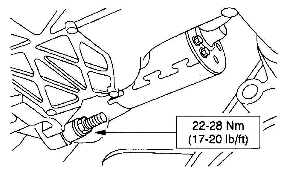

Here are the manufacturer's directions specific to this vehicle. Take a look through them also. The remaining pics correlate with the directions.
REMOVAL
WARNING: WHEN PERFORMING MAINTENANCE ON THE STARTING SYSTEM BE AWARE THAT HEAVY GAUGE LEADS ARE CONNECTED DIRECTLY TO THE BATTERY. MAKE SURE PROTECTIVE CAPS ARE IN PLACE WHEN MAINTENANCE IS COMPLETED.
1. Disconnect the battery ground cable.
2. Raise and support the vehicle.

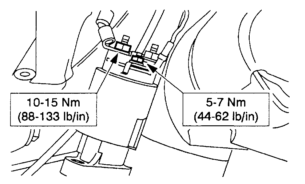

pic 3
3. Remove the starter motor solenoid terminal cover.
pic 4
4. Disconnect the starter wires.
1. Remove the nuts.
2. Disconnect the wires.

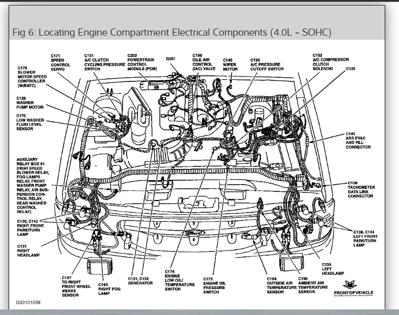

pic 5

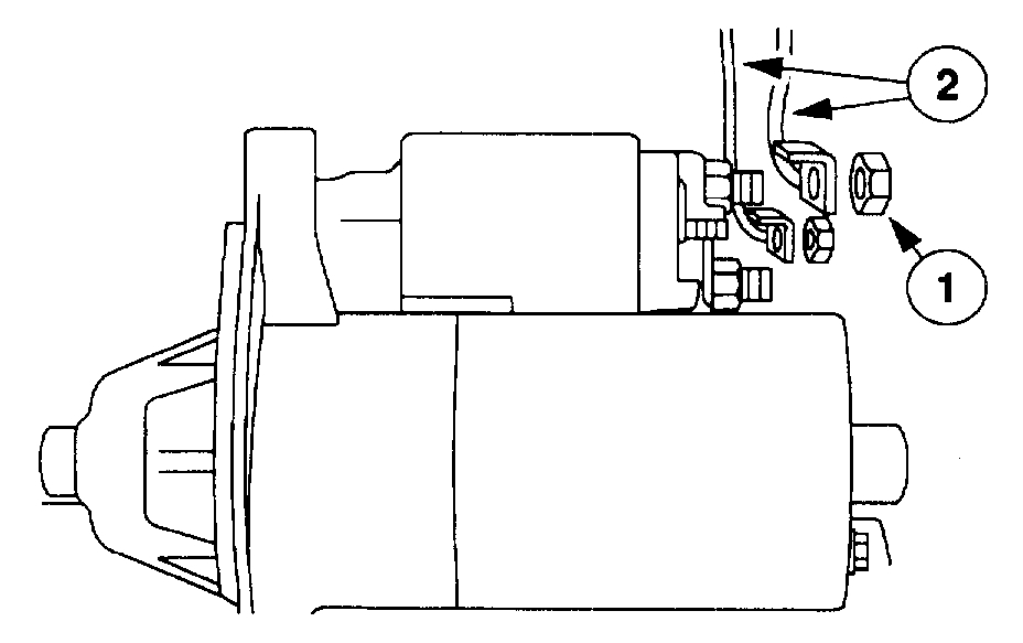

5. Remove the nut and the starter ground cable.
pic 6
6. Remove the bolt and the starter motor.
INSTALLATION
pic 7
pic 8
pic 9
1. Follow the removal procedure in reverse order.
NOTE: When the battery is disconnected and reconnected, some abnormal drive symptoms may occur while the vehicle relearns its adaptive strategy. The vehicle may need to be driven 16 km (10 miles) or more to relearn the strategy.
