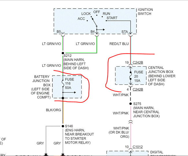

Engine will not crank but if I jump the starter solenoid it will run. I replaced the ignition switch but it still will not crank. When I probe the cabin fuse block there is no power at fuse 5 (ignition run power feed) , fuse 6 (brake shift interlock,ECM) and fuse 20 (starter motor relay).
I have checked fuses 101, 105 and 116 in the engine bay fuse block and all are okay. Any help to fix my problem would be greatly appreciated.
