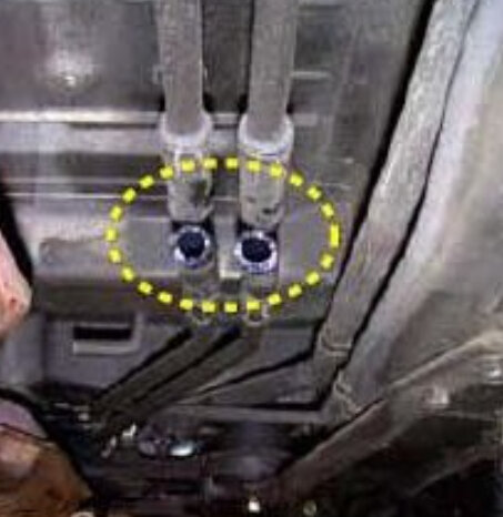

Can you see if it is coming from toward the top of the engine or does it seem to be lower? Also, do you have a rear auxiliary heater?
There are a couple of heater pipes for the rear heater that corrode and can leak. You will need to be under the vehicle to see if that is the issue. Also, there are two heater hoses to the front heater core that attach at the firewall. One of the hoses could be leaking. See pic below.

See pic below.
