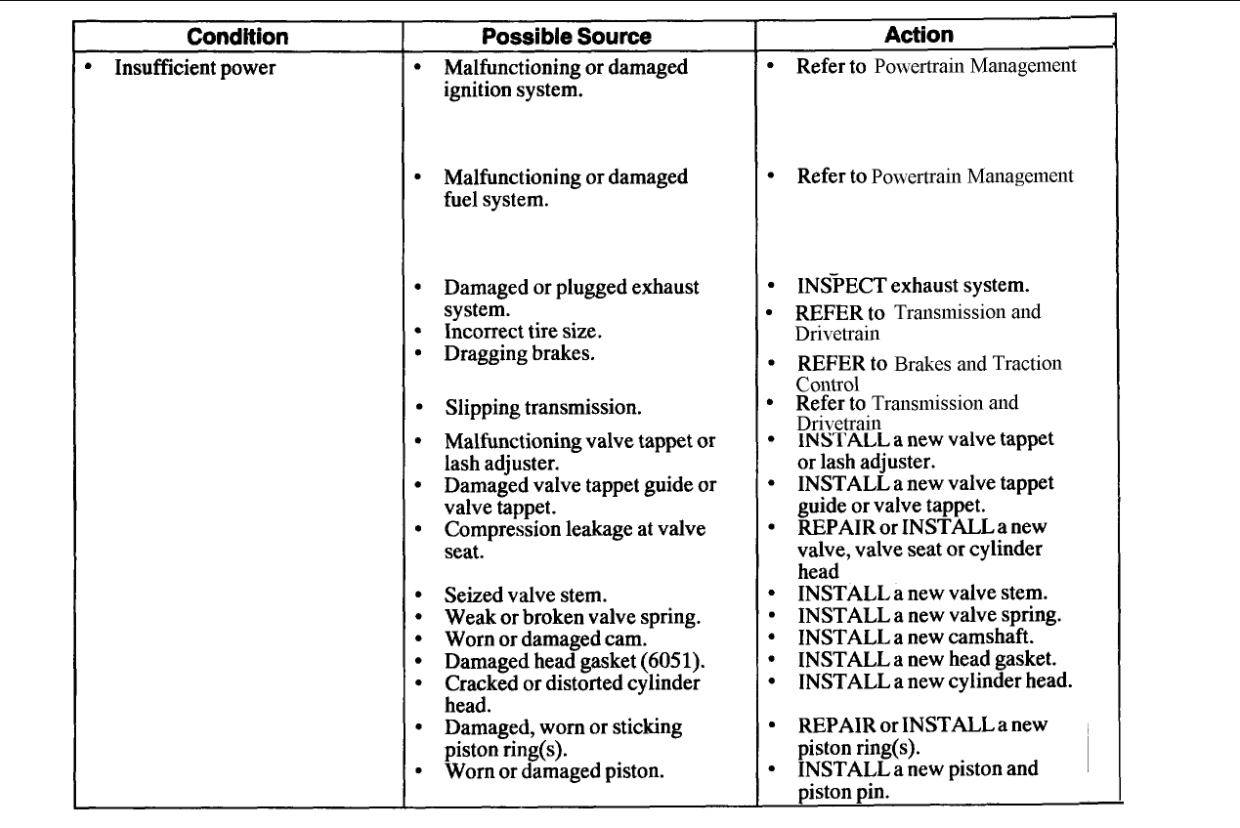

This could be a number of things. so in the diagrams down below I have included a list of systems and/or components to check from the vehicle manufacturer for poor engine performance. Please go through this guide and get back to us with what you find out.
Thanks,
Alex
