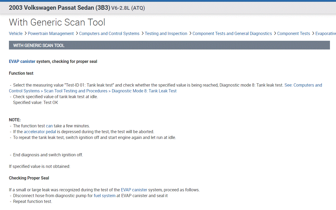

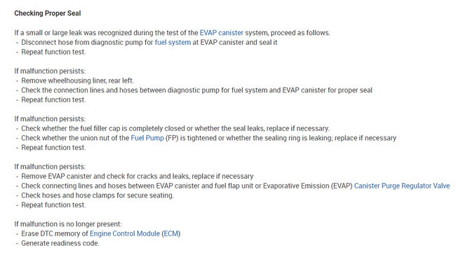

Also, if you have a scan tool, you can follow the directions below to see if there is a leak.
Here is what I suggest. First, confirm the fuel cap is tight. Also, remove it and confirm there is no corrosion or rust when the seal seats. You can have the cap tested as well.
If it is good, I would recommend smoke testing it. That will likely require you to take it to someone simply because no one owns one other than a shop.
Let me know if any of this helps or if you have other questions.
See pics below.
