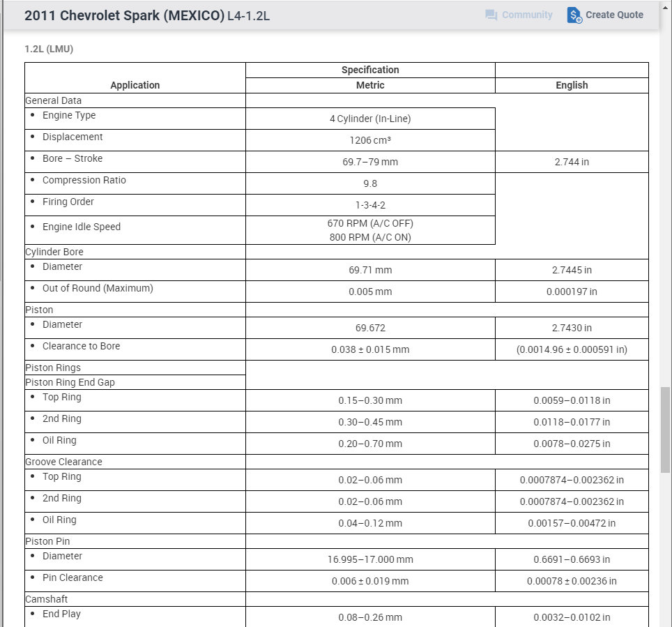

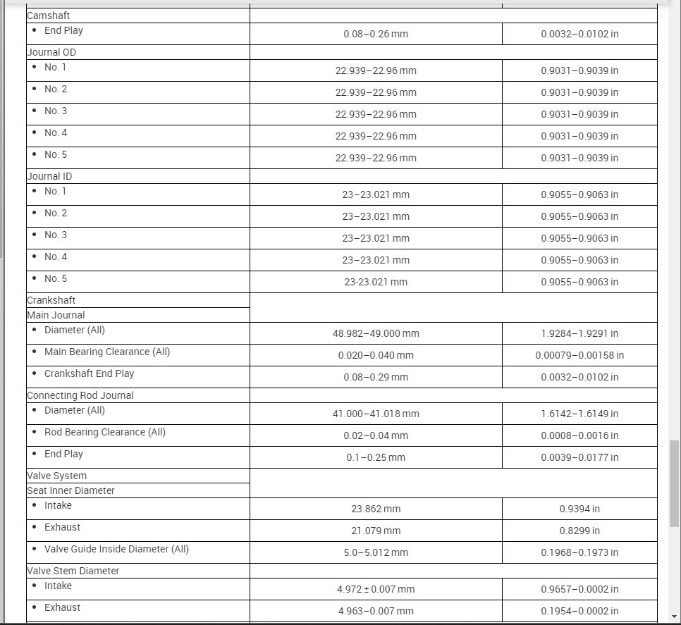

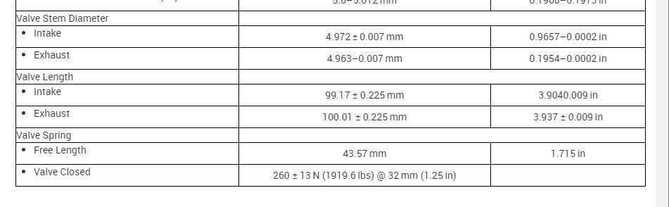

I am going to include all the overhaul engine specs for endplay and clearances which is what I suspect you need.

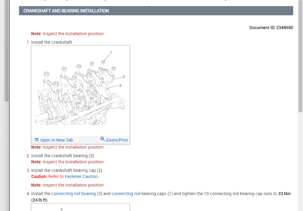

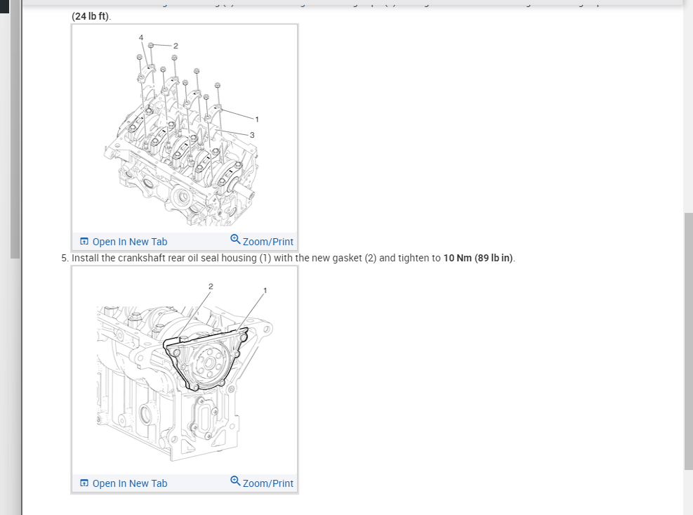

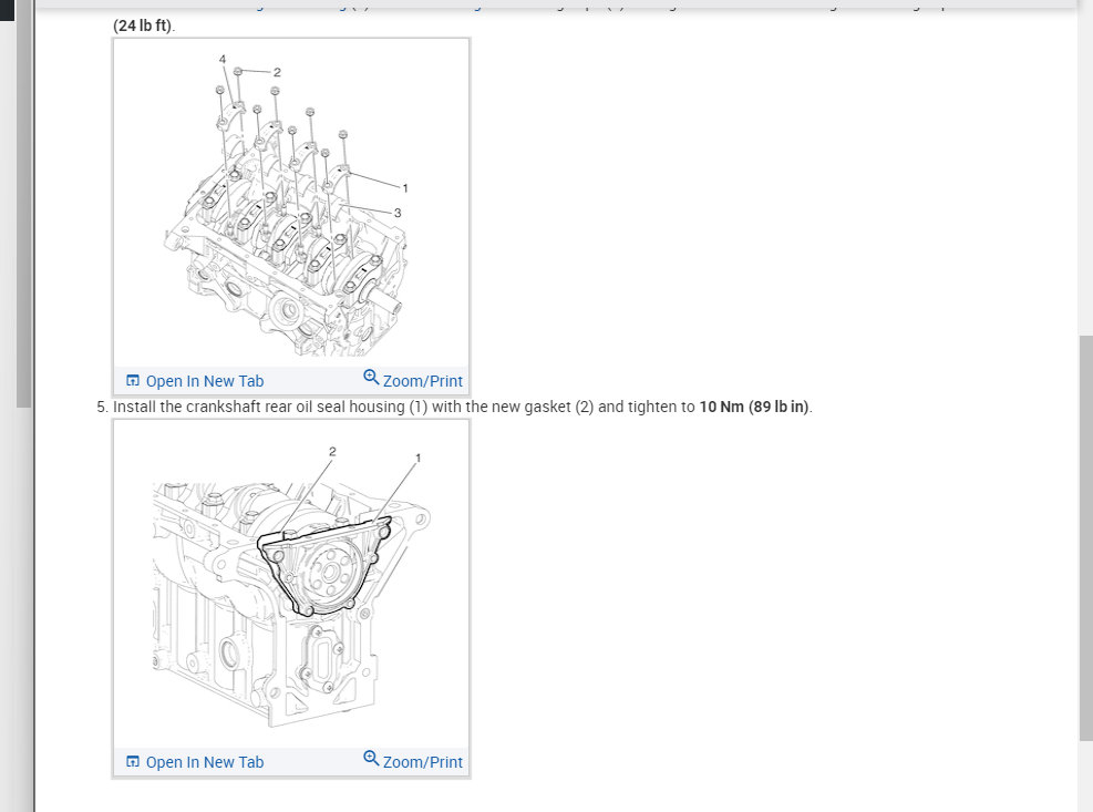

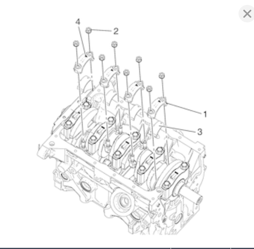

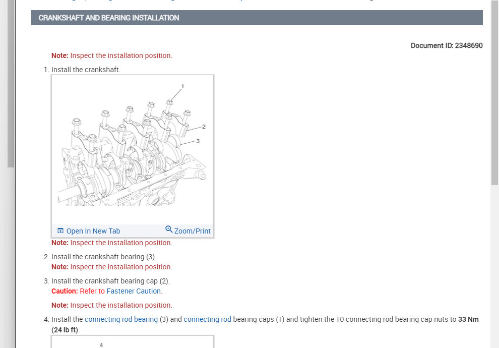

I am also including the process below for installing the crank bearings so please run through this information and let me know what other systems you may need torque specs for, and I am happy to provide them.
I could include the entire rebuild process but that would be at least 100 pages of material to attach so it would be better to just attach what you need.
