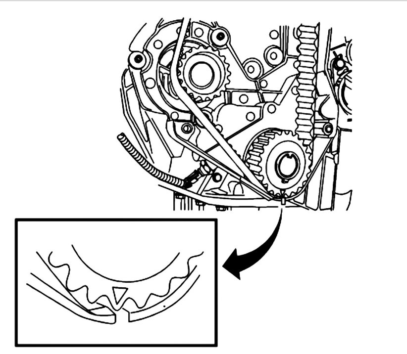

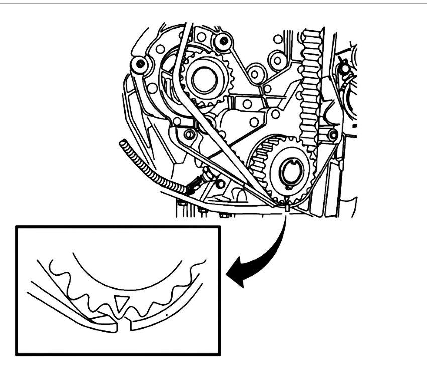

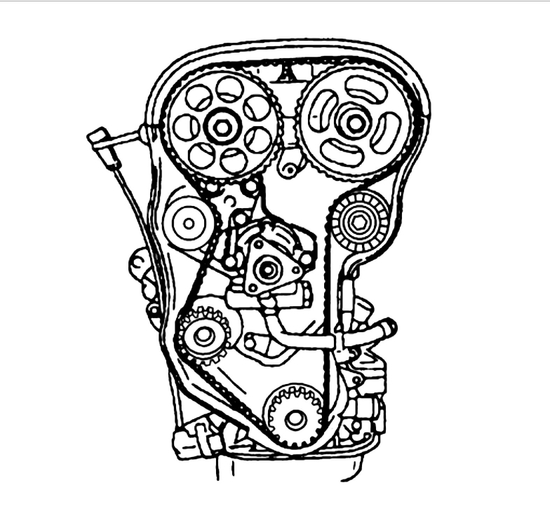

I need to know how to time the crank shaft. is the crank gear mark facing down on the block or up on the water pump case?
Sep 23, 2019 at 8:34 AM

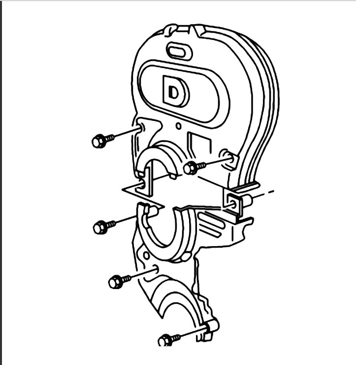

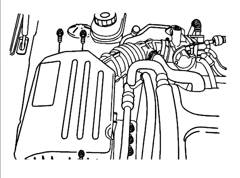

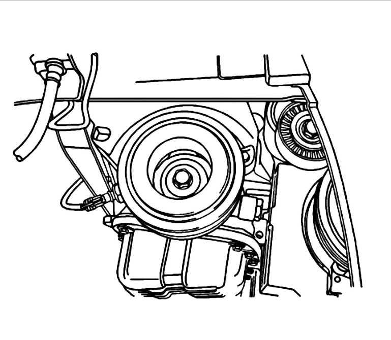

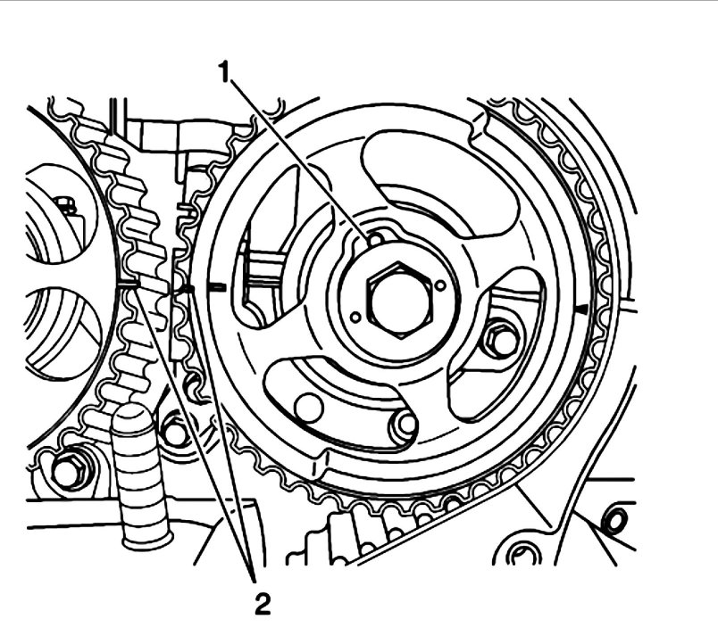

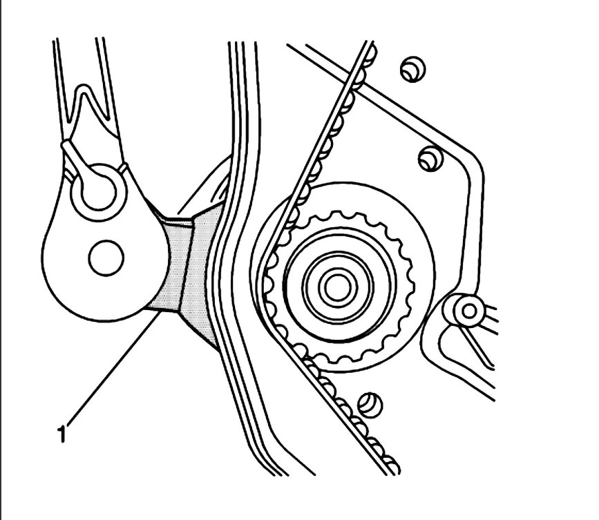

Here are the timing procedure for the crankshaft and camshaft for you car. Check out the diagrams (below). Please let us know if you need anything else to get the problem fixed. Can you please shoot a quick video with your phone so we can see what's going on, that would be great. You can upload it here with your response.
