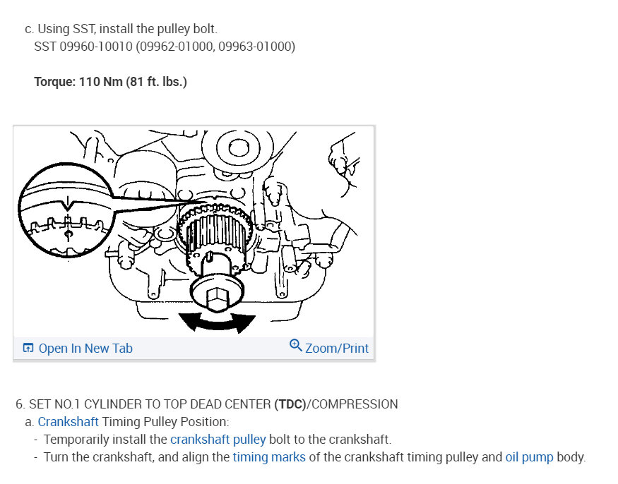

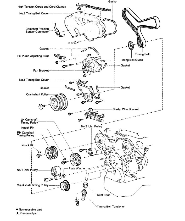

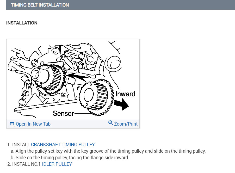

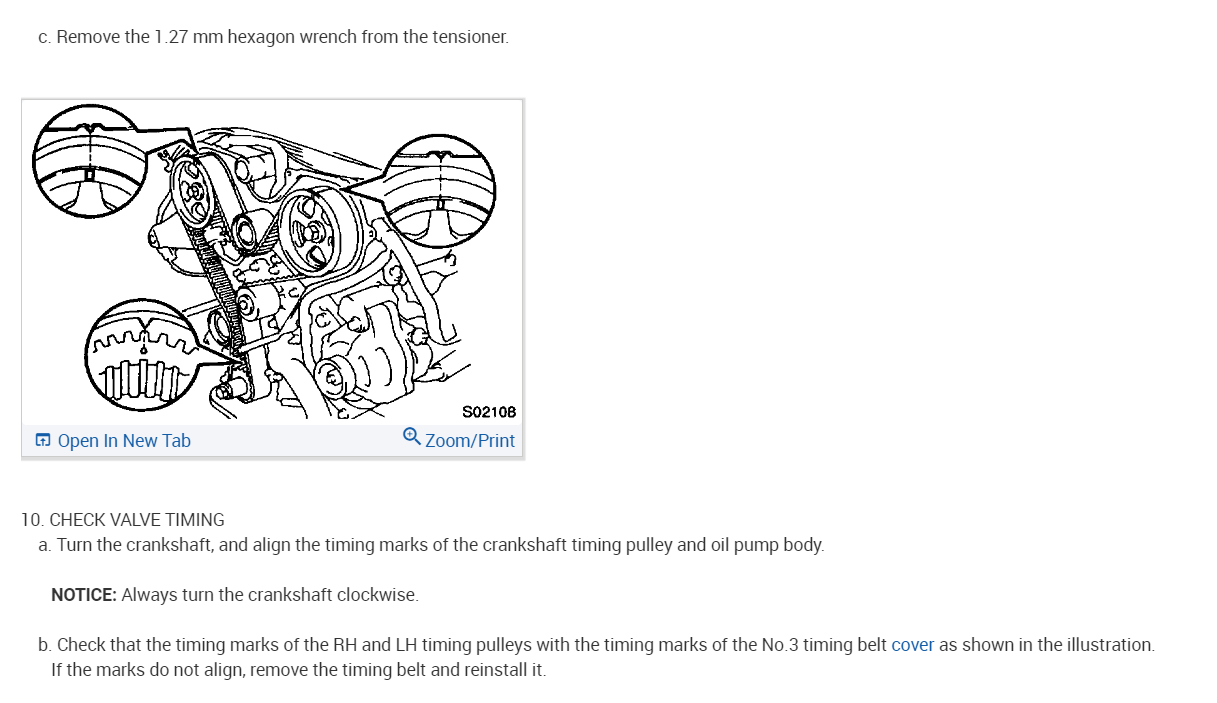

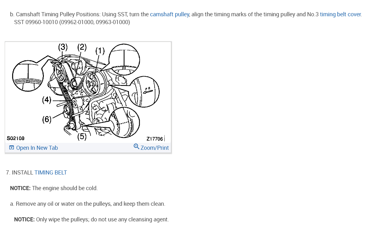

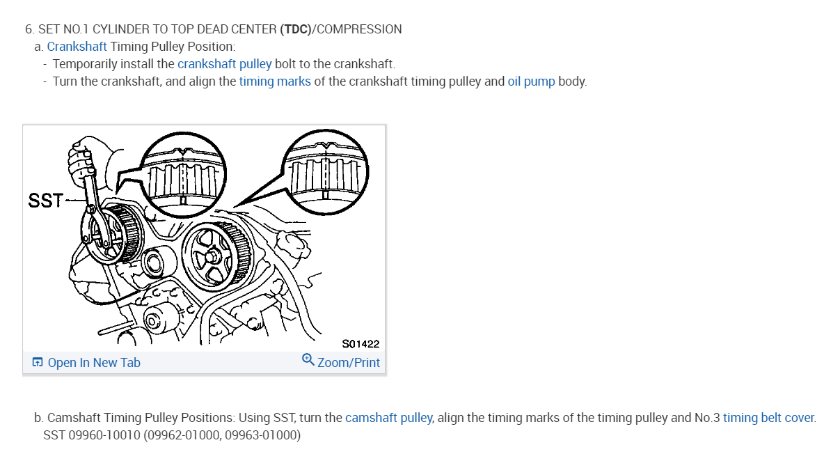

I have the vehicle listed above Prerunner with a 5vz-fe engine and my timing belt shredded apart, so the truck got towed home. Anyhow the service manual along with videos I've watched all show the camshaft pulleys at 12 o'clock being the position they should be at to successfully get the timing right. I've set the camshafts at that spot and many more positions with no luck. So basically, I'm looking for an alternative way that i can possibly find the correct location for the camshafts to be positioned?
