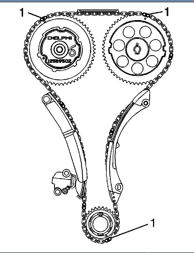

Hey, I was just wondering how I find top dead center on this motor 4.2 6L. I put a rag in the first cylinder cranked motor by hand no pop or do I just keep cranking it? I'm so confused, I haven't touched or pulled the timing gears off or chain. I see they had there is a punch and l mark but just confused wanted to pull chain out and gears. How do I know if I'm at top dead center without knowing I'm on compression stroke?

Short of all this, you will need to access the crank pulley to line up the dot which is not the easiest.
