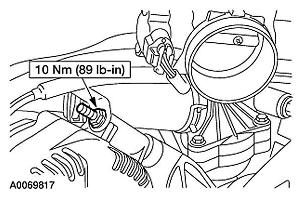

3. Remove the generator wiring harness bracket nut and position the wiring harness aside.
pic 1

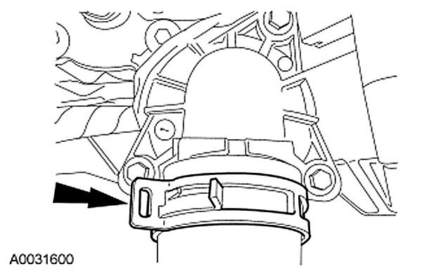

4. Disconnect the upper radiator hose.
pic 2

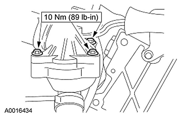

5. Remove the bolts, water outlet adapter, and thermostat.
- Inspect the O-ring seal, install a new O-ring seal if necessary.
pic 3

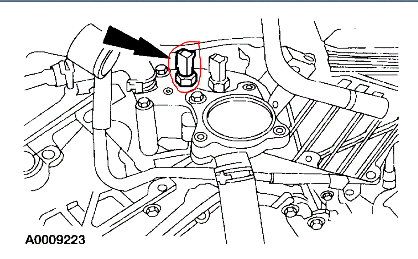

There are two coolant temperature sensors on this engine. One is for the gauge and the other is for the computer. I attached a pic. Let me know if that is the one you replaced.
May 2, 2020 at 9:50 PM
Hi Joe! Looking at the engine from the front of the car I replaced the sensor further to the right on the drivers side. If that picture is the same orientation I would say I replaced the one not highlighted, I believe it was the one to the gauge but I could be wrong.
May 3, 2020 at 7:01 AM
The pic is from the front. I believe you replaced the wrong sensor. Do you still have the one you removed? I would switch it with the new on on the truck and then put the new one in the place indicated above.
