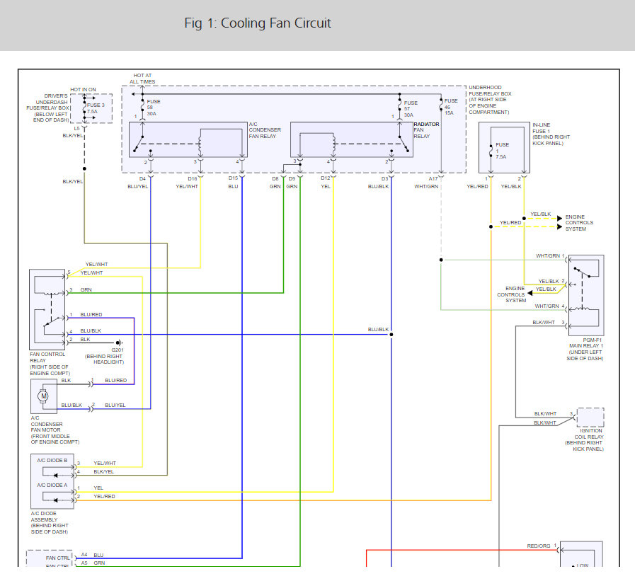

It sounds like the radiator cooling fan is not working. Can you turn the car on with the AC to see if you hear it running, if not lets check it for power and ground and replace the motor which burn out commonly. Here are guides to help you see how to test for power and how to change the fan motor with the fan wiring diagrams so you can see how it works:
