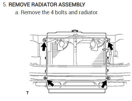

Here is how to change the radiator out. Check out the images (below). Please upload pictures or videos in your response of any problems.
