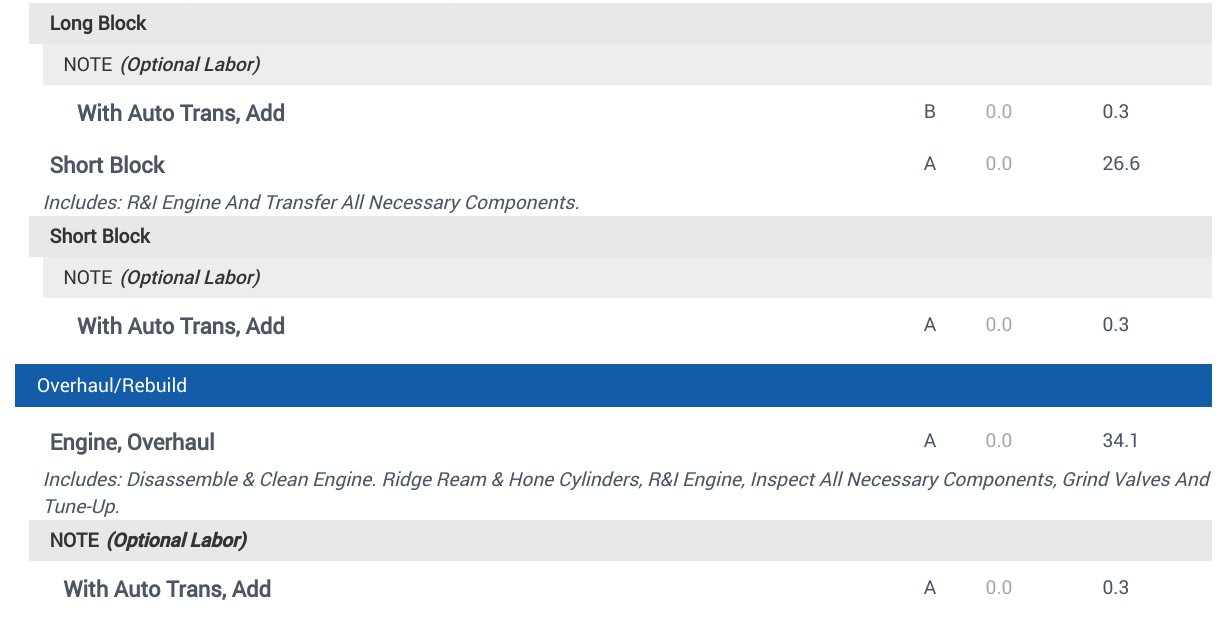

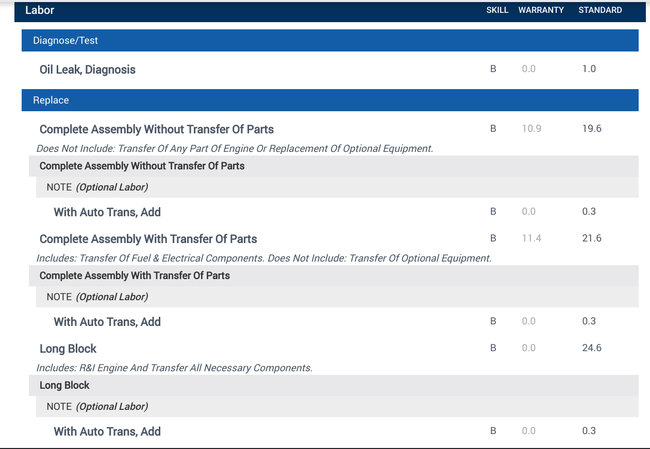

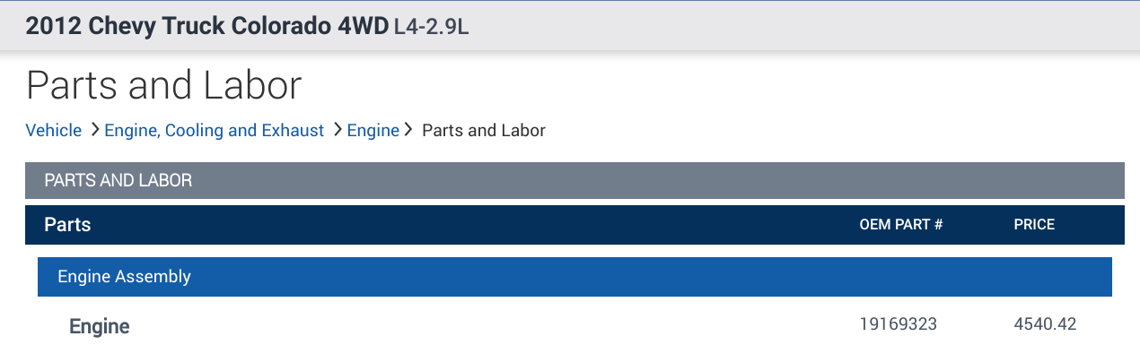

I have included the information that you requested in the diagrams down below. To get the labor costs multiply the hours by the average shop labor rate where you live. I hope that this helps.
