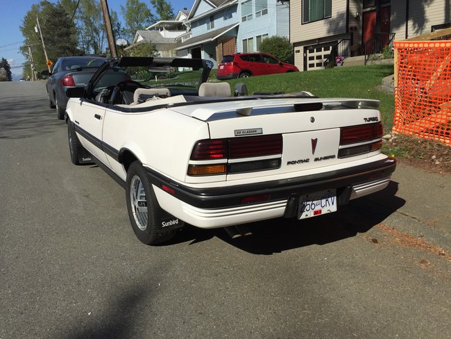

RICH BRAUN
  • 4 POSTS
i have a 1990 Sunbird convertible with a motor plagued with problems. It has a 2L turbo. The car I found on Craig's list is a 1993 2L. Both are overhead cams. By what you are saying it sounds like I am biting off more than I can chew! Maybe I should keep looking.
