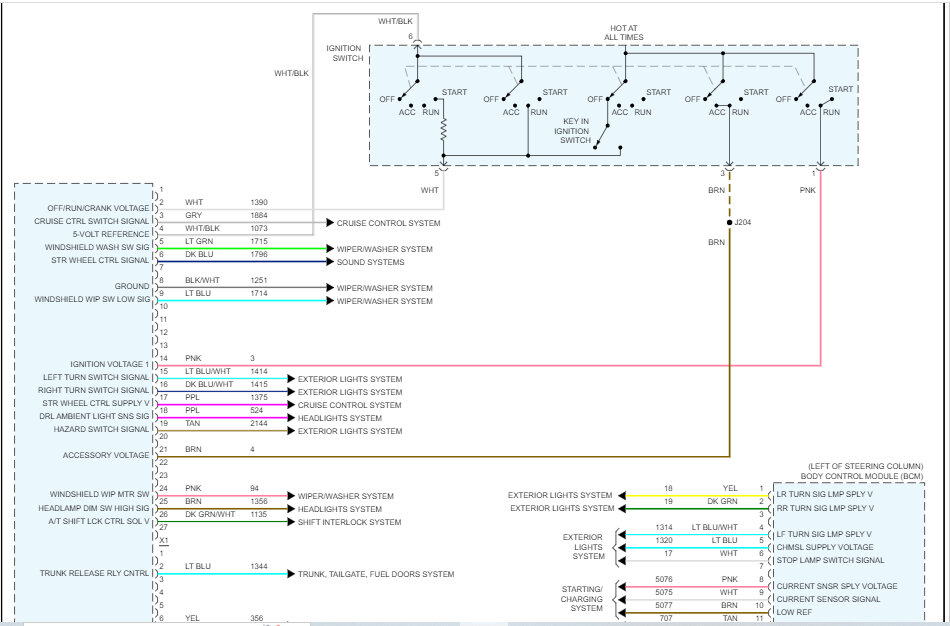

wiring diagram for the under hood driver side strut tower located wires that lead to the column and body control box two plugs one 14 wires one 12 wires and a pin out for the ABS box needed?

The car started as a factory 3.9 flex fuel. I found a same year SS which transplanted just fine the problem is the harness and fuse box etc., are completely different. Still shouldn’t have been too serious. Upon returning home on day an undisclosed family member decided to help with the wiring which I had left piled in a corner of the bedroom. I’ve searched the local library, and the dealership won’t acknowledge what I’m requesting and online as it seems the is a shortage of repair manuals or the ones, I could find were not detailed enough for what I’ve described and online searches. I need a wiring diagram for the car listed above LTZ model, under hood driver side strut tower located wires that lead to the column and body control box two plugs one 14 wires one 12 wires and a pin out for the ABS box.

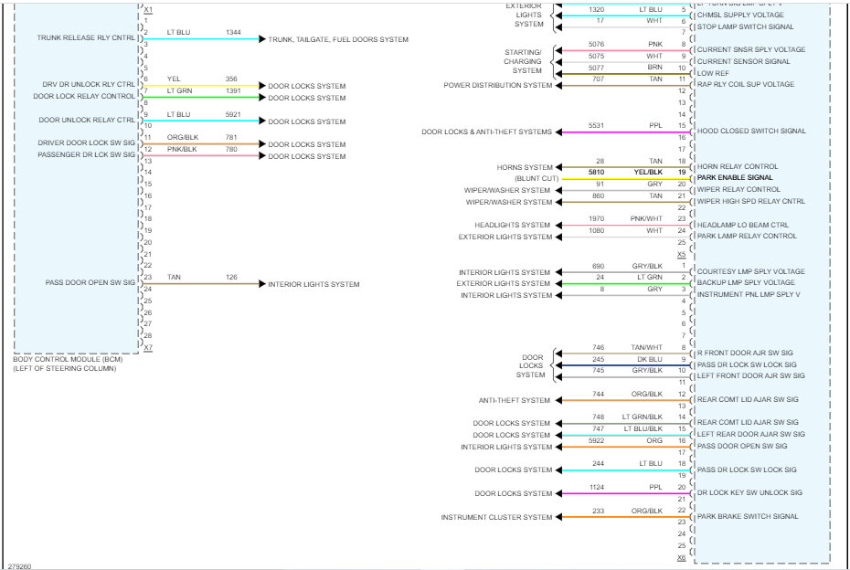

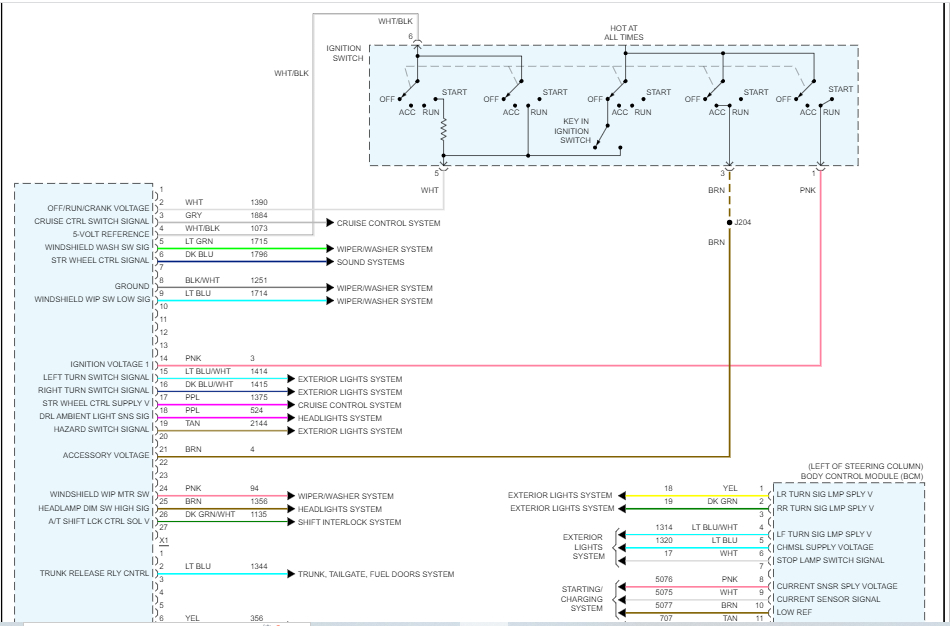

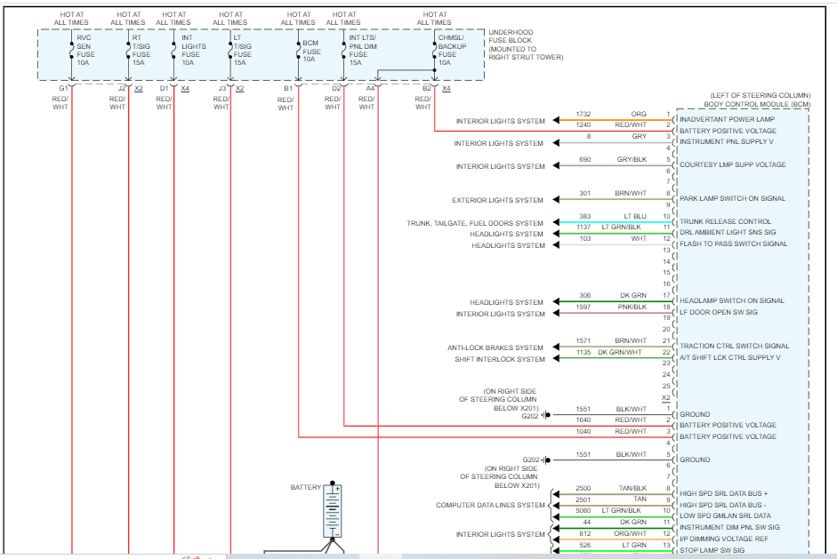

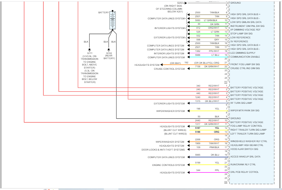

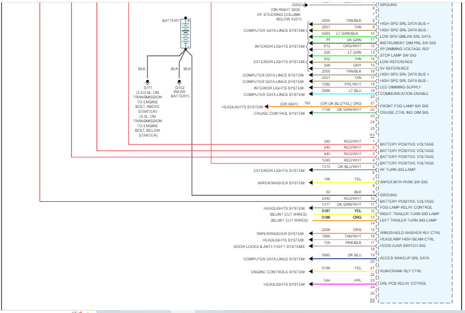

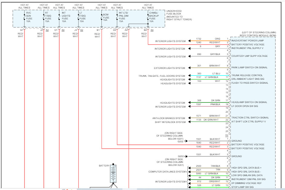

I believe the wiring in that area is all related to the body control module. So, I attached the entire schematic below related to the BCM.
Take a look through them and let me know if they help. If there is something additional, let me know.
See pics below. Note: The schematic was two pages. I had to cut each in half to make them readable. I did overlap them so you can follow from one to the next.
