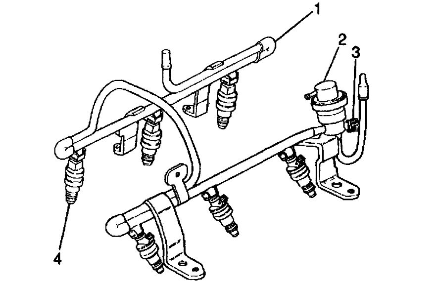

1. Fuel pressure. you can check the actual pressure at the valve right by the power steering pump. Check the pressure key on, engine off and while cranking. It is number 3 in the picture below.
