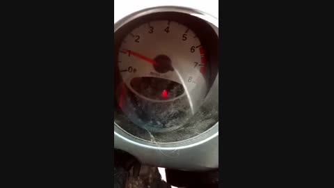

Below is a video of the revving it does at 2,000 RPMs.
Apr 26, 2022 at 10:22 AM
BARON11212
  • 6 POSTS
That's with the car in neutral.
Apr 26, 2022 at 10:23 AM
Got it. Thanks for supplying the video as that is what I suspect this was with this additional info. That is called a rev limiter and is 100% normal.
That is protecting the engine from over revving when there is no load on it.
Basically, the PCM is seeing that the vehicle is not in gear and watches the throttle input for when you are holding it down. The PCM then cuts fuel input to keep the engine from over revving and this creates the surging that you are seeing.
So, if you have no issue when this vehicle is in gear, and you are accelerating then this is programmed into the PCM and will not be corrected as it is by design.
Does that make sense?
Apr 26, 2022 at 11:27 AM
