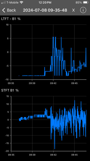

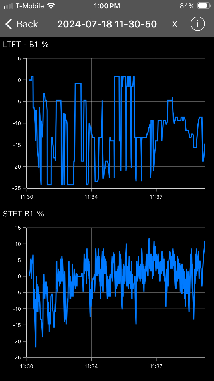

I don't know if the feed is still active, but I had virtually all of the gaskets replaced on the Imp and had a new direct-fit cat converter installed last month. Update: The sulfur smell is gone, but I seemed to have retained the surge. I am noticing it may be even more noticeable now on short runs. I also have seemed to narrow down that it is happening after the car downshifts into first gear. When it does, the engine acts almost as if extra air got into the engine right after the downshift. I broke down and bought a Bluetooth OBD2 and recorded fuel trims from 2 short runs. I will upload them here so you can see if something is awry there. I know you thought last time we talked that something may be going on in the fuel trims.
Jul 8, 2024 at 10:28 AM
In a perfect world, the STFT would be 0%. However, we accept trims that are between +10% and -10%. The trims are well beyond the -10%. That tells me the engine is getting too much fuel, and the PCM is trying to compensate for it by closing the injectors faster. An air inlet restriction would cause this to happen as well. For example, a plugged air filter.

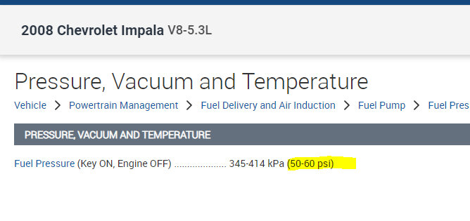

If I had the vehicle in my shop, the first things I would be checking are fuel pressure and then a pressure drop off to see if there is an injector leaking.
If there was a vacuum leak, the trims would be high on the + end of the scale.
The link above explains how to test fuel pressure. You will need a fuel pressure gauge. If you don't have one, most parts stores will lend one to you.
I attached the fuel pressure specifications below. Try this and let me know what you find.
Also, before starting the engine, check the signal from the coolant temperature sensor. It should indicate a temperature close to ambient temperatures.
See pic below.

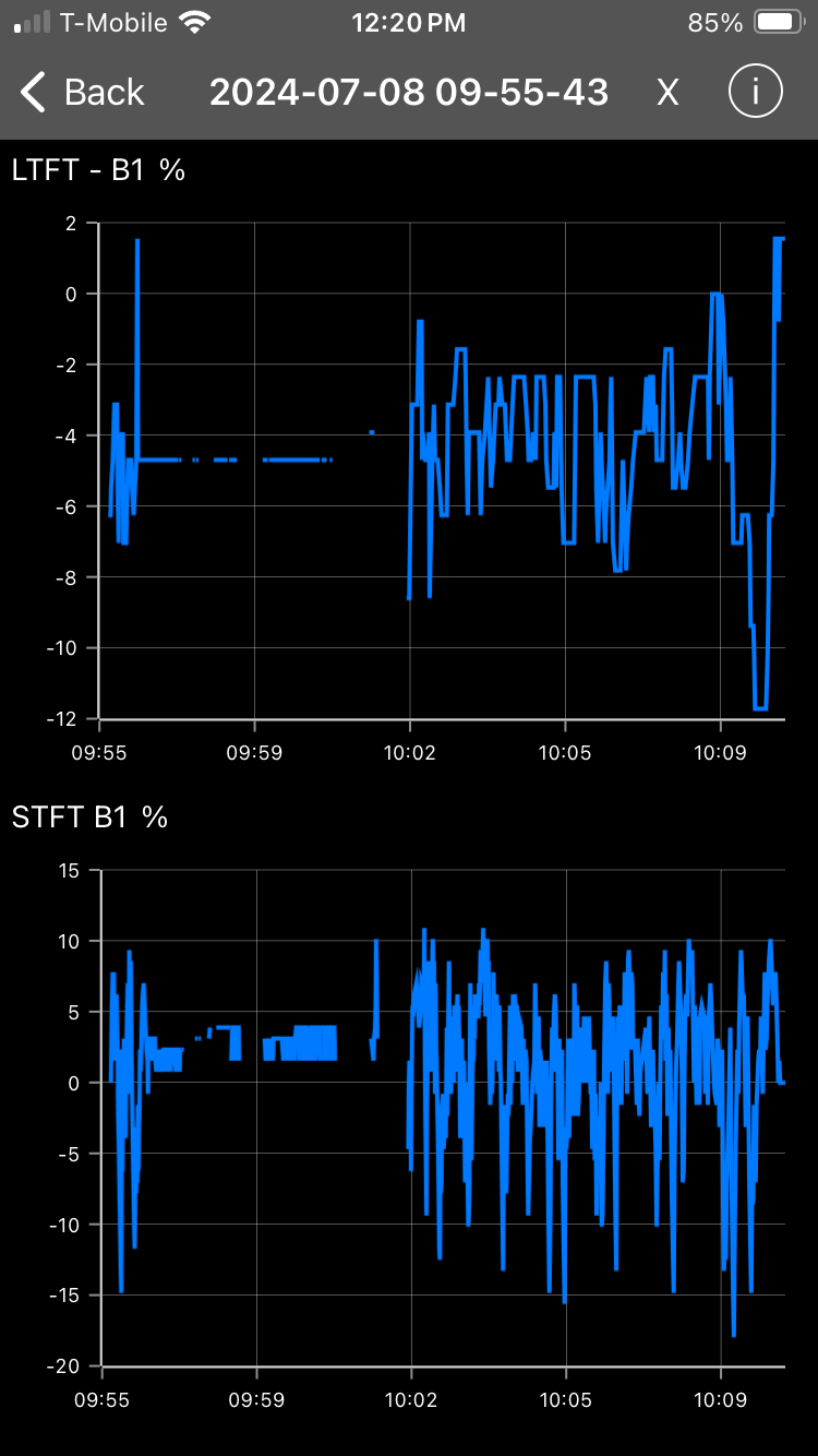

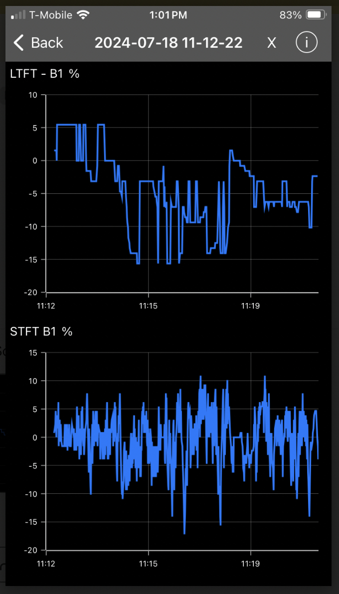

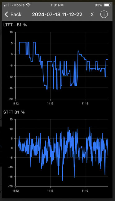

Okay thanks. I also logged data on 2 more short runs pictured below. Is there a reason the long-term trim would be lower than the short term? They way I understood it, ltft was collected like every few seconds from stft data? As pictured in the first image, the ltft was closer to -25 than the stft.
Jul 18, 2024 at 11:07 AM
The LTFT's are an average of the STFT's. What you are seeing makes sense. However, we are still getting too much fuel. Were you able to have the pressure tested and a leak down test?

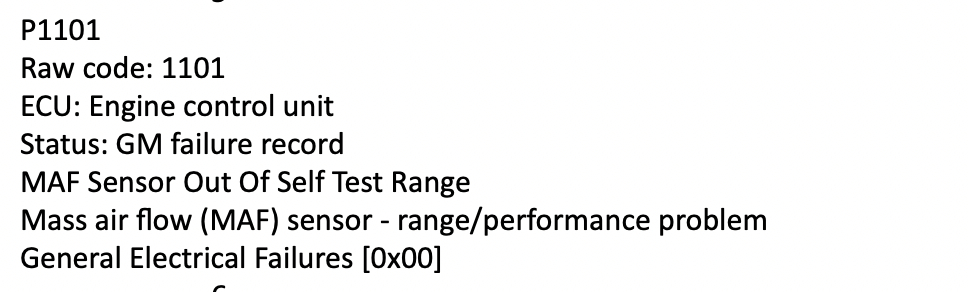

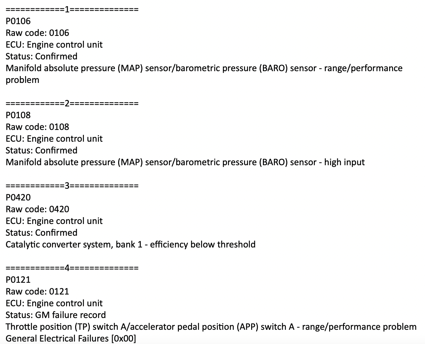

The place I took it to drive it for a test and found the fuel trims I found. They said they traced it to a bad MAP sensor and replaced that. They said the car was running better after. I don't know if they actually did a manual fuel test now. I just drove the car today for 2 short stints and the trims are back in the negative. On top of this, the car is now throwing more codes, many of which are related to the MAP sensor. I will share those here.
Jul 26, 2024 at 10:22 AM

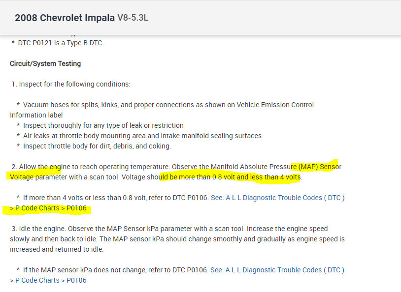

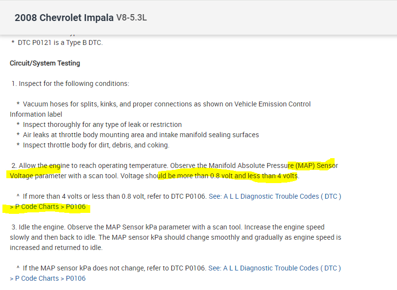

We need to recheck the MAP sensor voltages. If they are too high or low, it will cause a few of these codes to set. If the sensor is good, then we likely have a wiring or connector issue. However, even a new sensor can be faulty.
Take a look at the test below. This is where I would recommend starting. This test is based on the P0121 code.
See pics below.
