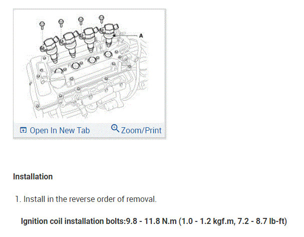

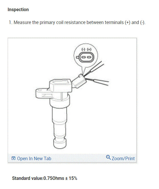

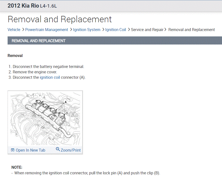

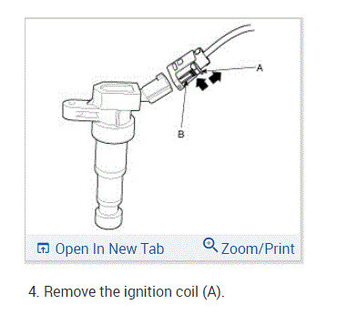

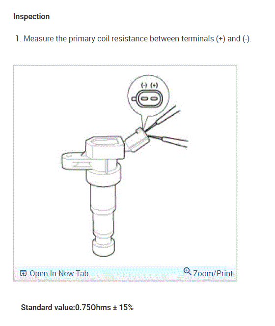

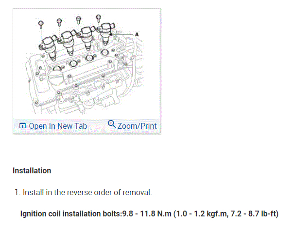

Wow, that ties right together. The idea that you see the wiring at the coils shorting, it does sound like you have the same problem. I'm not sure if you need them, but I attached the directions for replacing the coils below.
If you have a chance, let me know if this takes care of the issue. I suspect it is going to become a common problem and it will benefit others.
Also, thanks riff2015 for letting us know.
See pics below.
